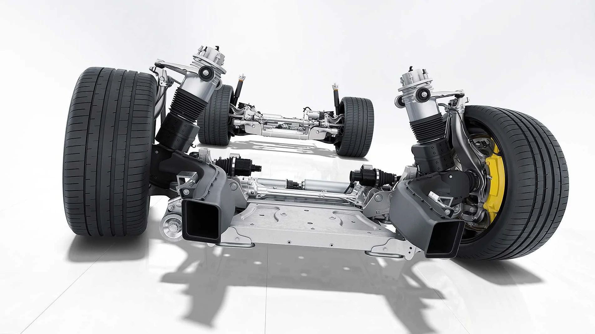

That said the Taycan DOES have brake ducts to cool the rotors (as do all Porsches) on both the front and rear axels.
This image should give you a better idea of where they are actually located. As f1engsaid they are not the "visible" ducts in the front bumper or fender. If you zoom in/look closely you can even see the small ducts for the rear rotors.
