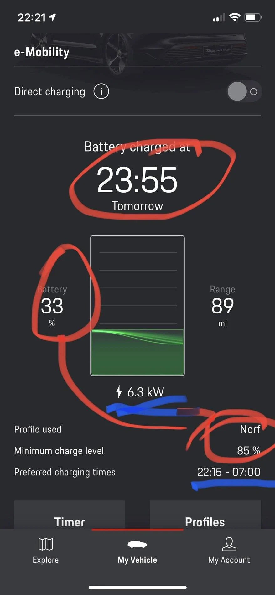

There is clearly an issue here.
The car correctly calculates that
-to go from 33 to 85% charge
-at 6.3kw,
-stopping at 0700 and
-starting again at 22.15
the battery will be charged at 23.55 tomorrow.
The issue is the charge won’t stop at 0700 as it should.
Nor did it wait until 22.15 to start.
Porsche Taycan Will my car charge tonight? 7D2CF653-836F-4E44-A43E-E1685BF16AA5
11,016
6,805

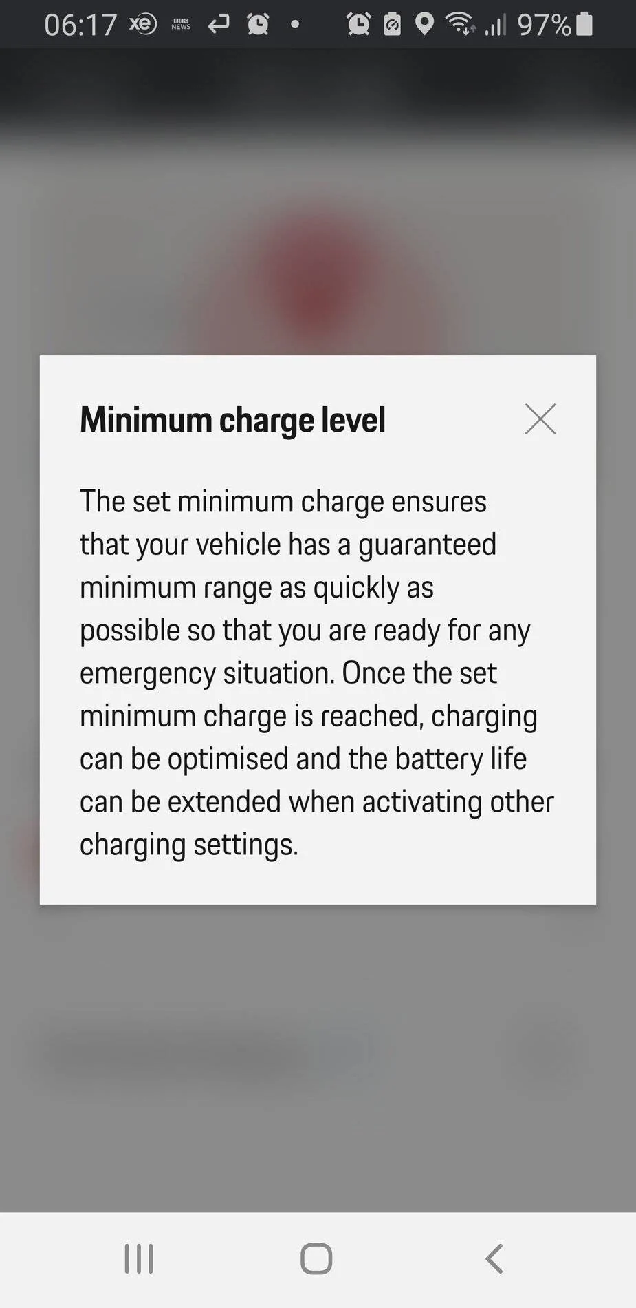

SOC is 33% at start
Profile has minimum set to 85%
Logically charging starts immediately until the target is reached
To control the end time you must add a departure timer of 07:00.
I have adopted this approach since day 1 as this is how I interpreted the instructions.
Porsche Taycan Will my car charge tonight? Screenshot_20210820-061707_Connect
