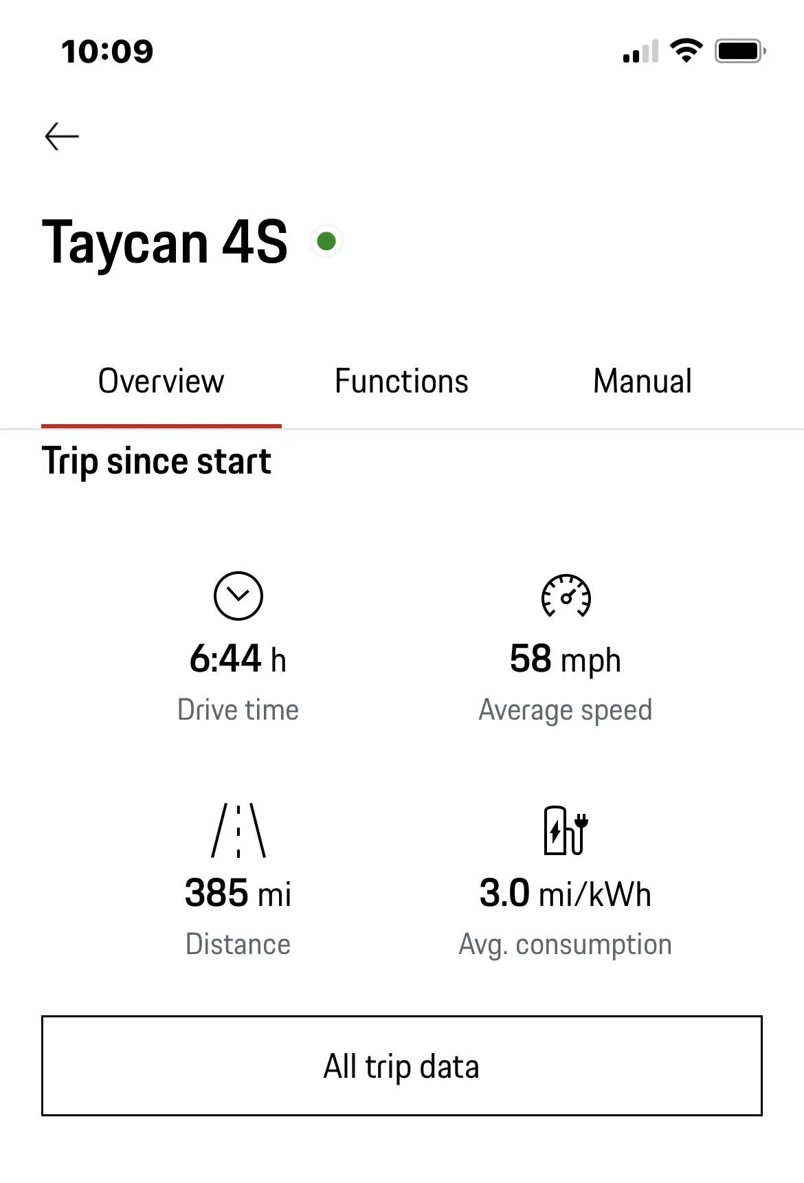

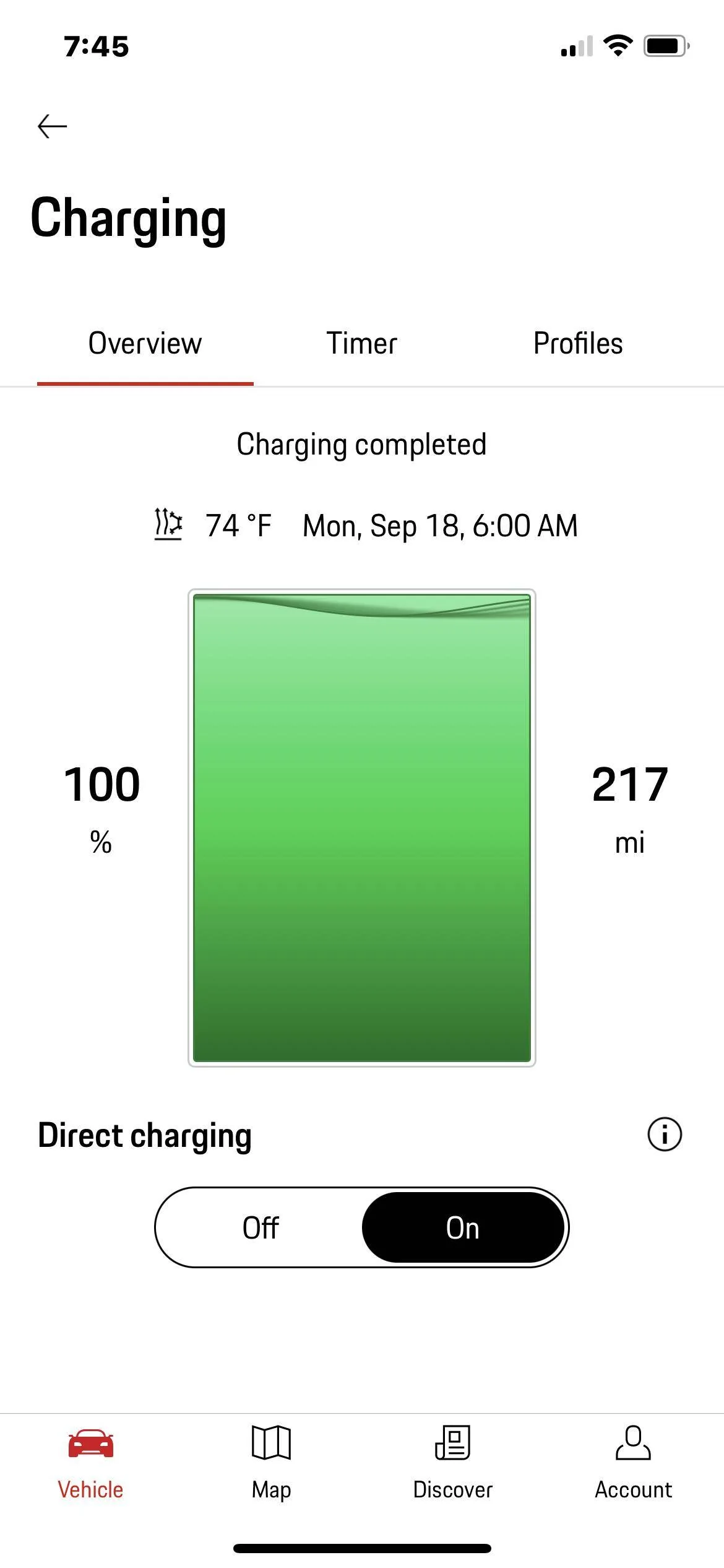

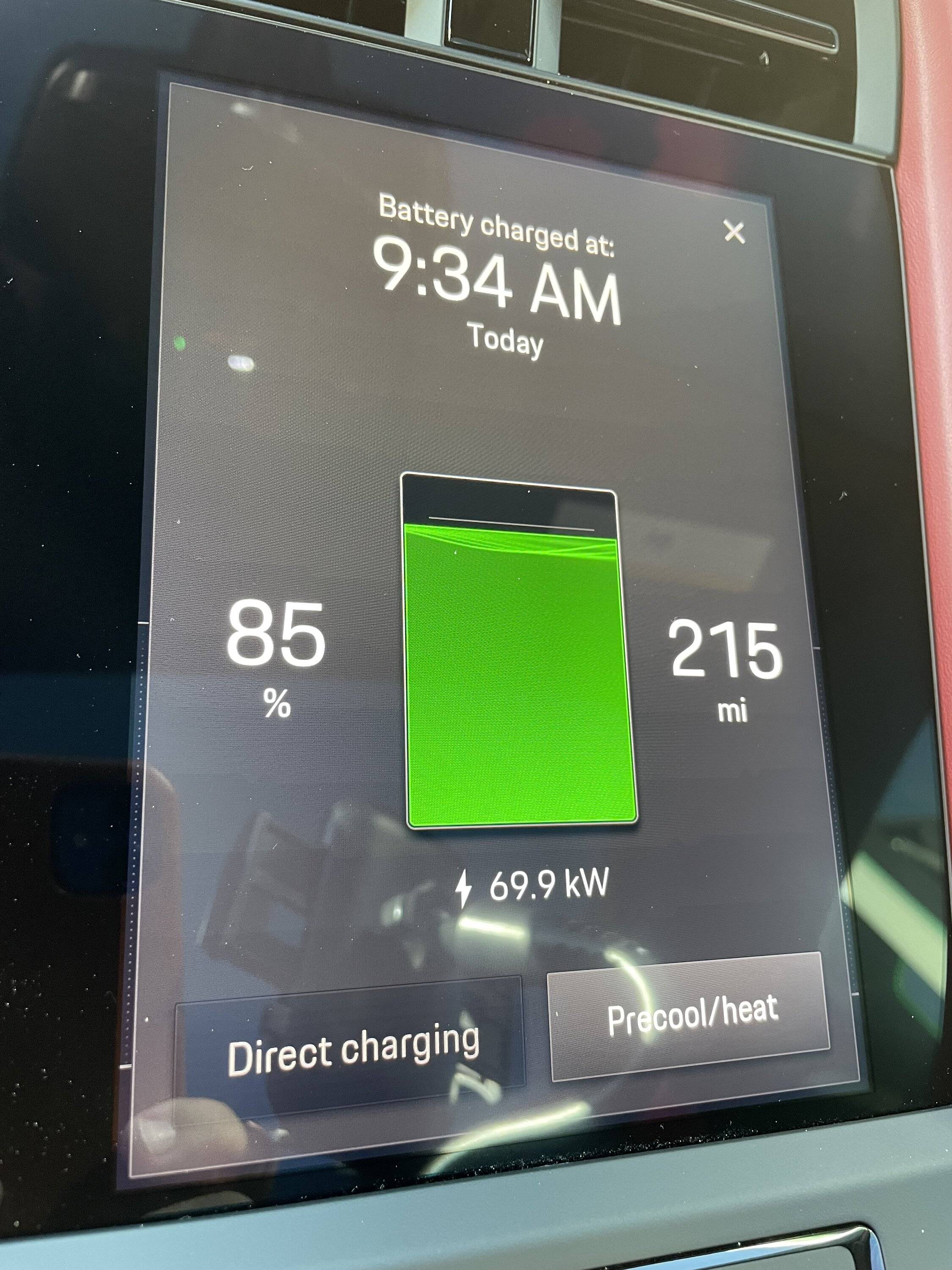

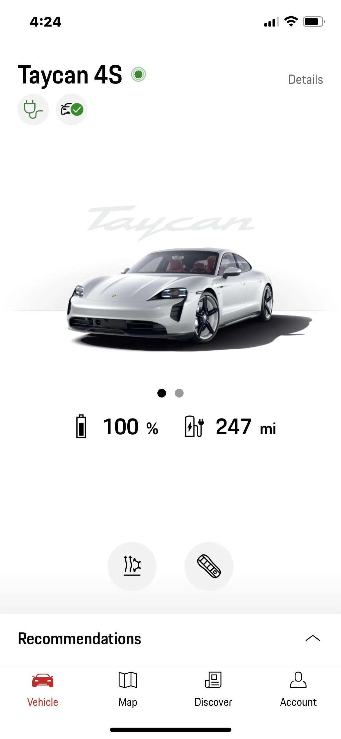

I bought my 2021 4S new 2.5 years ago, and I never intended to take it on long trips. I was more interested in a cool looking high performance auto to replace my 911. My Taycan came with all the cool styling options and 21 inch Mission E wheels. It has the sport design package which adds the aggressive looking go fast body accents. I found out , on this trip, looking cool comes with a significant range cost. Driving aggressively around town I have consistently got 240-250 miles on a full charge. I rarely charge to 100%.. Charging to 85% I would get a range of 215 miles. After my first stop to charge, on my 800 mile trip, I started to notice my range at 85% started dropping. By the end of my trip, my range now at 100% is 215miles. I’ve lost 30 to 35 miles total range with my performance plus battery. I drove consistently 75-80 mph using range mode with the AC on due to 100 degree temps in the desert. I also used Inno Drive and cruise control for driver fatigue. I can only assume that all the cool body accents and Mission E wheels impact range a lot at higher speeds. Now that my trip is over maybe my range will recover due to the lower average speeds I will be driving in town looking cool!

I rely less/little on what the guess-o-meter shows as estimated range, and more on miles/kwh consumption. Your trip shows 3.0 miles per kwh, which is good, in my opinion.
Edit: performance battery net 83-86 kwh X 3 miles/kwh = 249 to 258 miles (400 - 415 km) of consumption based range.

215 miles highway range at that speed is perfectly normal on 21 inch wheels and AC on. I don’t think anyone will do better. Porsche advertises 225 miles highway range.
