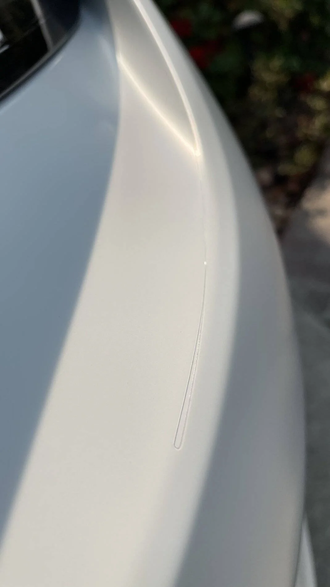

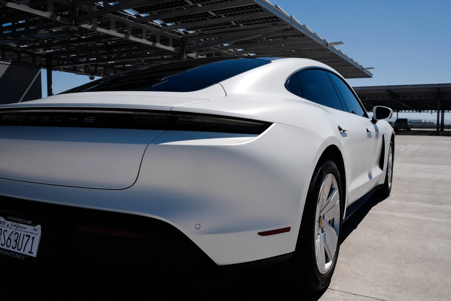

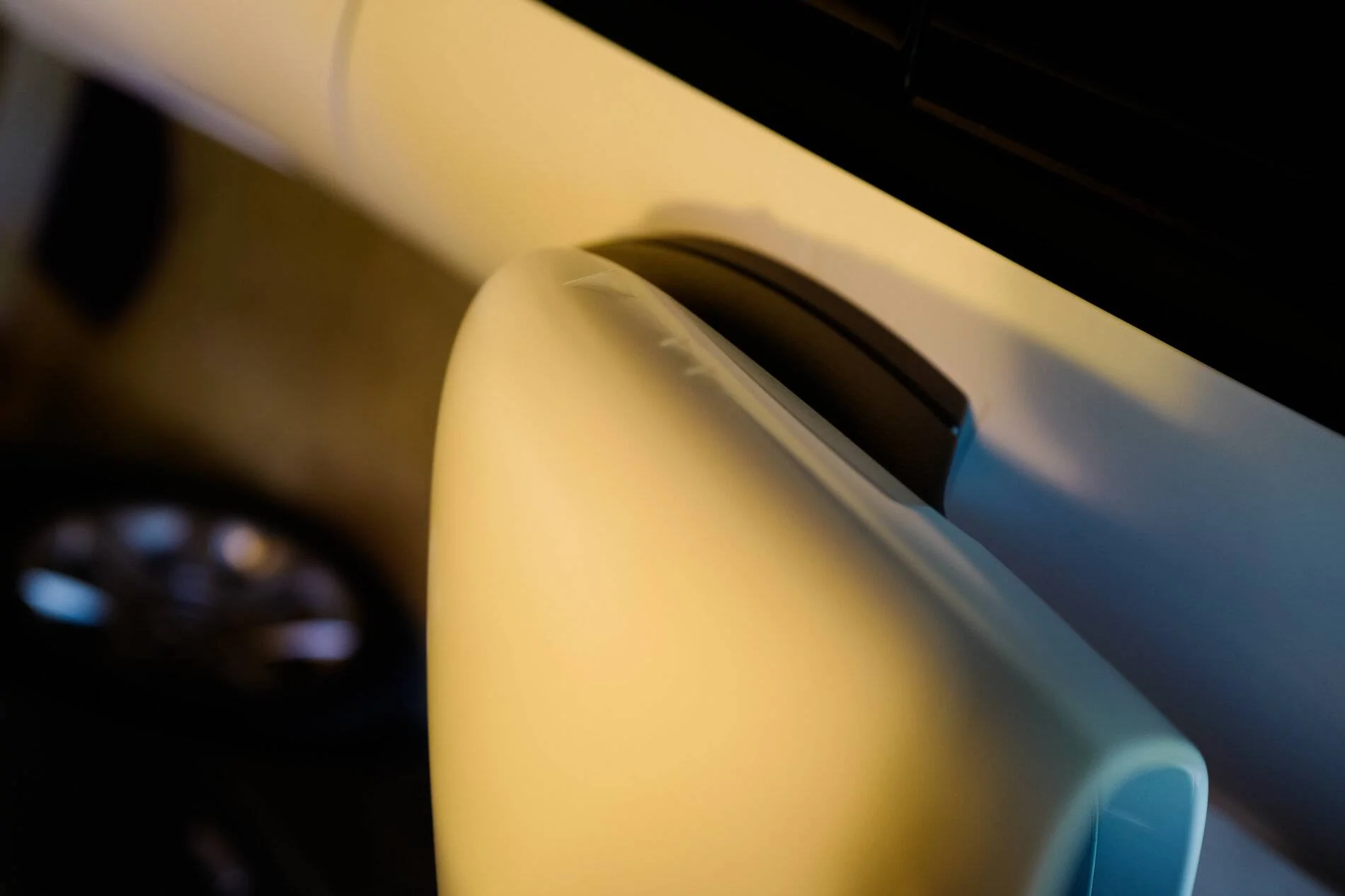

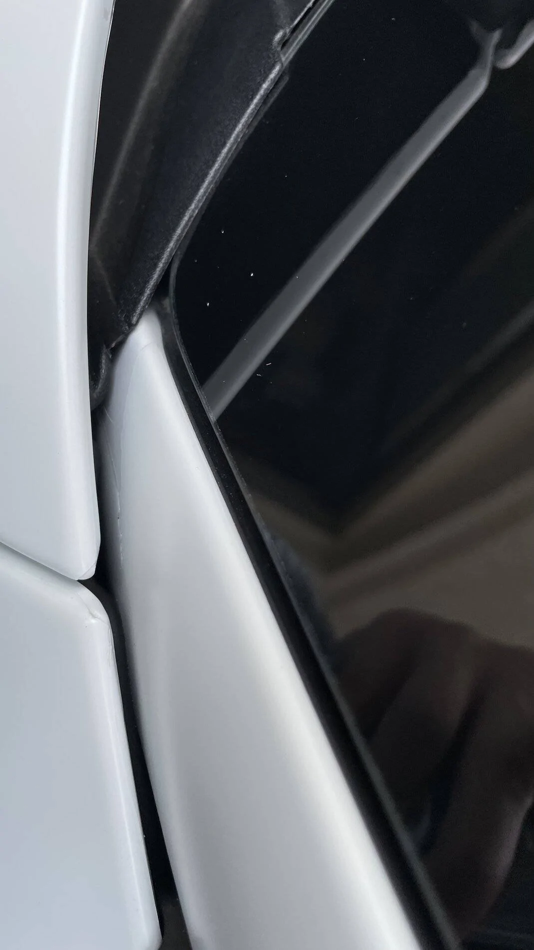

Just got my Taycan RWD back from getting Xpel Stealth PPF and window tint installed (70% windshield, 50% front, 20% rear 3m Crystalline) - The PPF looks great at a glance but I took a closer look at home and noticed a few PPF edges that I want a second opinion on

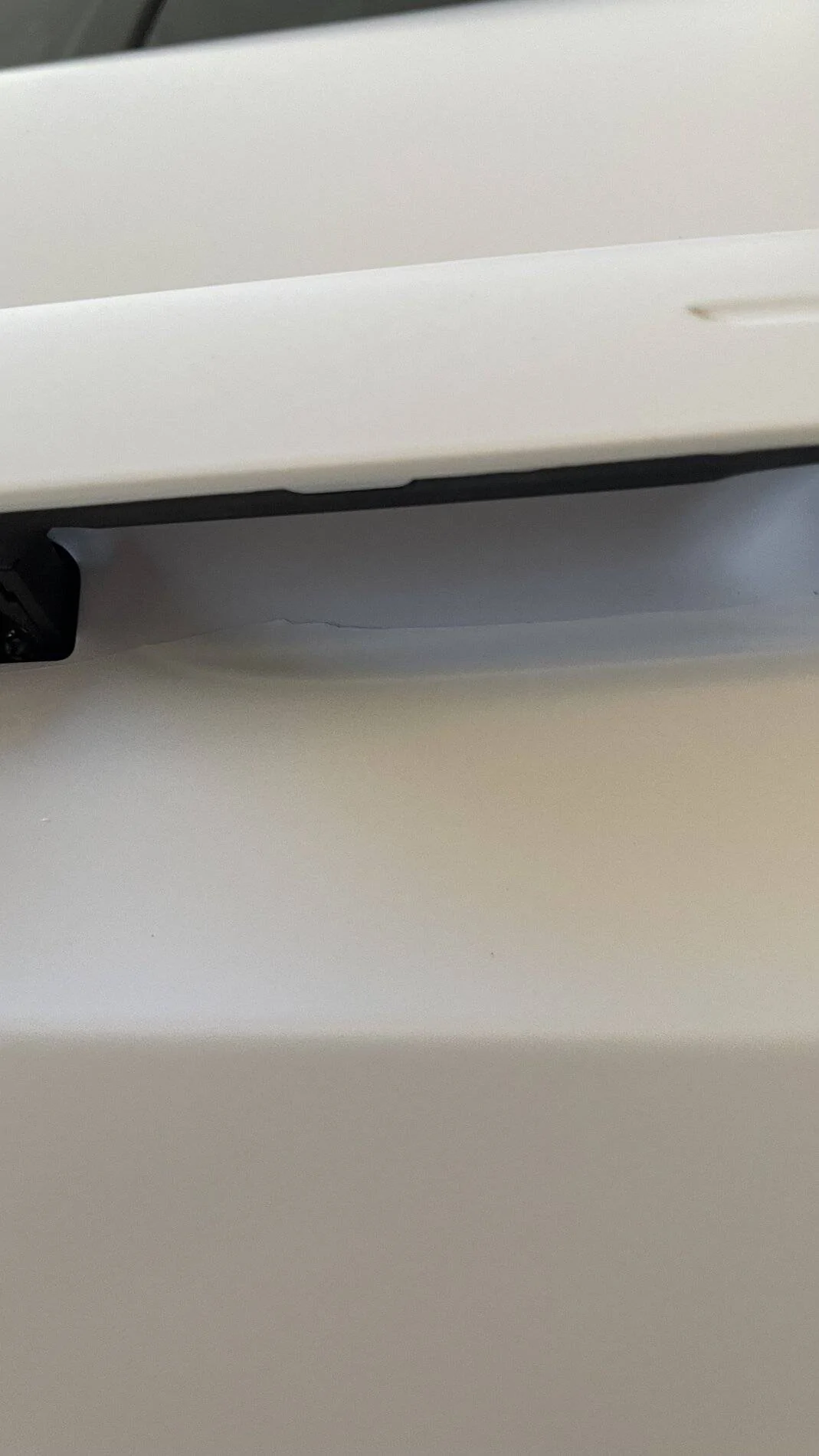

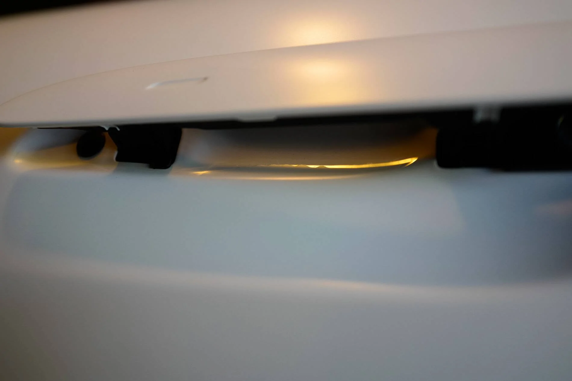

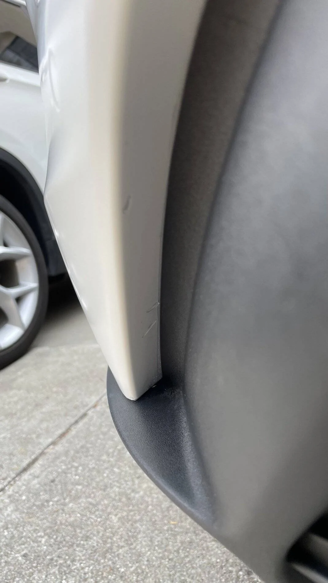

1. should the film under the handles be completely covered? it may be hard to see in the pictures, but there is a visible uneven edge when the door handles are up

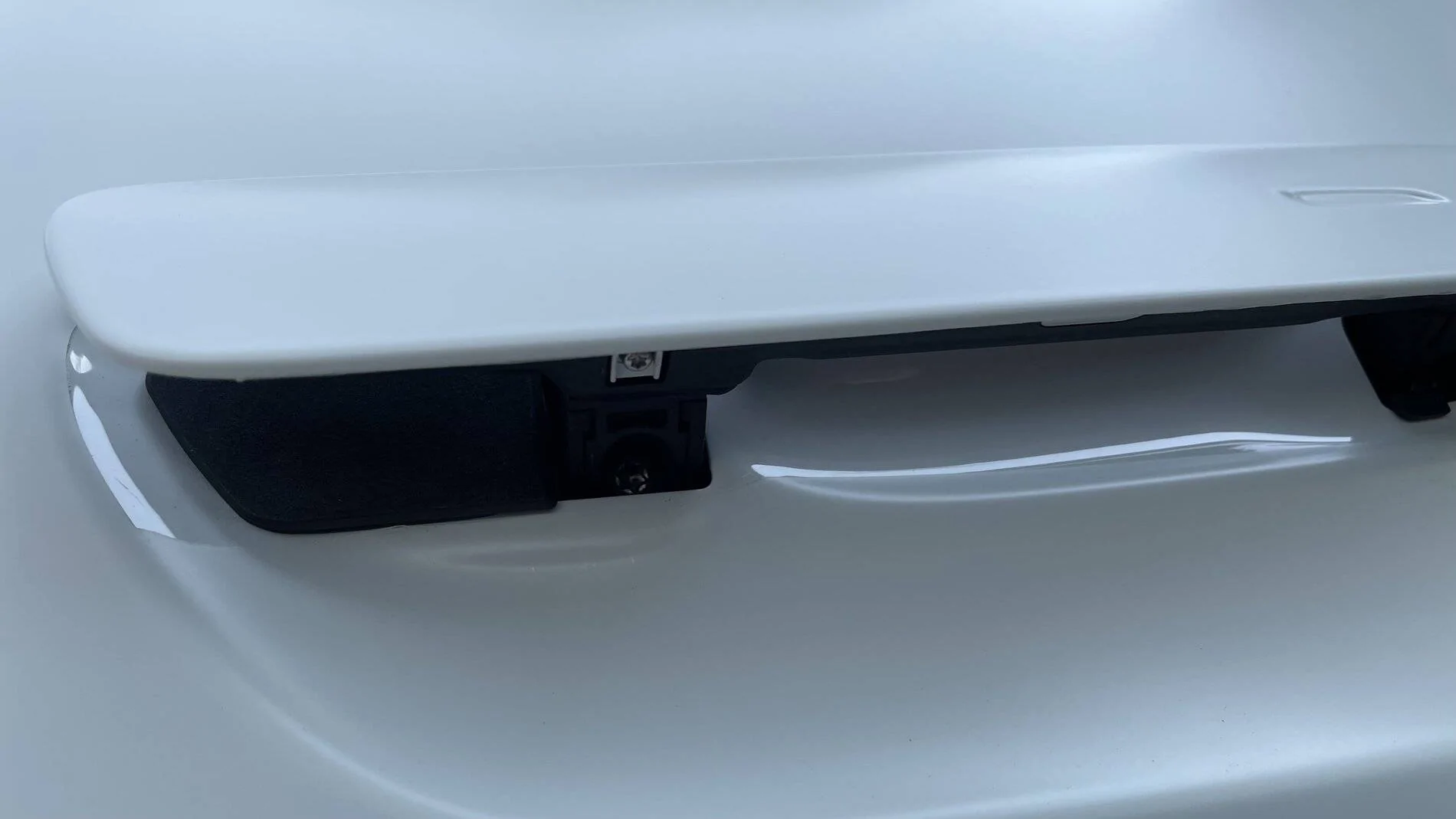

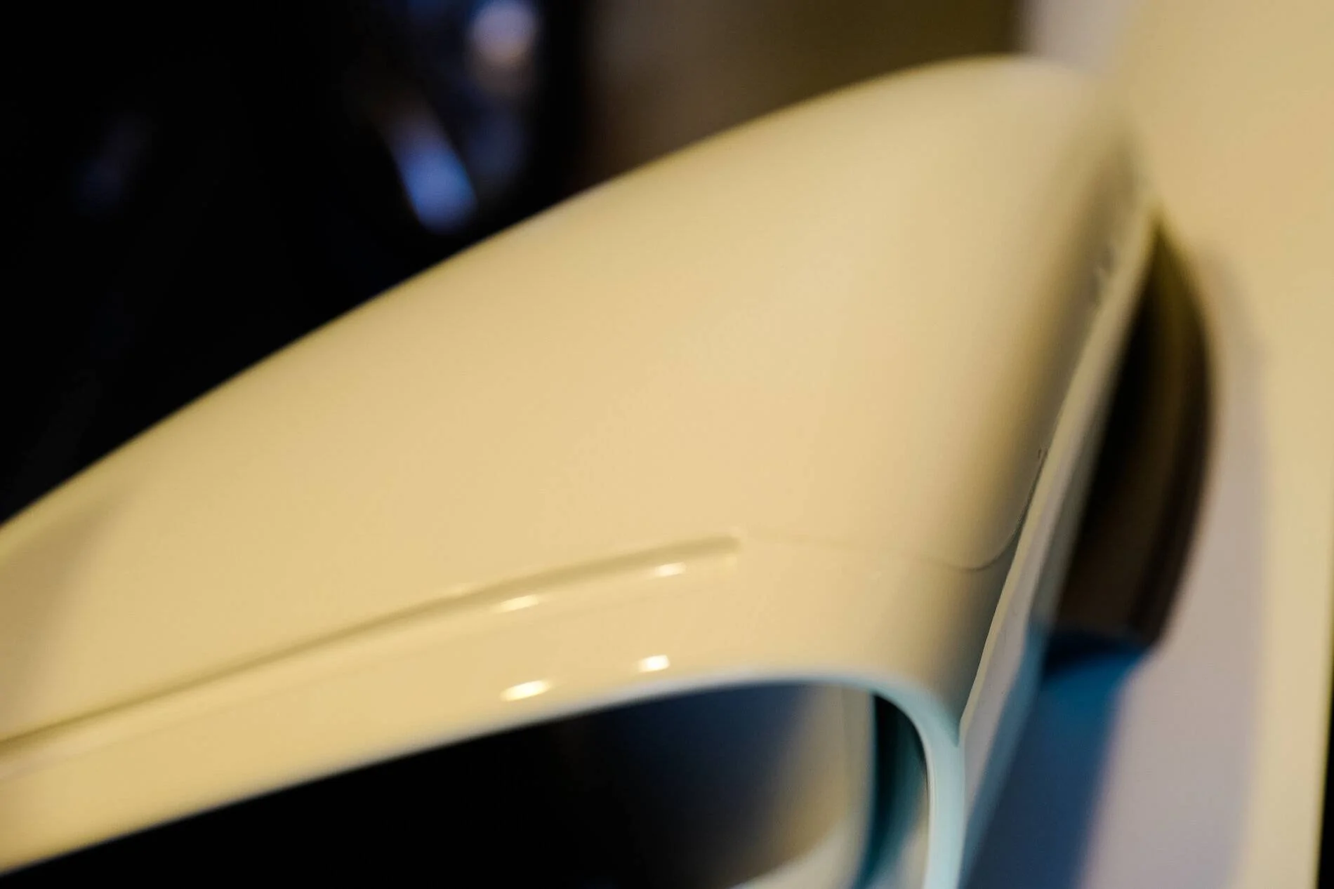

2. should the side mirrors be completely covered in PPF or partially like in the photo?

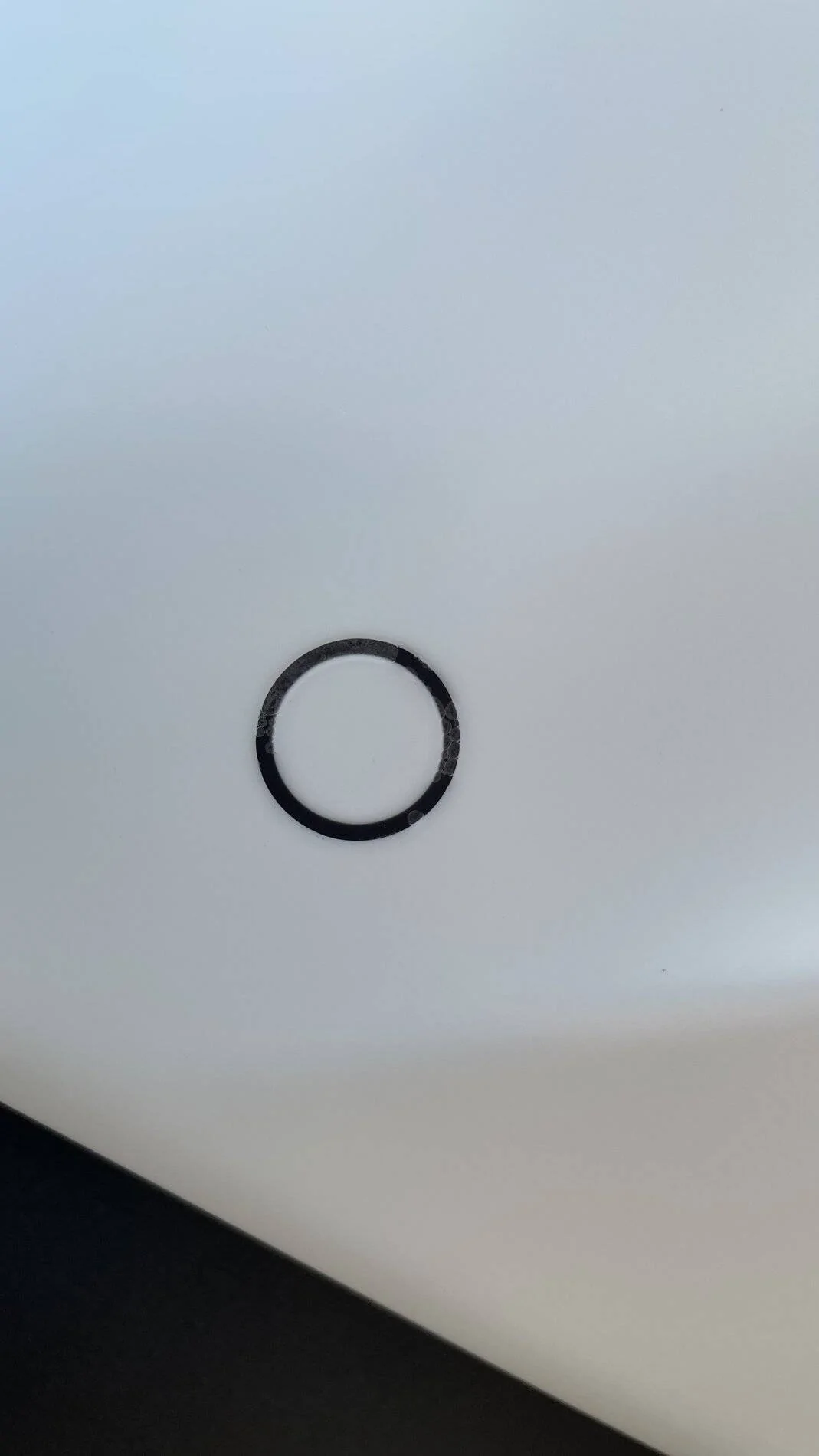

3. there are several small (less than 0.5mm) circular depressions in the film on one door panel. I noticed because some dirt accumulated in them which made it stand out (not shown in photos). I'm not sure if I should ask to get the entire film replaced?
I'll definitely call out the crinkles on the edge to get it fixed but what about the other issues above? This is my first PPF install, so I'm not sure what is expected when it comes to full body PPF
Thanks in advance!!

That is substandard. XPEL warrants their installers work so I recommend you visit the corp website and find another XPEL authorized installer to remedy the problems.
I had multiple problems with my full expel/ceramic work(sent out by the dealer pre-delivery) and took it to a XPEL location and it was all redone under the warranty. It is now absolutely stunning.

there should be no crinkles at all.
a few places are not covered by ppf but they are absolutely tiny and you barely see

The problem with stealth is that any exposed places can look bad. I’m not sure how I feel about mirrors not being totally wrapped if part of is matte and part is glossy.

They need to redo it.
Crinkles aside, there should be no visible lines of PPF. Dirt under the PPF will be a big problem in the future.
The wrap should be so perfect, it's indistinguishable from a factory paint matte finish. Zero gloss paint visible.
You will notice installers remove the door handles to insure a seamless wrap

Yeah, I’m not sure how much you paid, but that would not be acceptable in my book.
If the installer is not removing the door handles, it is not uncommon to have an uncovered area here. I specifically asked the installer not to remove mechanicals, so I have a gap as well, but the gap is a straight line.
Many templates and PPF installers do not cover the entire mirror. So this is not exactly uncommon. However, I can assure you that some people would also not find this acceptable. Installers prefer to remove mirrors to do complete coverage; since I did not want to have my installer remove any mechanicals, I have only the top of my mirrors as well. (Without the puckered edge, though.)
That's not OK. It should be fixed, and I would indeed leave it up to them to decide how to do it (at least the first time).

it was $5670 for full body stealth xpel ppf - I'm definitely going to call them out on the shoddy edges and hopefully get them to fix everything during a complementary follow up appointment next week
Thanks for the responses and helping me understand what is and isn't acceptable

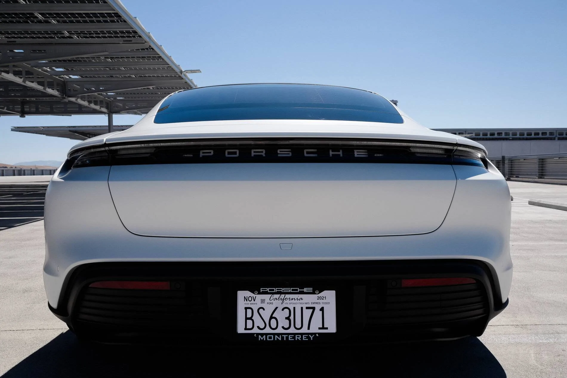

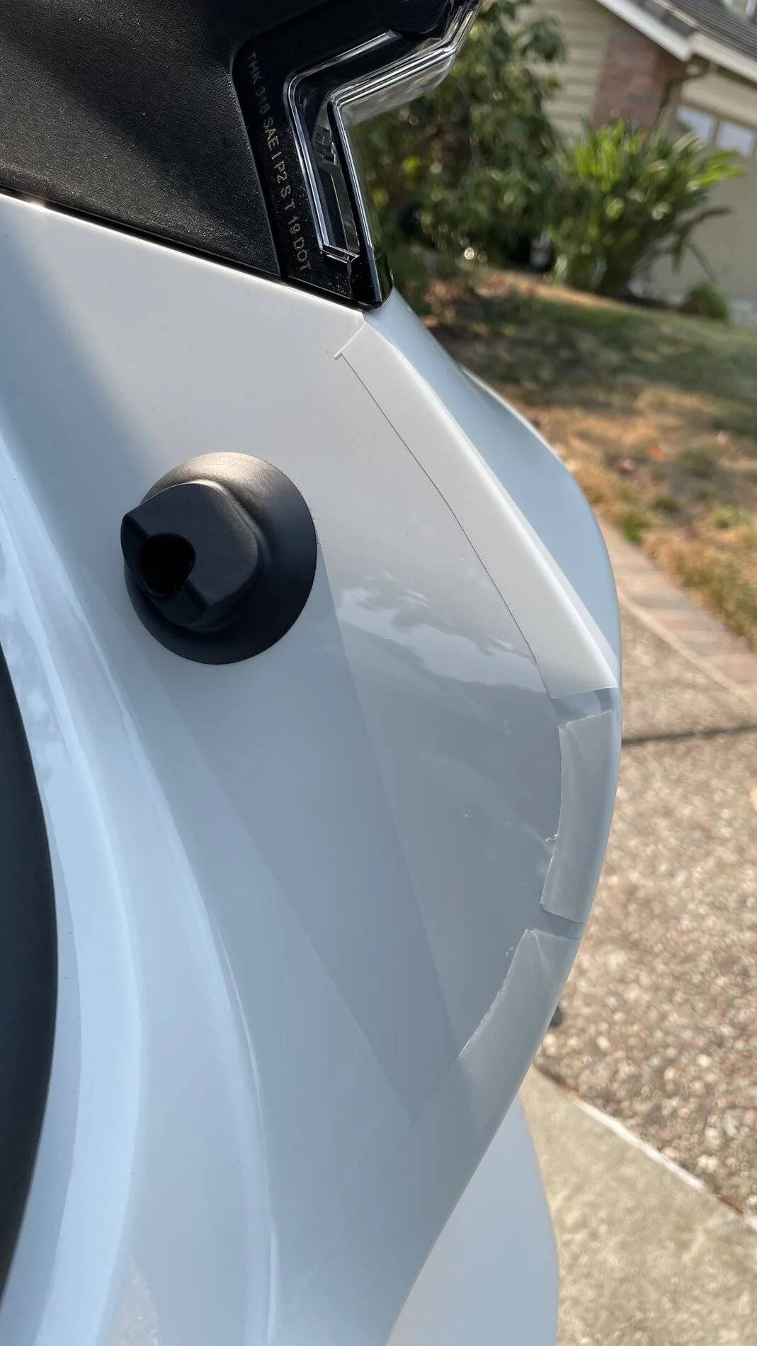

after the 'fixes'... ugh... the side mirrors are correct now (still not fully covering though) but the back looks worse

My trunk (last pic) looks somewhat similar as yours (can’t speak for the rest of the car). I think that curve is really hard to cover with PPF, but on mine it’s not noticeable since it’s gloss and blends in. Only way you can tell is if you run your fingers along it.
Wow - that is seriously sub-standard - my 2015 front half install on my M4 is literally light years better in respect hidden edges and flawless finish and I know for a fact there are even better installers in my neck of the woods.
The ragged edges, bubbles, creases etc. here and 100% unacceptable but unfortunately you now need to find a reputable installer to fix this (not this outfit) which means probably a lengthy discussions with corporate. IMO, this installer (or perhaps it is the specific tech) needs to be removed by Xpel Corp. if currently a 'recommended' Xpel shop - terrible!

You will certainly see dirt collecting on trunk portion which would make it even more obvious.
The best solution is to find a more qualified installer

Yeah... this is quite annoying and concerning. I sent the pictures over to a different shop that is much more reputable (and expensive) to get their opinion and they hinted that a re-install may not be covered under warranty due to this being an install error and not a film defect. There is no way I want to pay another 6-10k to get things redone correctly and I don't want to fight the shop that installed the film since they'll insist to fix it again
Yep! Just checked the Xpel site and the shop I used is listed as an authorized installer.. Very disappointing
