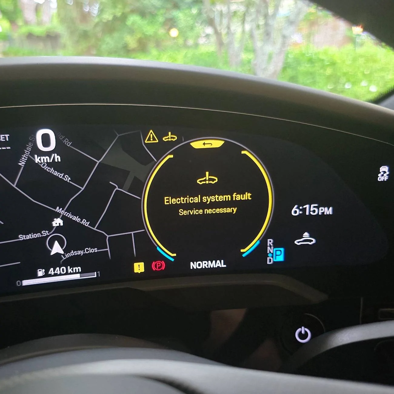

MY25 RWD, had yellow electrical fault show the day after charging to 100% for the first and only time. The message cleared after restart and has never returned. I have only ever charged to 85% prior to and after this event. Booked for a dealer check shortly. Is it necessary to charge to 100% every so often for the battery management system to recalibrate? Any thoughts on likely cause for error message? TIA
