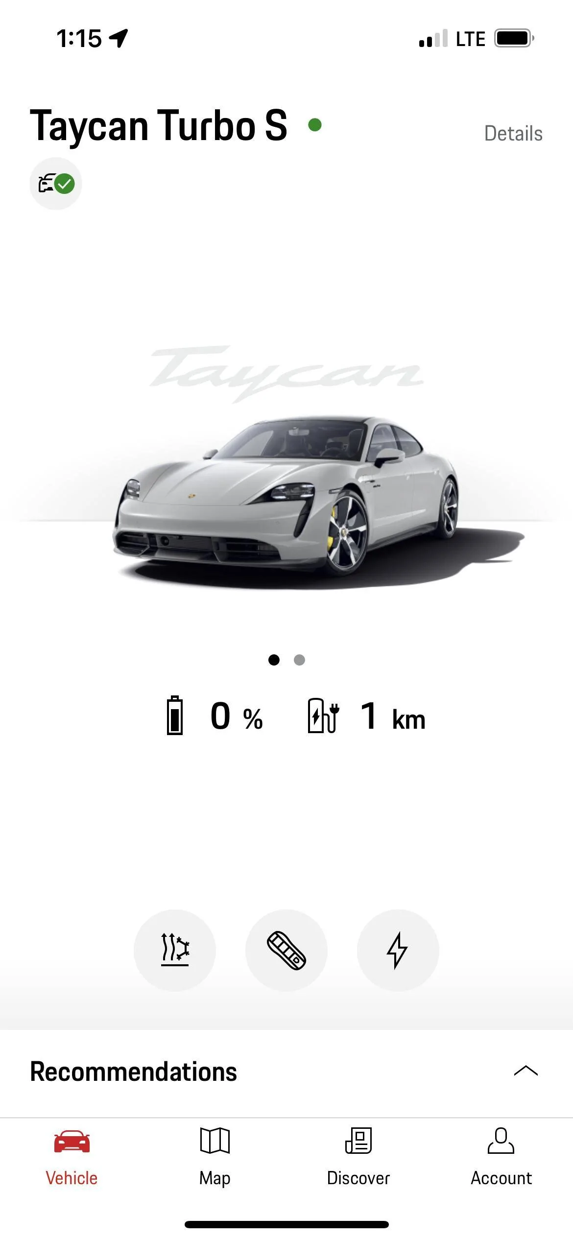

Still don’t get it. You’re joking, right? I mean charging and using between 50-70%.
PS Are you sure they are not charging? It looks very much they’re using one of these -
Yes, there may be some farce on my part. My apologies. “Comedy can be a cathartic way to deal with personal trauma.” -Robin Williams
There may be a trickle charger connected, I don’t know, but that would explain the slow rise in ? . The dealership is too far away for me to drop in and check.

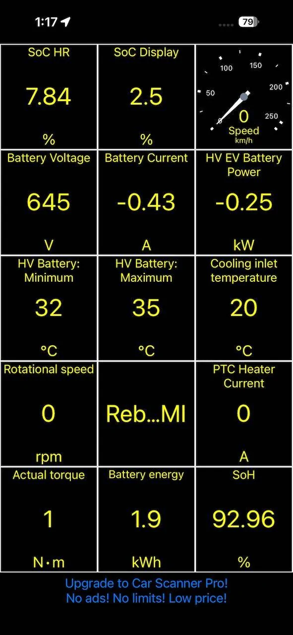

Low side buffer is there, do not worry.
When SOC displayed 2% the Real (HV Battery) SOC was 8%.
Porsche Taycan 0% Charge IMG_0080

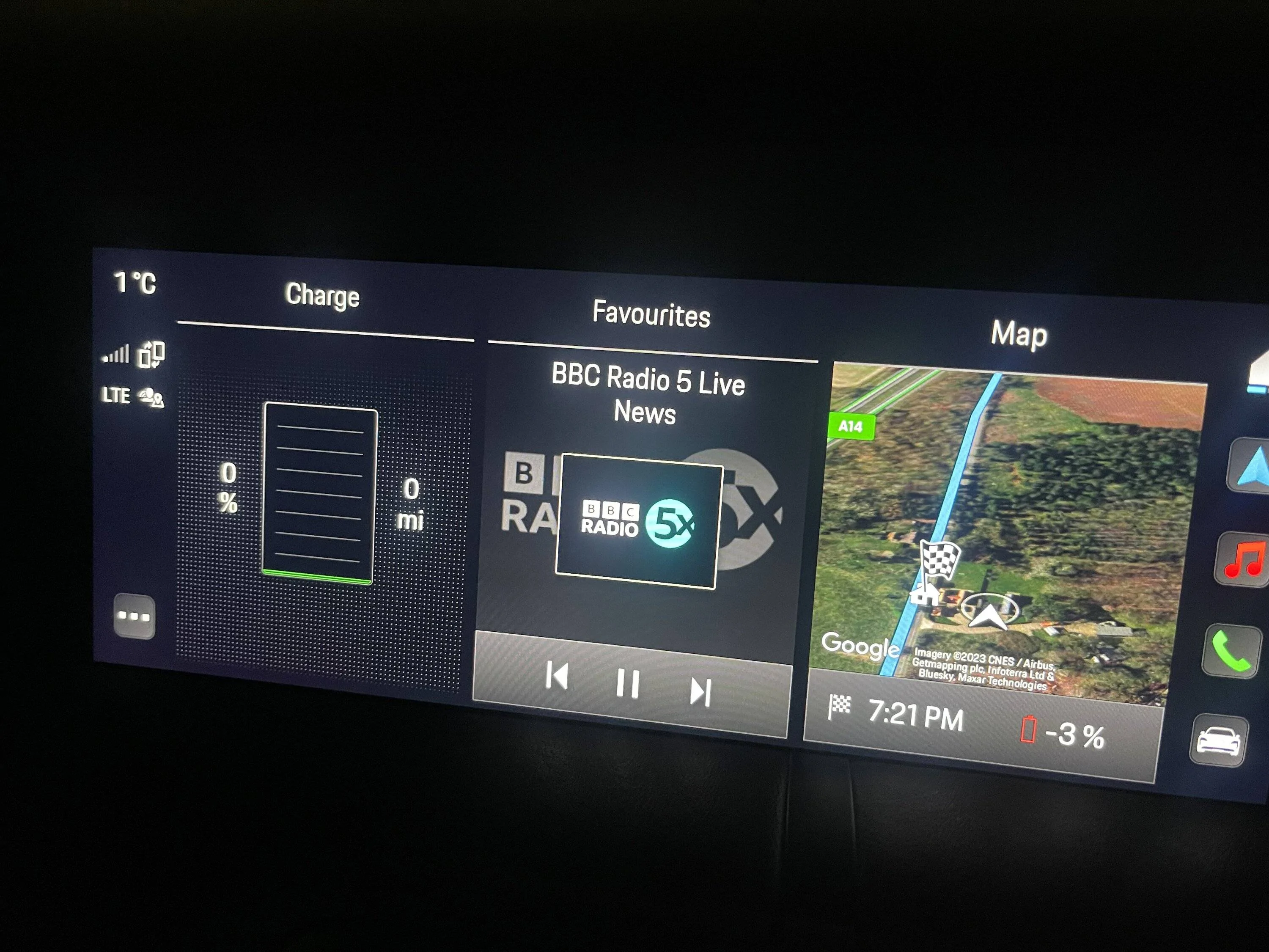

Anyone get to these battery levels before topping off again? ?
I've had the Taycan to 0%, had it automatically shut down at a stop, then got it to turn back on to turtle mode limp 12 blocks back home. True story.
I've also driven it 2 miles to a charger on 0% only for the first charger to not work.
