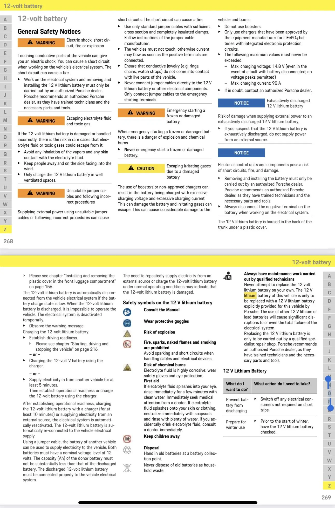

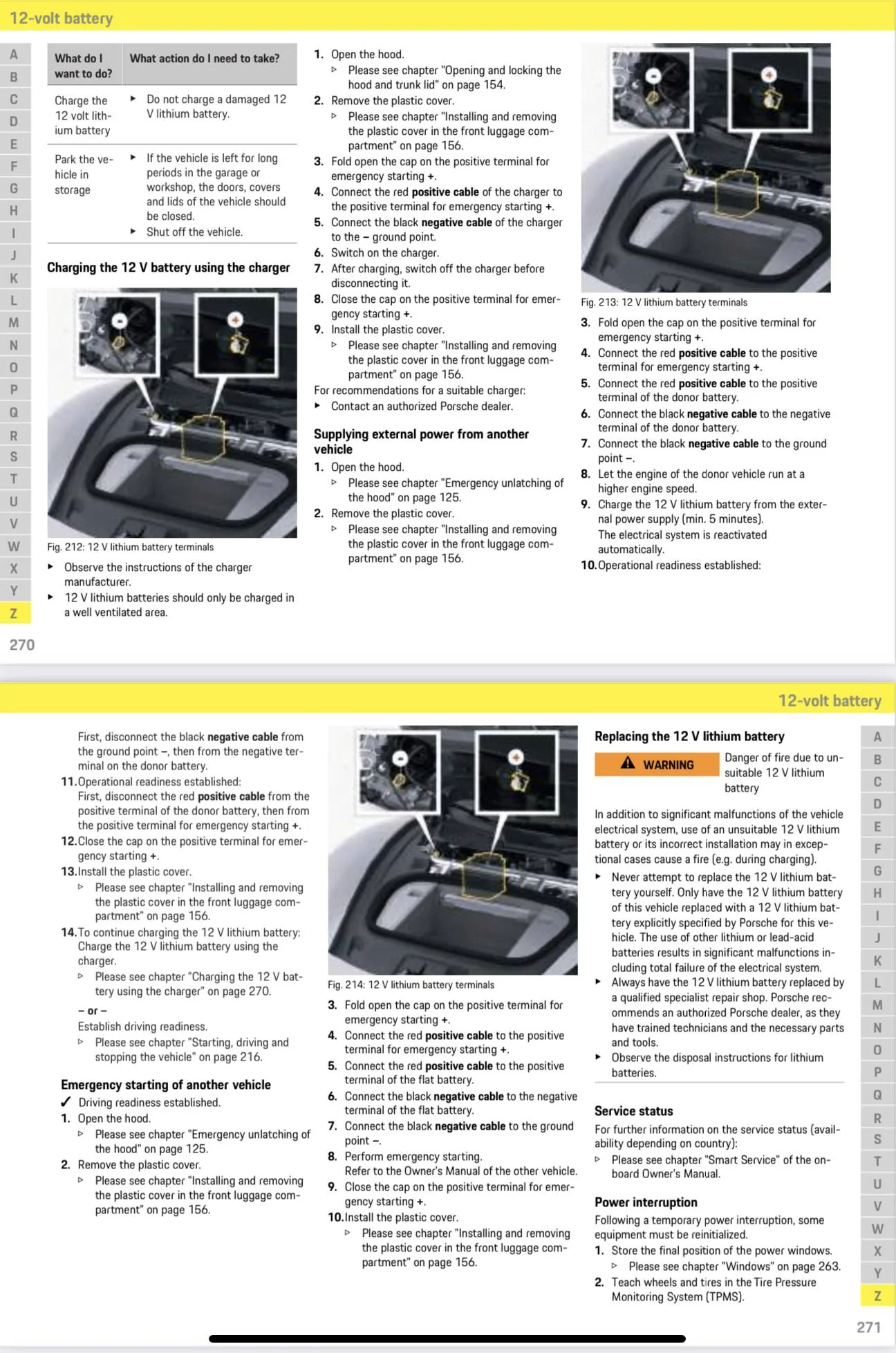

Taycan manual says: "When you get into the vehicle, the key you have with you is detected by the vehicle, and readiness for operation is established automatically. ... To protect the battery, only leave the vehicle in standby mode (ready for operation) and only use the active electrical equipment for as long as is absolutely necessary."
---2022 Taycan owner's manual page 113.

It does, but there are limits
- for a limited duration (up to 30 minutes per charge session)
- up to 50% SoC
- a total of 8 charge session whilst the car is otherwise parked / ‘off’
If your 12v battery health isn’t good, you exceed the total number of charge sessions, have a higher parasitic draw then the algorithm isn’t infallible.
