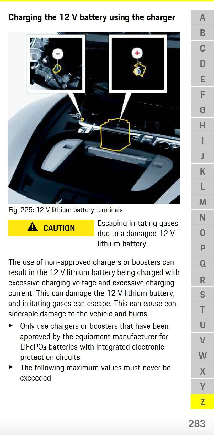

BTW, where exactly do you connect to the battery in this car?
With the Battery Tender OBDII adapter I do not need to connect the BatteryTender conditioner to the car's remote charging posts. The OBDII adapter plugs into the OBD diagnostic port that is located under the dash area below the driver's side (on US cars). It only taps into the power and ground pins on the cars OBD port. The adapter can be used with Battery Tender Lithium Chargers/Conditioners below 3 amps.

If you want to use the Taycan's remote battery posts instead of the OBDII adapter...

Know what Amp Hours the Taycan 12V is rated and are you using a 5, 10, or 20 amp trickle charger? Louv has a 10 amp. Thanks
I'm not sure what the rating is on the Taycan Battery. However, the LiFePO4 charger I have for my BMW M4 is a CTEK Model 1082 rated at 4.3A max output. I also found this $40 LiFePO4 charger on Amazon (https://www.amazon.com/gp/product/B087TDDZRG) which is rated at 6A.
I've forwarded the main thread link to my dealer and asked them to please stock a Taycan battery in case I (or someone else) may need it at some point.
I'm simply going to drop a standard charging pigtail down from the battery terminals to somewhere easily accessible from the outside/underside of the car. (Assuming I can find a convenient path without having to modify the car). I have a bunch of these cables and they all have a capped end to keep the connection covered/insulated when not in use. Then, if I do have a problem, its just a matter of temporarily hooking up a standard 12V source to gain access to the car, and potentially a proper LiFePO4 charger to re-charge the battery. No tow required...
I don't see any point in continually trying to keep the battery topped up with a trickle charger as long as I can easily gain access to the "battery terminals" from outside the car...
