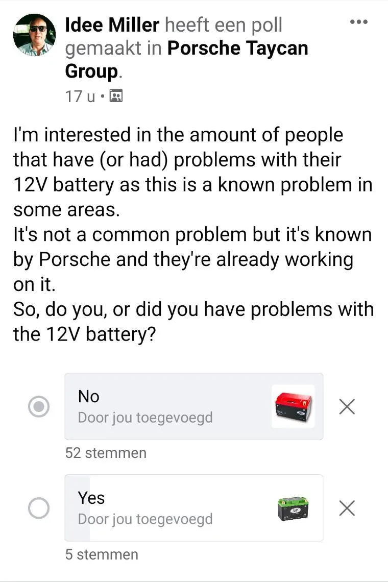

@TAYC4N I respect your opinion, but you are wrong. It is an issue for Porsche. Senior people at Porsche NA confirmed to me this past week that Porsche is aware of the 12v battery failures, and is working on a fix. Porsche is trying to identify something quietly, since they do not want to issue a recall on the vehicle. If you read informed comments on the board by @louv , you can gain a little additional insight on the potential issue - whether is is a limited number of faulty lithium batteries, or a wider software issue. We have no idea how many Taycan's have been affect, although informal polls on the Internet may give us a very rough estimation.
As for me, my Taycan has been in the shop for 10 days while I wait on a replacement 12v battery. It is frustrating because I live in a fantastic part of the world for driving and I am losing nice summer weather. Once again, I respect your opinion, and your right to share it, and I hope your Taycan continues to operate normally.

I understand the battery running out of juice, I don't understand why it needs to be completely replaced (vs. just recharged with the right type of charger). Or is it if it goes to 0 it just totally is useless?
I know it is very small consolation, but I appreciate that you have gone through this so that other people can benefit from the experience. I did just get a trickle charger too, so Amazon also appreciates your effort ;)
I have a Taycan 4s.
My 12v battery went down in the second day (only 140 km....about 100 miles done), Taycan go dead. No possible open doors, or run the car...nothing.
After to recharging the 12v battery (don't ask me how I did it....it was an oddisea!!!), Taycan's PCM system didn't works properly.
When 12v battery was replaced --> PCM go fine again.
Only a few hundreds miles later, new problems with 12v battery...definetively Taycan has a huge problem in this point.
Please.....HELP FROM PORSCHE.......It is very very terrible frustrating.
Now PCM it is completely crazy, no internet conenction working, etc.
I will ask for a new replacement of 12v battery again.....it will be the third battery in only a few miles done.
