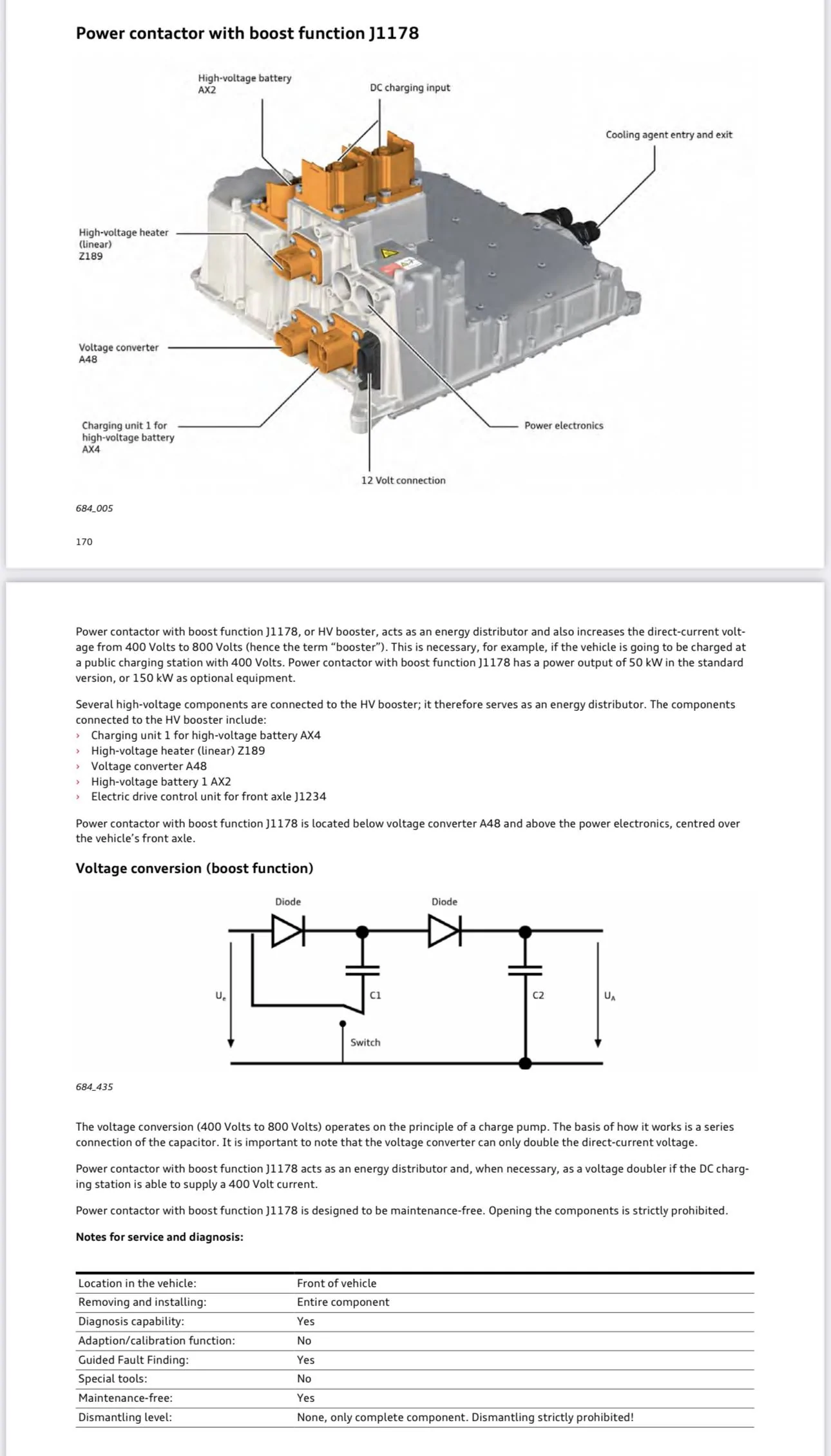

I believe the 22kW onboard AC charger is the ‘big beast’ it’s bolted to the front of the power stack over the front axle. It’s also waaaaay more expensive than the standard on-board AC charger. So I get that isn’t standard fit.
The 150kW DC “booster” however is one and the same unit as the main power contactor unit.
I don’t think there is a significant weight or size penalty for the 150 kW version vs 50 kW version.

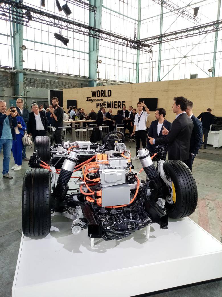

Can see them all mounted here, together with the infamous Webasto heater…
Porsche Taycan 150kw/400V retrofit? Taycan platform chassis
