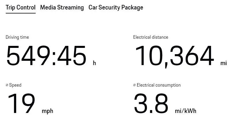

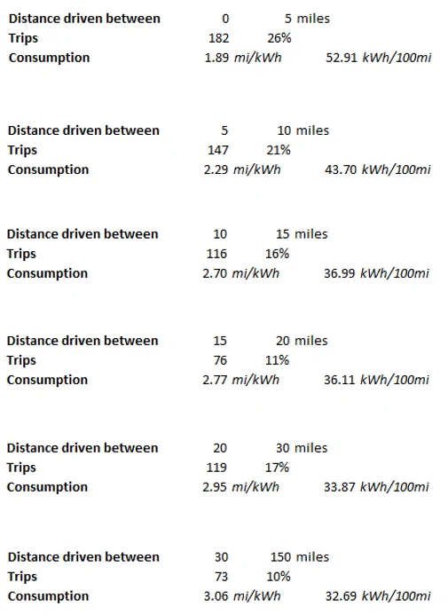

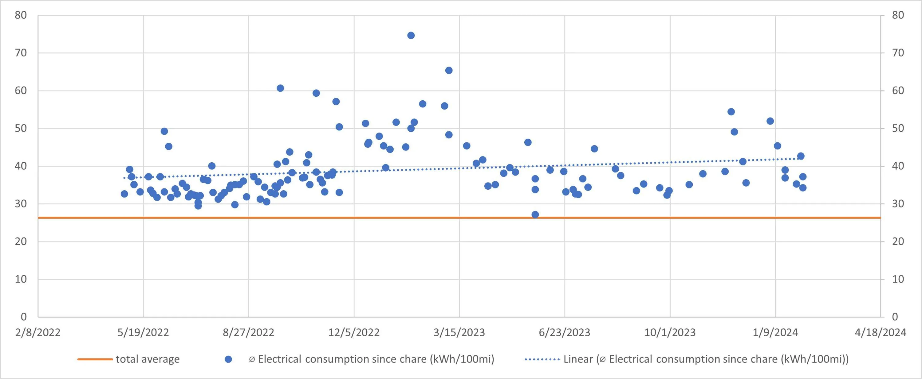

I'm not getting 3.8, that's just what the app and the car says for total consumption. Looking at the individual trips and calculating the total from there, I only get 2.81 mi/kWh or 35.5 kWh/100 mi which I think it terrible, especially for a base Taycan.
The 3.8 miles per kwh gives you something to brag to your friends about, but you (and we) know it's not true.
I have the same exaggerated result from the MyPorsche account, but on my long trips when things are optimum, 3.2 miles/kwh is about the best the car achieves. Yet, MyPorsche says the overall since delivery is higher than that.
It's similar to the console displaying a range of 320 miles immediately after charging to 100%. Once you drive the car out of the driveway, that guesstimate gets overwritten.

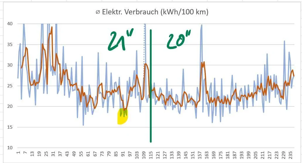

I switched from 20" Turbo Aero to 21" Carbon Blade SportDesign last summer. It's such a big difference in the car's look. it improved so much but the consumption suffered a lot.
The weight did not increade much (~500g per wheel+tire), the Aero should be similar as blade rims are quite closed,
but frontal air attack surface increased, tire patch + width and probably more sporty, less efficient Pirelli tire rubber mixture.
Do you have before and after numbers??
rs38
Nov 16, 2020
703
762
Düsseldorf
Taycan,GT2,i8,Tesla
last summer was rainy and I do not drive certain regular trips but I'd say 2 kWh more per 100km, though hard to read from the data. But the 5000km avg was below 20* before and now above, my personal landmark :)
this is 12 months of short trip consumptions:
Porsche Taycan 2 year ownership kWh Consumption Analysis 1707810497304
yellow area: I was actually testing if it's possible to get below 20 kWh if I drive slow and carefully.
(* ~32 kWh/100miles)

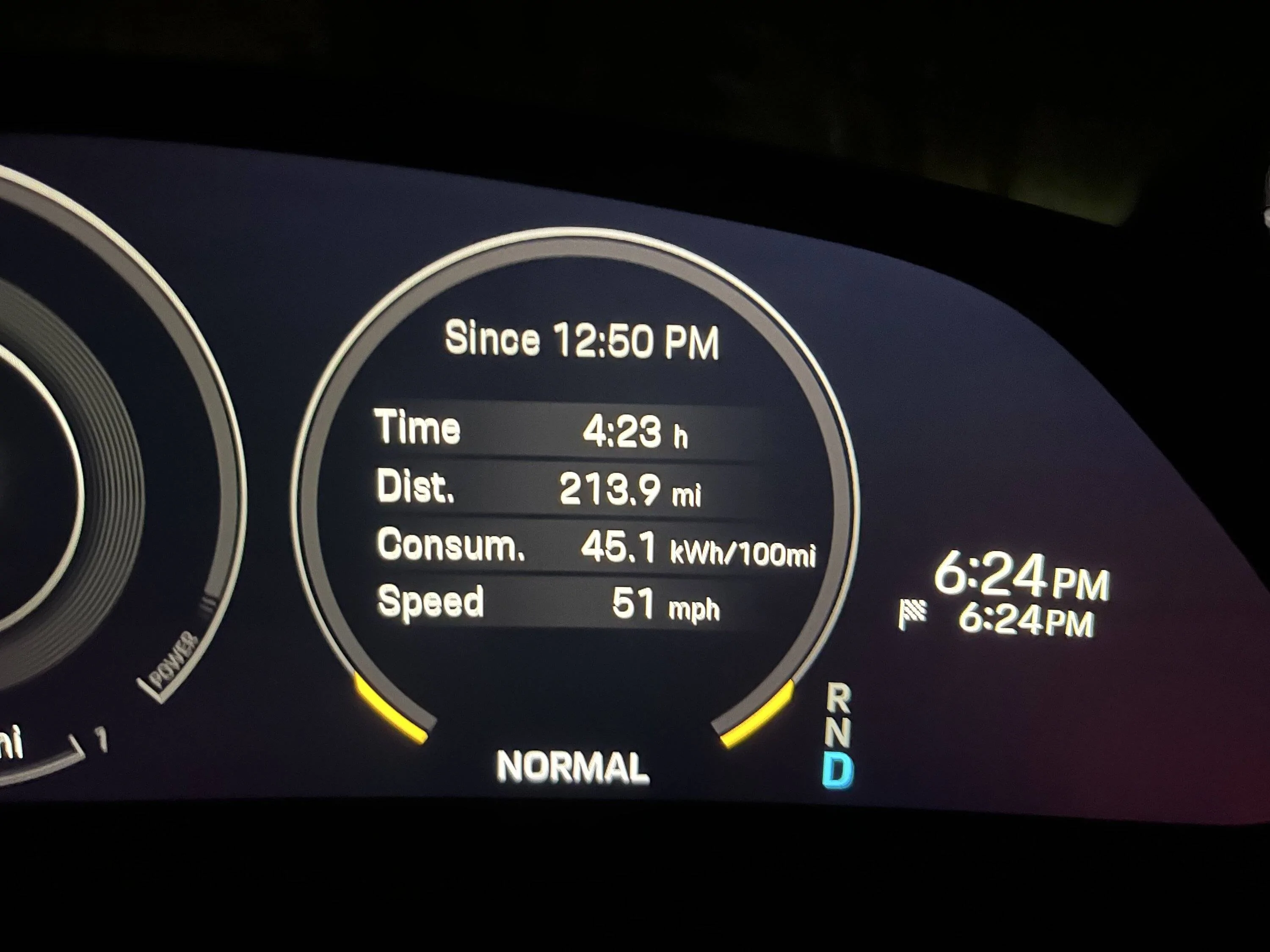

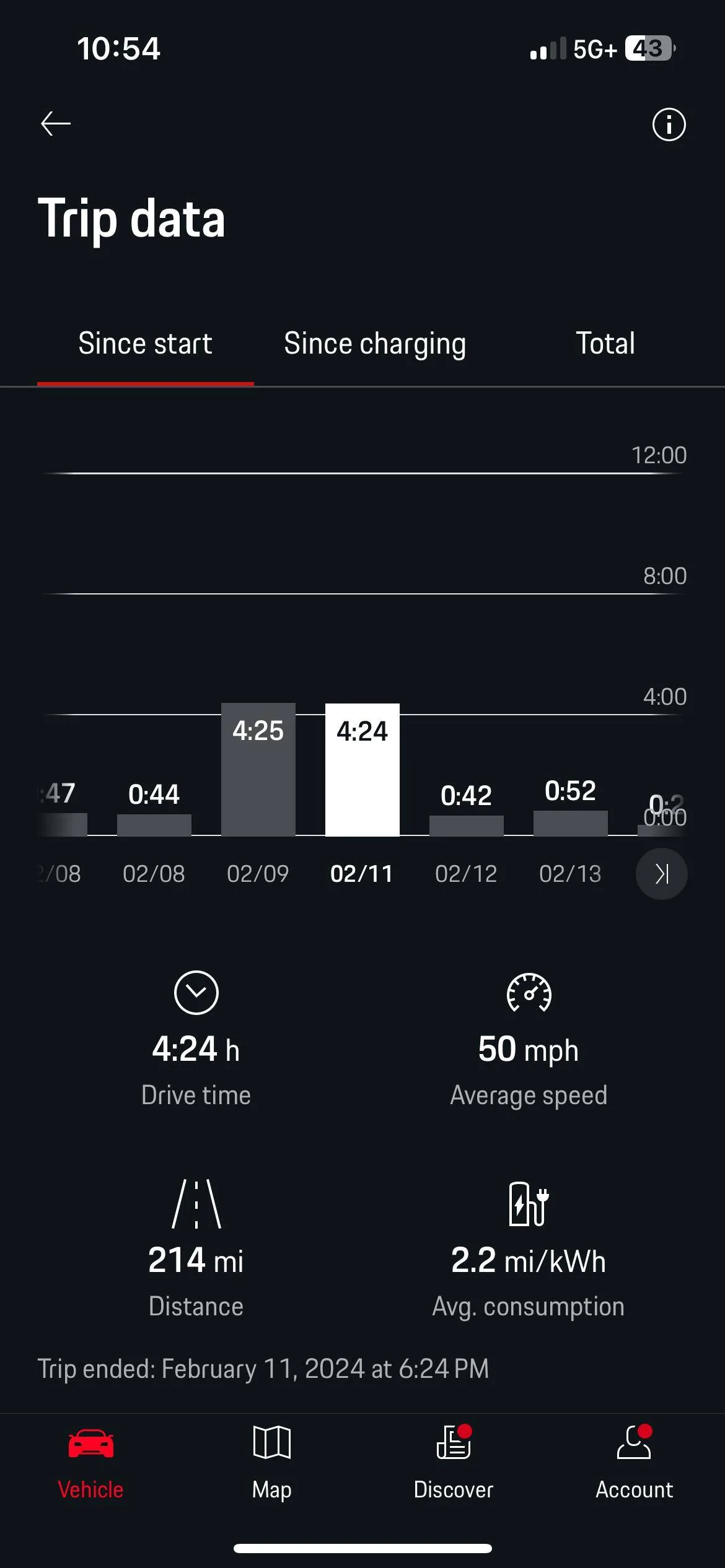

I, too, was perplexed about these observations (of mismatching numbers), so I’ve taken a pic of the trip report and compared it with the log entry from the app; they’re identical.
Porsche Taycan 2 year ownership kWh Consumption Analysis IMG_0958
Porsche Taycan 2 year ownership kWh Consumption Analysis IMG_0969
45.1kWh/100mi == 2.217mi/kWh

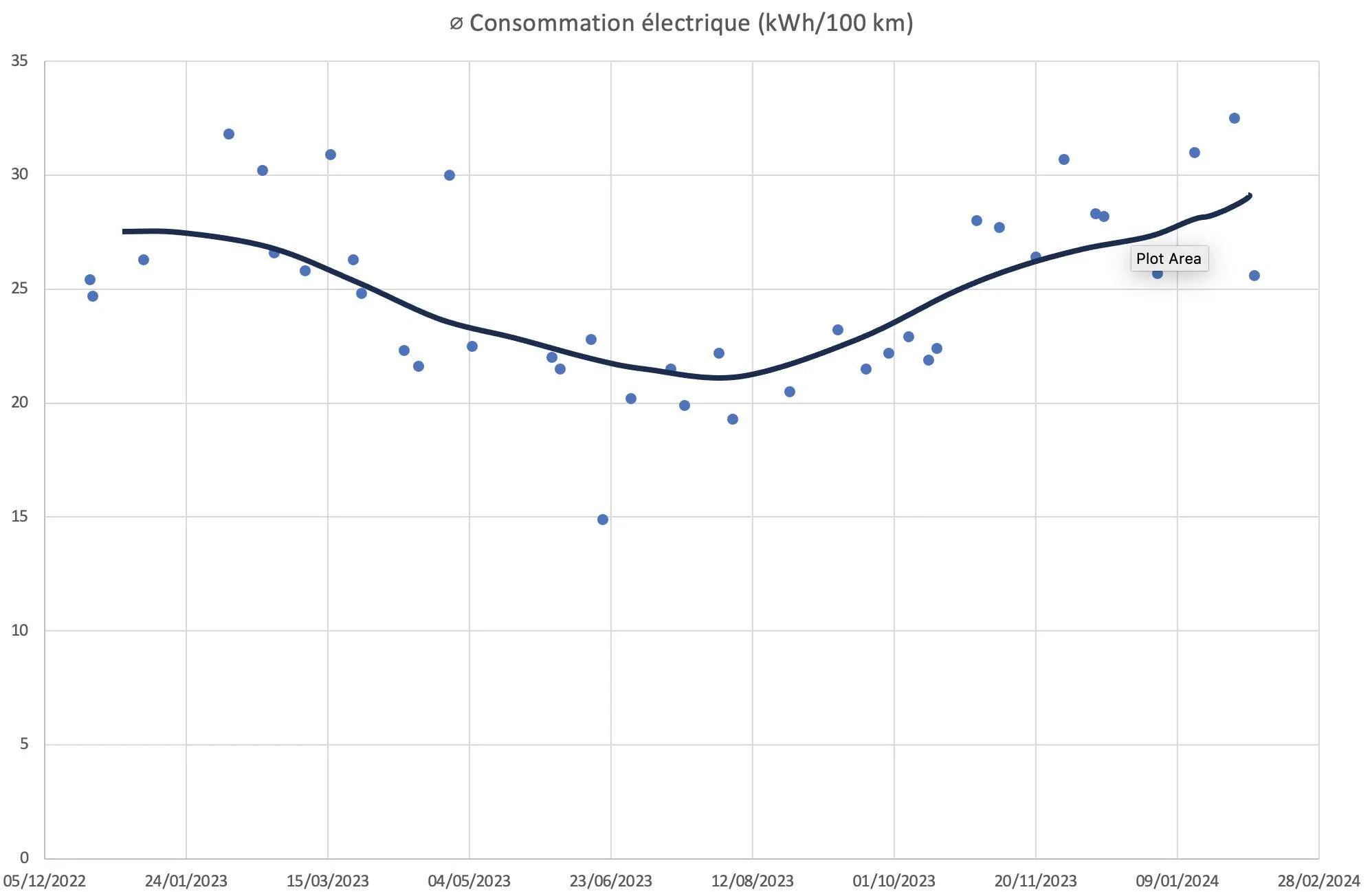

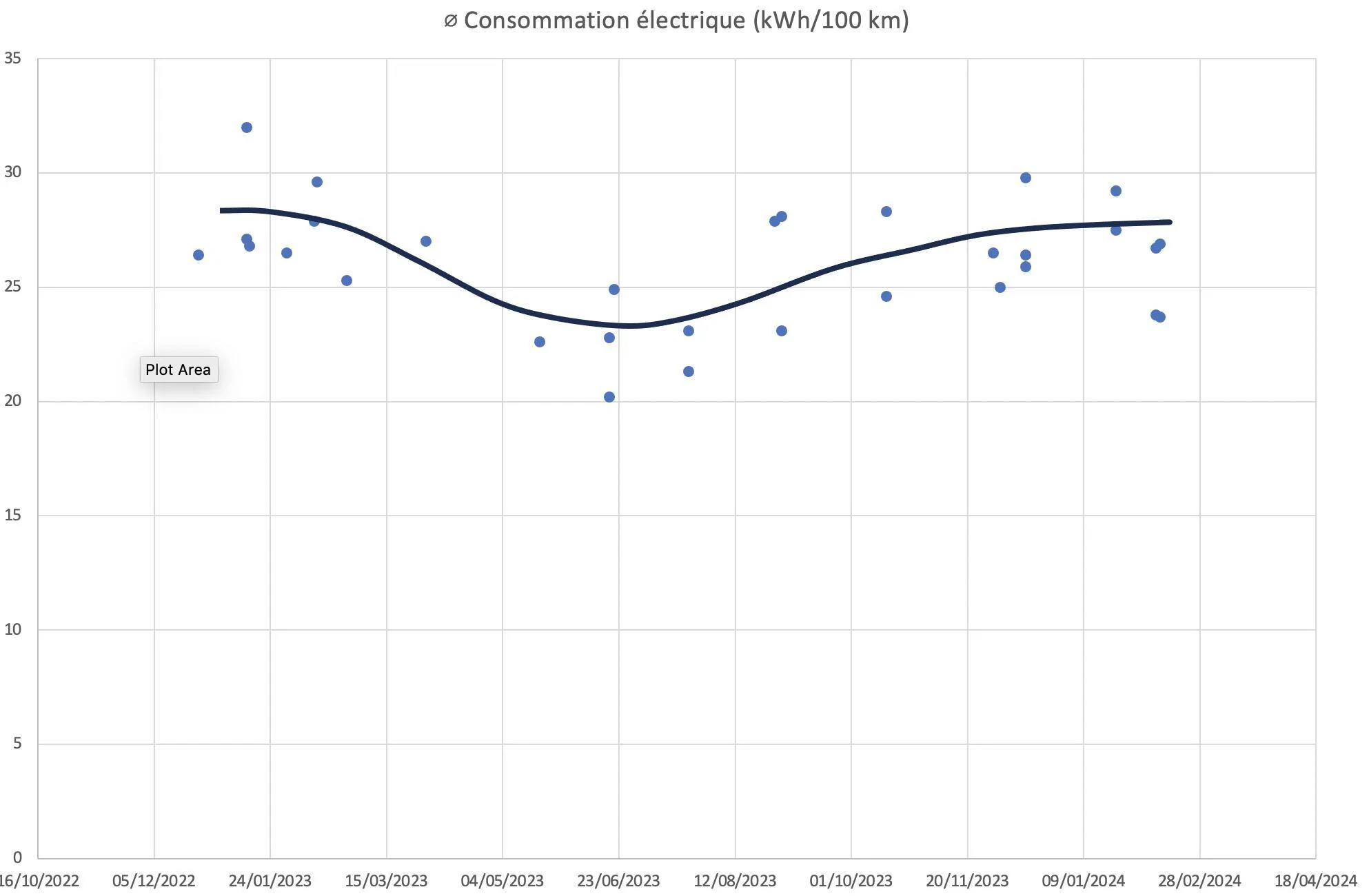

coming back to your initial post, I tried to plot the consumption for two sets of data:
- one for trips where the average speed is more than 120km/h/75mph for more than 160km/ 100mi. Difference between winter / summer is about 15 to 20%
Porsche Taycan 2 year ownership kWh Consumption Analysis Screenshot 2024-02-14 at 20.18.02
- and one for downtown where the average speed is below 32km/h / 20mph. Bigger difference here between the seasons: car stays outside and requires more energy (heating the inside and the battery) for short trips in winter
Porsche Taycan 2 year ownership kWh Consumption Analysis Screenshot 2024-02-14 at 20.23.18
My numbers are much better than yours.... thanks to 100km vs 100mi ? (but similar when multiplying by 1.6)

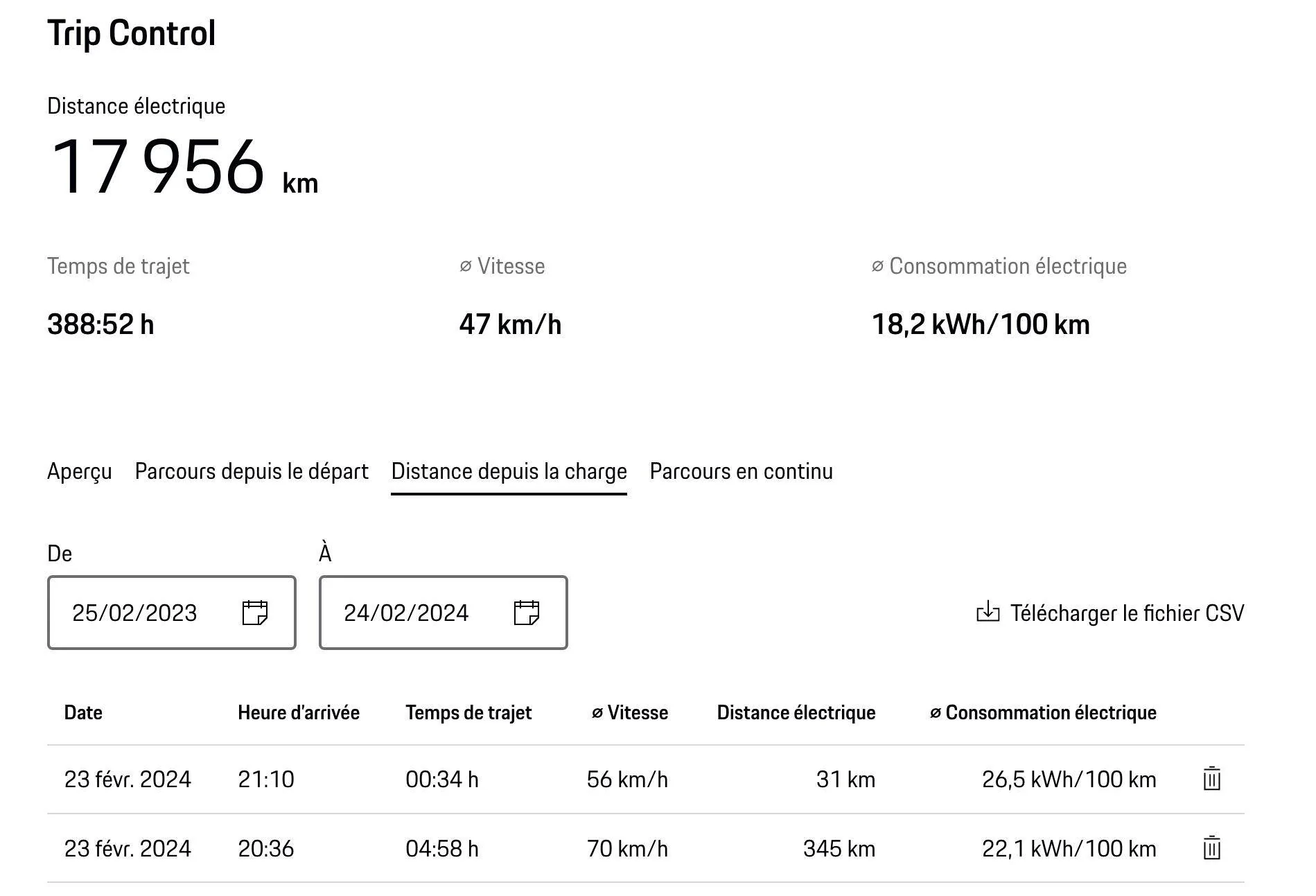

For mine (note it's in kilometers!) the trip control shows also an unrealistic, low consumption number of 18,2 kWh/100 km for the average over 17.956 km.
However the last ride numbers are accurate and reflect what I was seeing in the car. I know cause I checked yesterday when I chickened out after riding 345 km on a single charge on the highway. I think I would've made it, the car predicted a 3% SOC arrival.
Porsche Taycan 2 year ownership kWh Consumption Analysis Screenshot-2024-02-24-at-10-13-57
Reactions: Gru
