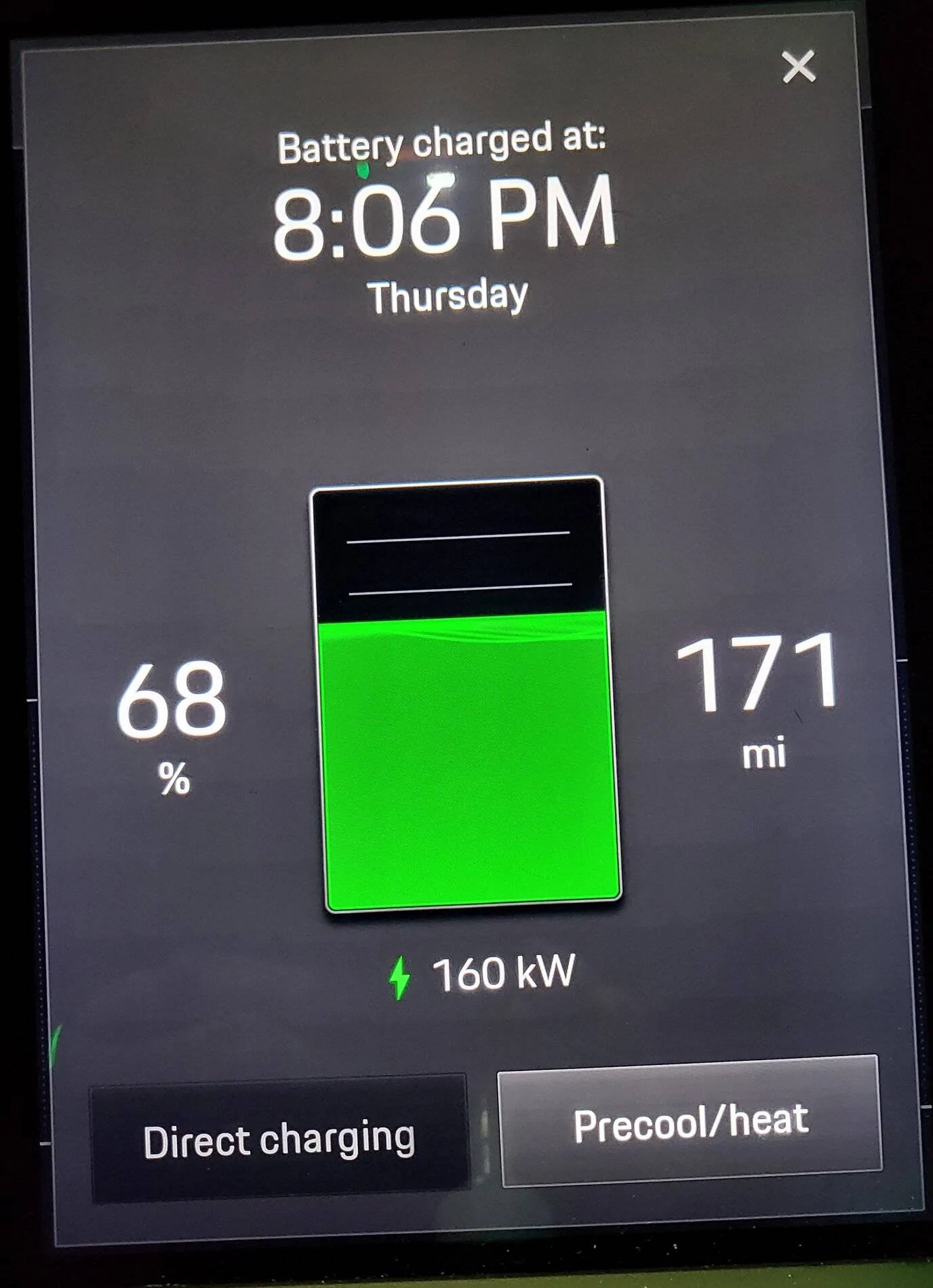

My car is currently in Connecticut where the temps have dropped, 44F at the moment. My car is parked outside. Tonight I went to a new to me EA station in Stamford Connecticut. I preconditioned and was at 13% SOC upon arrival. Great charging session. Peaked at 256kW and was still at 160kw at 68% SOC. For all the EA bashing on the forum, some of us have had positive experiences. I have yet to get stranded at an EA charger and I have owned my Taycan since April 2020.
I've rarely seen charge numbers like that.
