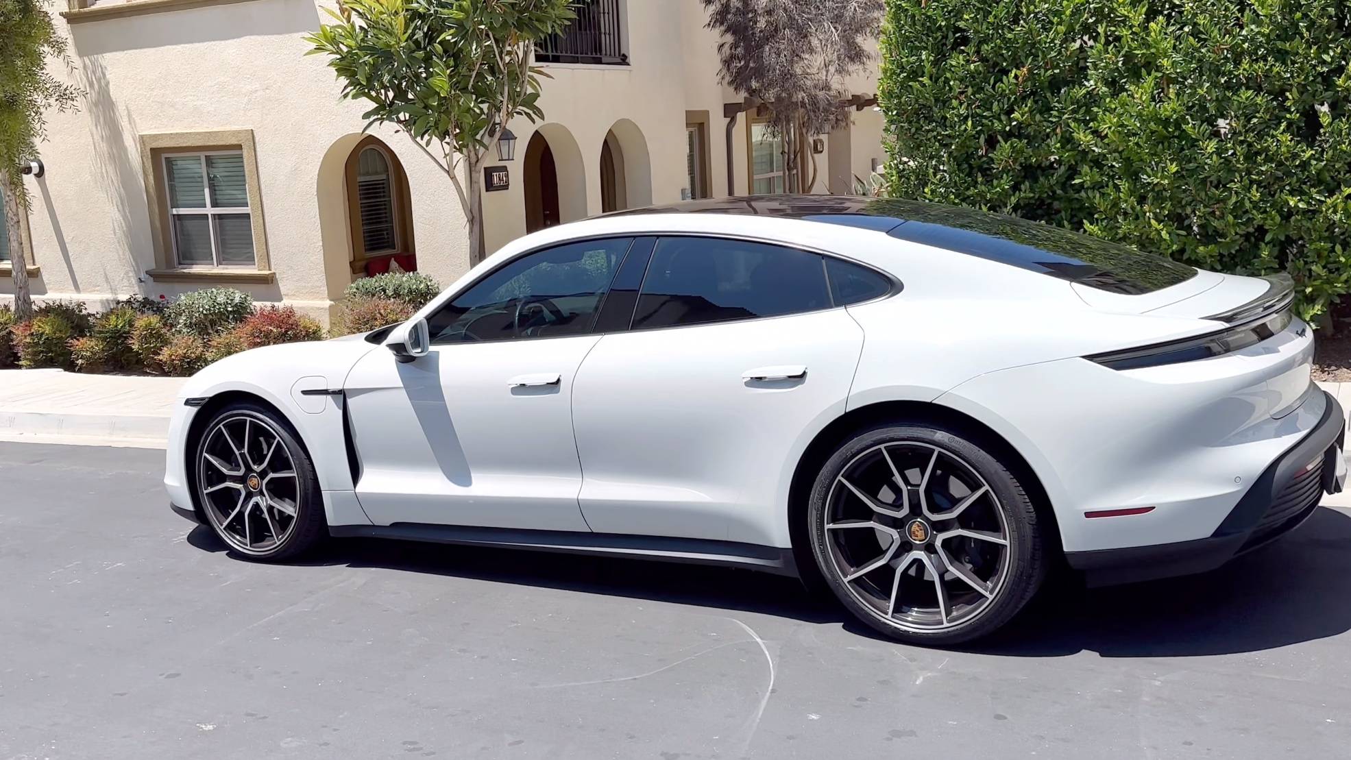

I love my 21”. When compared to my friends 19” & 20” Taycans, they regret not getting the 21”. If you want comfort, get EQS. ?
