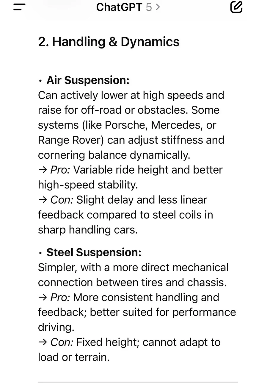

Turbo GT does not run on air. It runs on PAR, which does not rely on any sort of gas (“air”) to dampen the suspension.
Really don’t think this is up for debate, but just because you asked for evidence, i will respectfully point you to some. Take BMW X5, (which i also own with an air suspension option). You can only order it with air up-to m50. But X5M comes with steel suspension and no air option. Similarly none of the m cars have ever had it even though bmw extensively utilizes the technology in less sporty part if the range. Forget about smaller cars but bmw even did not put it the new m5 which would greatly benefit from the comfort of it.
Ask the simple question to any generative ai see what you get. A simple chat gpt ask around “compare air suspension to Steel”:
It very much has air springs in it. They could have gotten rid of them, but they did not.
Saying that a steel spring is somehow better than an air spring means knowing nothing about suspension. The air suspension leveling wise can always be made to be better than steel, the question is in mass producing and tolerances. When you mass produce an air spring, then it has a certain range of spring rates. If you need stiffer spring rate you need a different component. Developing this component for just one top end model is not financially viable. The only reason we can even have the VAG/PAG air suspension is due to economies of scale.
BMW X5 is a ridiculous example, it's a goddamn SUV. No idea about G series, but F series X5M has air suspension in the rear. That said, BMW's system is not at the level of VAG/PAG, never has been.
The reason that air systems are not used in smaller performance cars are weight and packaging, and the fact that you don't care about providing a softer ride, so the default is just stiff. Putting that into a SUV just means you create a SUV with a shit ride. Btw, quick search shows a ton of F95 owners complaining about the ride quality.
As for the rest - spamming ChatGPT is where I stop, since that is a waste of time.
Consider that I've been doing this stuff professionally for well over a decade, I am just not going to lower myself to that level.
The only reason the J1.1 RWD had steel springs is lower price. It does not perform any better whatsoever. It will not set a better laptime, pull more G on the skidpad or anything else of the sort, because unlike on a performance car the springs on the J1.1 RWD are soft.

PAR does not have air springs. Takes two minutes to check porsche website. I am driving but can copy paste the system definition when i get home. But absolutely no air/gas. The whole suspension is like a robot arm.
I used chatGPT because i am driving and you claimed “there is absolutely no evidence other than my personal observation” as if i am just making this up. Just coincidentally chat GPT makes the exact handling point that happens say the exact same thing? The point about X5 is it is ONLY excluded from the most performance oriented version.
I worked for an auto company for a decade. I heard this trade off hundreds of times i am just shocked you haven’t.
Just one quick reference i could find online:
https://www.pasmag.com/auto-knowled...on-in-performance-cars?utm_source=chatgpt.com
And to repeat i did not say “steel is better all round”. I said it is better in terms of handling precision and responsiveness. If it was not, do you really not think one, at least one high performance car manufacturer would not find a way to fit an air chamber in a sports car? The existence of gas in between rigid parts brings an element of unwanted uncertainty and wobbliness in purist handling no matter how you cut it.
