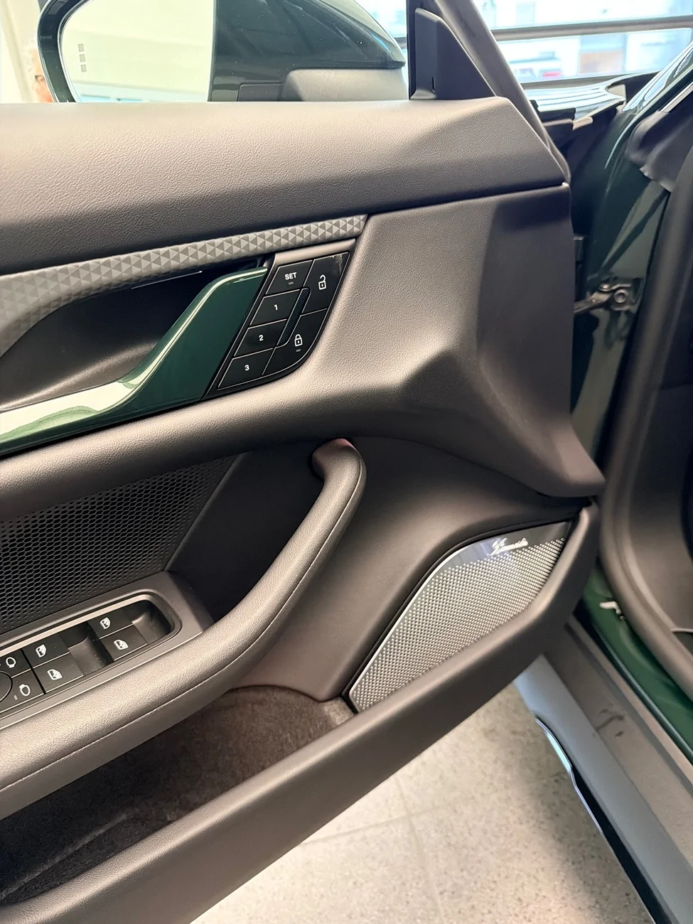

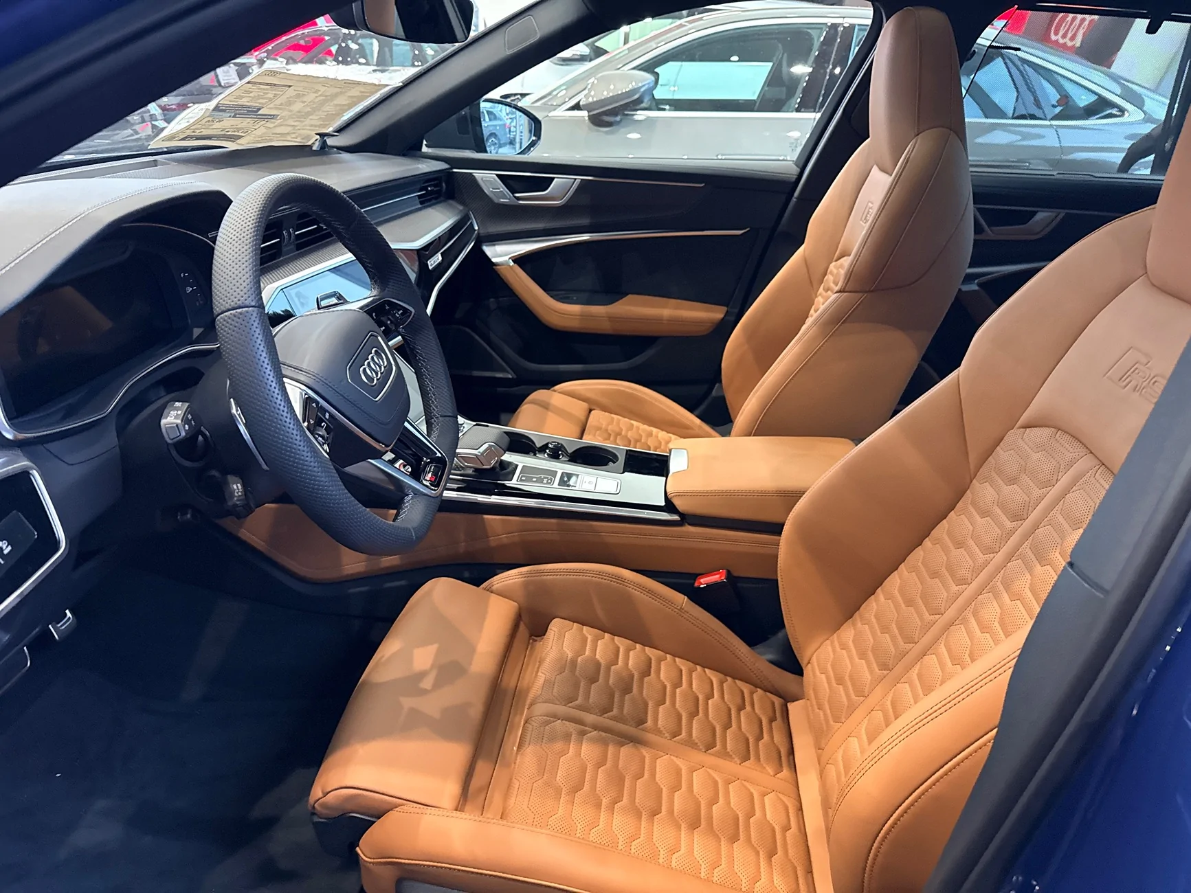

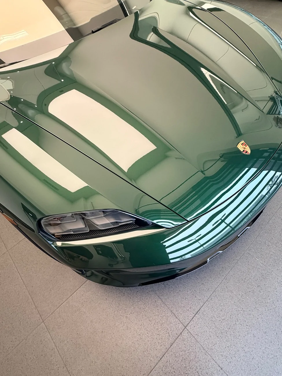

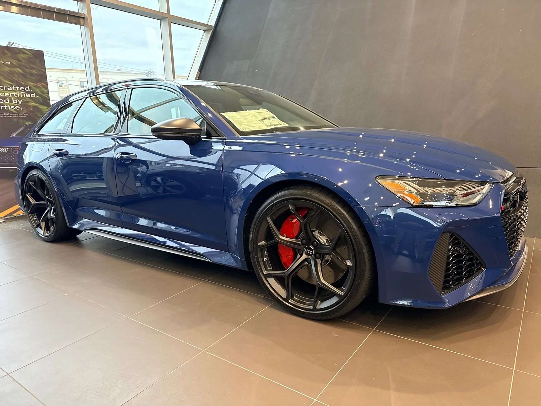

What an interesting post and the fact that the RS6 got involved. I just had an interesting experience. I am on my fourth Taycan since 2020. They have been incredible cars for me, I really wanted a change - so I tried out the RS6 Avant in DRC and it didn't work for me. Gladly, dumped it after 5 weeks and way to my next Taycan.... Here is a post that I wrote on the suspension on Audizine to compare my 1000 miles experience with an RS6 on Air vs. DRC.
https://www.audizine.com/forum/show...uspension-vs-DRC-(1-000-miles-real-world-use)
I did wind-up with a stunning Oak Green on Pepita .2 CT 4S. For context, I've owned for daily driving:
2020, Taycan 4S in Frozen Blue
2022, Taycan 4S CT in Neptune Blue
2024, Taycan Turbo S CT in Carmine Red
2026, Taycan 4S CT in Oak Green
As a chief digital officer and a car enthusiast. The face-life is truly incredible. I can see how all computer processing in the car is significantly better than the .1 along with the battery performance.
As someone with a back-problem, this is my second time trying an Audi in 2 years / failed and returned to the Taycan. The first time was going to an Audi RS E-tron GT. That was more brutal on my back ( seats and bounce) - than the RS6 on DRC.
Hope this helps someone.
