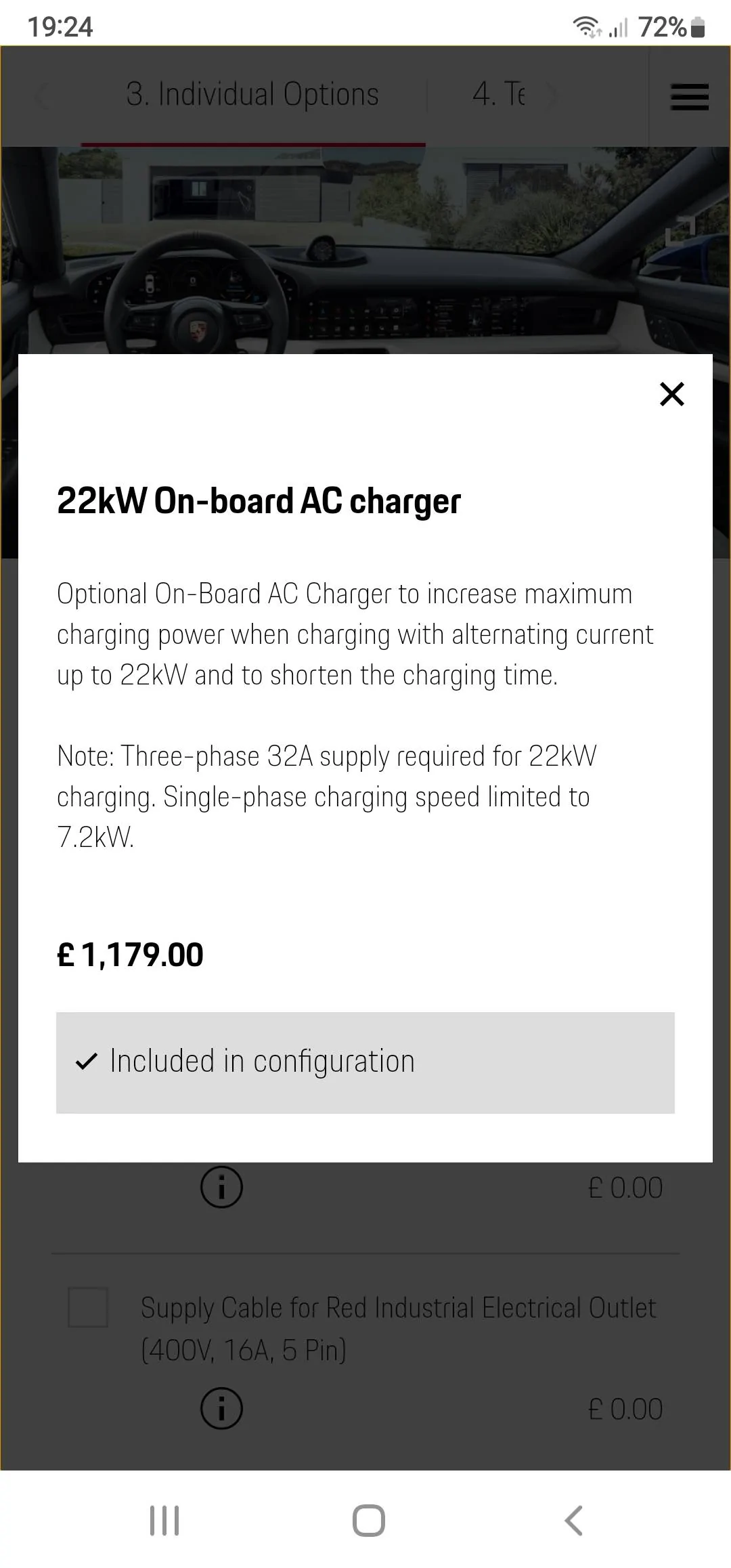

Screenshot from configurator today....Does this mean the 22kw charger issue is sorted on new cars so you can charge 'safely' at home on a single phase charger at home without dialling the power down??
Yes - no issue going forward.

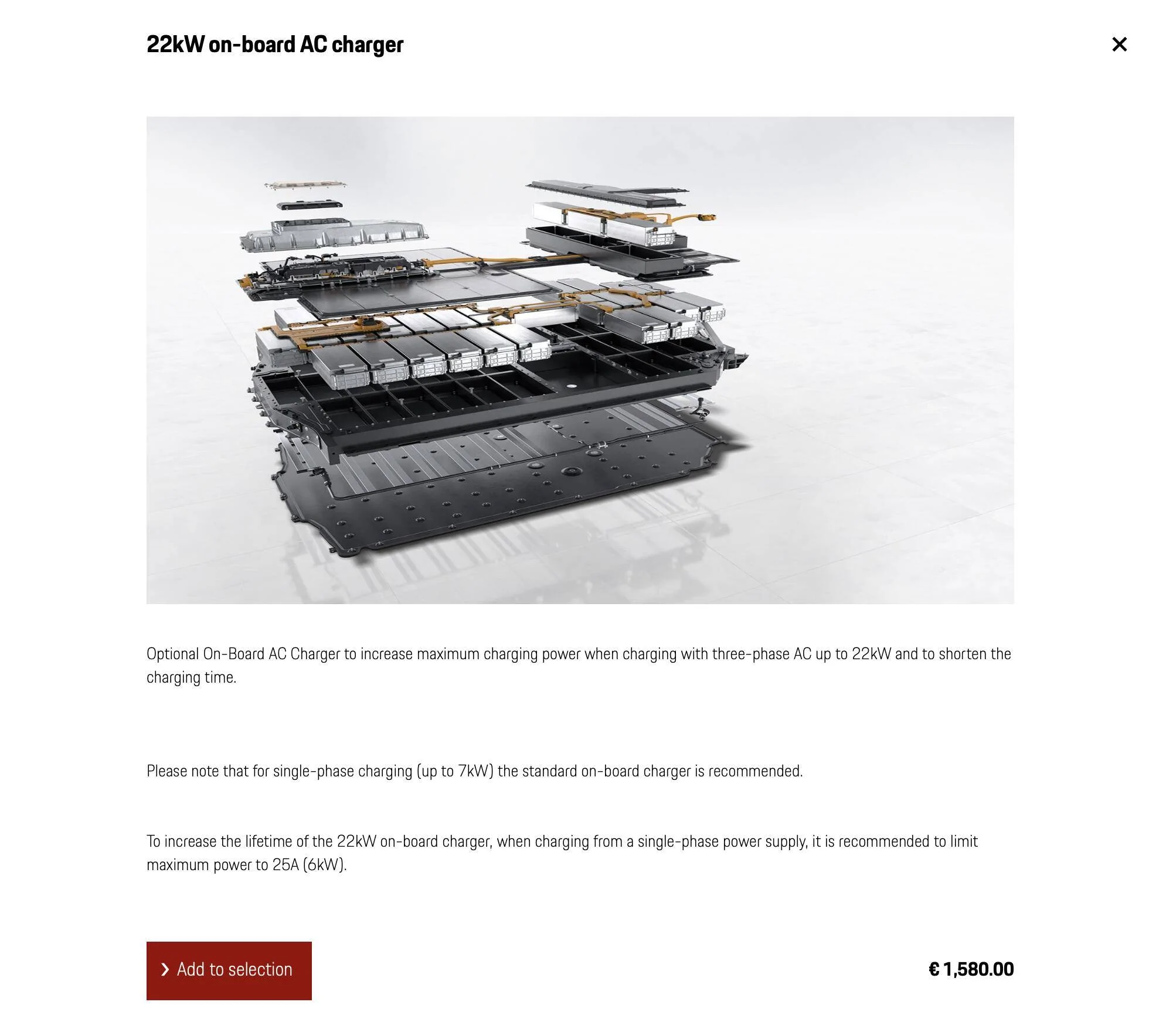

There is significant DC (>= 50kW) coverage. I don't have the 22kW AC option nor have I felt that I needed it in 16 months of ownership.
I don't follow your comment on the Tesla network as this only relates to the 120kW supercharger EVSEs which are 400V. To take advantage of these (if ever) you would need the 150kW DC 400V to 800V booster option.
Remember that the Taycan's standard AC charger is 11kW which will charge 50% faster than single phase 7.4kW when connected to say a 22kW AC EVSE.
Perhaps review the charging options in apps such as ZapMap to see the full extent of DC charging. ChargePlace Scotland dominate but many other options exist.
Always prioritise DC charging over AC for speed when on the road. AC is fine for overnight charging at home.
At the end of the day your choice but IMHO it would be the thing I'd be less likely to option on the car.
