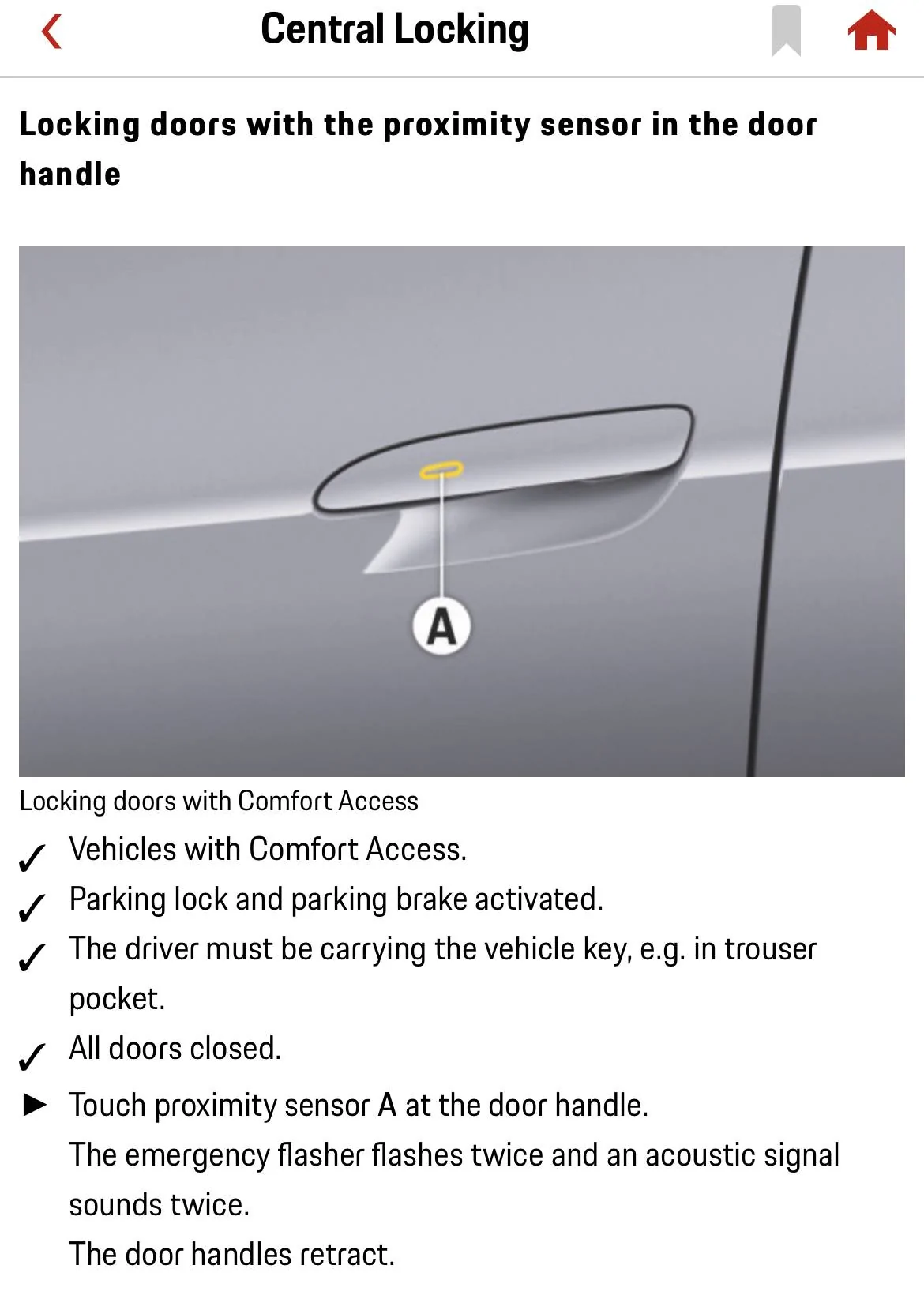

It will not lock when you walk away. Quite frustrating in the beginning but you'll get used to it.
mmm ok, so it just saves you one press of a button when unlocking, but you still need the key in reach to lock after driving. In undermines the full use case of just keeping your key somewhere on you (in a backpack or purse)
That explains why they did not explain it in the documentation. It just does not exist.
Coming from a Tesla, my wife is disappointed with the Taycan because she can not keep the key in her purse. And you know how much time it takes for women to find something in their purse, ;-)
Something for the Porsche To-Do-list !

You do not need to touch the fob when locking. It stays in your purse or pocket. You just touch a finger to the door handle sensor to lock with comfort access.
Thanks for the info (and sorry for the off topic questions). What do you mean with the door handle sensor ? So you open the door, move out, close the door. And then ? Push the door handle on the outside and it moves back in and closes the car ?

There s a small section of the door handle that contain the sensor. You push it and you re done.
Only works reliably with the knuckle press on a small depressed slit on the door handle. Also temperamental as it can unlock as you turn your back and walk away. So wait until the handles withdraw and lock. Still better than playing pocket billiards groping for the fob in your pocket.
Maybe for you but for me it works great with a light press of my thumb on the indented area. Using the driver door handle for locking is temperamental on mine because there is an issue from manufacturing. That is being replaced under warranty on my car this week so I expect the drivers door to work great from here on out too.
