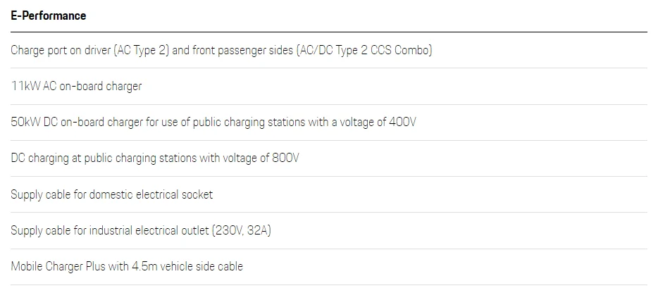

I see this on the configuration although I’m not entirely sure what it means. There’s chargers near me at a local library. 1x 50kw & 1x 22kw.
Is there something else I need to check?
This warning / guidance has been poorly communicate by Porsche but in essence if you only charge at public 22kW AC locations and have the 22kW AC onboard charger option then nothing to worry about BUT if you don't have 3 phase supply at home (to give you 22kW) and have the 22kW AC onboard charger installed then the advice is to configure your home EVSE to limit electrical supply to 7kW (or thereabouts) as it appears to shorten the life of the charger (@tigerbalm has had several bad experiences with his 22kW AC onboard charger in less than 1 year of ownership).

Cable wise: Standard EVSE (charger) supplied is the Porsche Mobile Charger Plus and is supplied with 2 supply cables and one cable to connect the EVSE to your car. The basic supply cable is the 13A 3-pin plug (same as your kettle, tv etc) but do not use this as you will get glacial charging speeds - emergency use only and if you take your charger with you on weekends on a 'just in case' basis. The second (and preferred) supply cable is the 32A for an industrial type socket) and will support up to 7.4kW (single phase). Be sure to get an electrician to do the supply from from your fuse box to where your EVSE will be located and they will install the correct socket.
