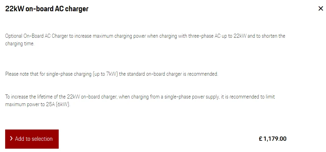

From the configurator when choosing the 22kW on-board AC charger:

Screenshot from configurator today....Does this mean the 22kw charger issue is sorted on new cars so you can charge 'safely' at home on a single phase charger at home without dialling the power down??
Porsche Taycan 22kw option for UK Screenshot_20220508-192411_Samsung Internet

Still looks broken to me.
£1,179.00 is the same price as before.
7kw is fast enough for any home charger. Destination chargers faster than 11k are rarer than electric 911s
You only need a 22kw charge speed if you leave for work 4 hours after you get home.
Spend the money on a glass roof, or ACC, or special paint or……..
anything useful!
Isn’t 7.2 kW the maximum for single fase charging anyway? 22 / 3 = 7.33 kW.
In Belgium 1 fase 32A = 7,4 kW
3 fase 16A = 11 kW, 3 fase 32A = 22 kW.
Wasn’t the original warning advising even lower watts on one fase?
And I don’t know if single fase chargers with more than 7,4 kw exist. But I am not an electrician. Would be nice to know when traveling and using public chargers.
Btw what happens with the standard on board charger on a single fase 7,4 kW. Will it charge 3,6 or 7,4? 11/3 = 3,6?

Single.phase - 7.4kW
