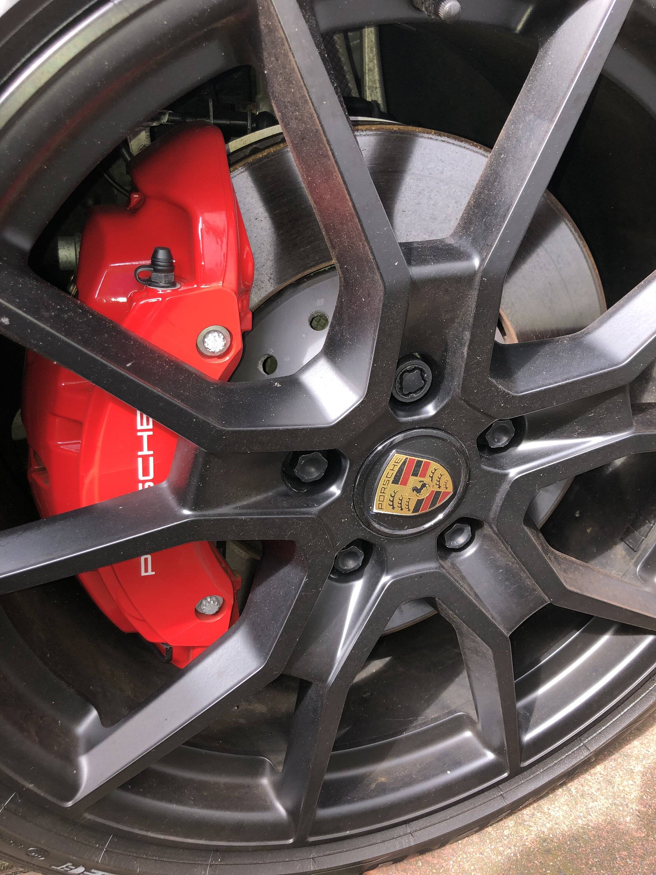

The basic brakes are absolutely brilliant. There is no functional benefit to upgrading on a Taycan.
The discs look fine and red callipers are the best especially with black wheels.
Actually, there is less / no brake fade with PSCB than standard iron discs.
Performance therefore is better.

You've had brake fade with those vast cast iron discs with 6-pot calipers on a road car which uses mainly regenerative braking?
I presume you mean doing long runs on track days?
Fade is temperature dependant and as far as I can see the cooling ducting isn't changed with different disc choices, so from a technical pov a bit baffling to read that.

I just read the notes from the Porsche Engineer who created PSCB a few years back and other reviews. The brake pads are also of a different design apparently.
I think you'll be surprised come your 2 year service just how much your brake pads have worn - in my case much more than I'd anticipated given the high reliance on recuperative braking.

The choice of brake pad material makes a big difference to pedal feel and temperature sensitivity.
We had 3 different pads to use with cast iron brakes for different circuit layouts and the complete brake set was different with composite brakes with material density and cooling holes varying depending on requirements. The best braking and feel has the highest wear.
I have noticed on my car that the brake pads wear quite a lot when cleaning up the discs each time I set off and before regeneration kicks in. Because I mainly do short journeys I had already assumed pad usage would not be negligible.
