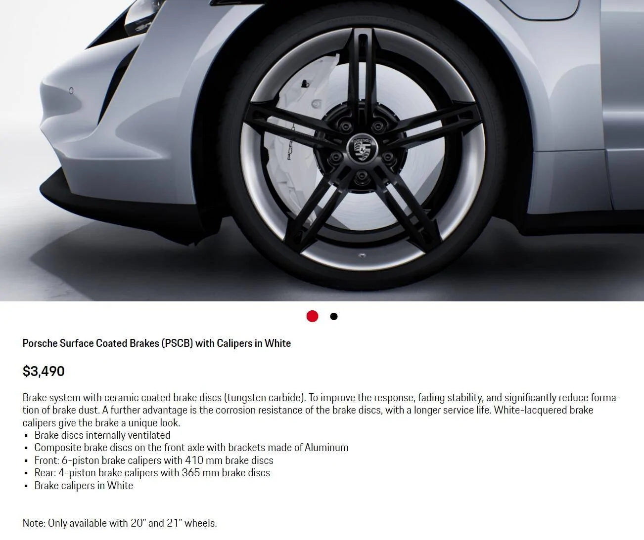

I have the standard brakes on my 4S but have the PSCBs on my GTS ST - step change IMHO.
This is exactly what I was looking for, someone who has experience with both on a Taycan! Sorry, I'm not familiar with the phrase "step change", does that mean large difference? If so, different in what aspect?

I have PSCB on my GTS ST and think they are well worth the cost. No rust - they get a polished reflective surface over time.
This is the main (only?) benefit from the PSCB - shiny brake discs so no rust!
This is what they claim below. I like them for the following reasons on the Cayenne and will have them on the Taycan:
* Larger than Standard (Black) iron brakes
* No rust that I noticed
* Look like a mirror after 10k miles
* 31k miles and no service is called on them yet
* I like in White color
* High Gloss Black $900 option seems steep, but we do not make the rules
-> Would like to learn their un-sprung weight vs. Standard (Black) and vs. Ceramic (Yellow)
-> Only issue I have is some known squeaking (on Cayennes) but this has not been confirmed by any Taycan owner with these brakes to my knowledge
IMO yes.
Cast Iron has ideal friction characteristic for road car brakes because the friction coefficient varies less with temperature than other materials I have data on.
After many years of development we got composite brakes as good but they are extremely expensive - the big gain for racing was weight (more overall than unsprung, the chassis dyno didn’t show a big gain in wheel load fluctuation with modest reductions in unsprung weight).
I believe the main objective of the plating of the discs is no visible rust and I suspect there is no substantial improvement in actual braking from them - for road driving anyway because they are hardly ever used.
Brakes can be a massive source of improved lap time in racing so I spent my decades in racing trying to optimise them for friction, cooling and wear. Porsche know about brakes and I am 100% sure the standard brakes are better than most makes supply.
I wouldn’t be prepared to pay extra for the options on an EV with mainly regenerative braking personally.
If you prefer the look enough to pay, any of the braking options and caliper colours are worth it, of course.

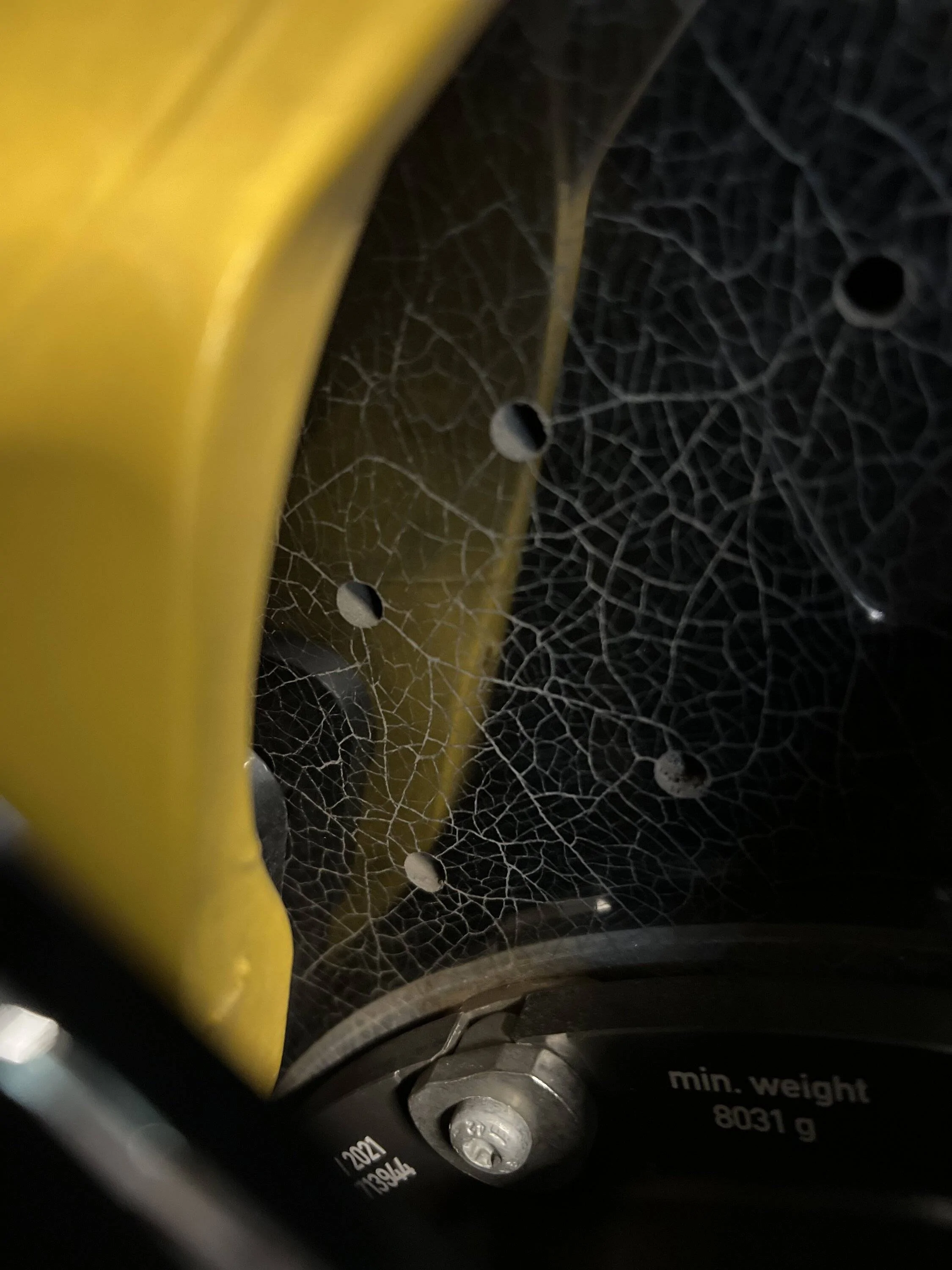

Huge beautiful grey disks are on the PCCBs.
Porsche Taycan '24 GTS ST Build Feedback 56C875B7-9904-40E1-81FC-4B7D8F8B4CF8
Sidicks
Jan 30, 2021
1,031
744
Kent
Indeed. I had them on my GT3 but not needed on the Taycan.
