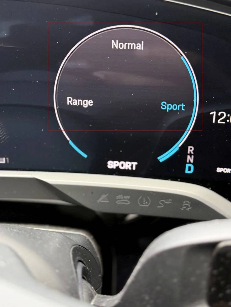

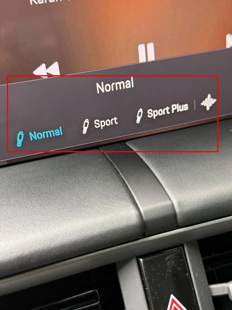

My 25 4s does not have Chrono package but I do have a drive mode selector dial which shows Range, Normal and Sport modes. But when I change the drive mode using the dial, the infotainment screen shows Normal, Sport, and Sport Plus. I can then simply touch Sport Plus mode on the screen.
Is this a software glitch? Not sure why Dial doesn't show Sport plus but the screen does. See photos:

The screen message is the damper setting (but the full drive node), it flashes up so you can change the damper or toggle sport sound just after you change mode with the wheel. My car works the same.

This is common confusion since both are named Sport+, but mean different things:
Driving Modes are: Normal, Range, Sport, and Sport+ only with Sports Chrono
Air Suspension Modes are: Normal, Sport, and Sport+ (which is what the OP is showing), notice the suspension shock graphic, and since this is a 25, Air Suspension is standard.
Therefore, the OP does not have Sport+ Driving Mode, but has Sport+ Air Suspension Mode, which is to say that this is not a glitch, but exactly how it should be for your setup without Sports Chrono.
