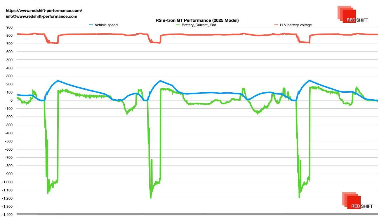

After install of our new ECU, the customer was able to log some data of his car during multiple 1/4mile runs and here is a graph visualizing the measured vehicle speed, HV battery current and voltage over time.
Porsche Taycan Redshift Performance - Updates & News - J1.2 Platform Unlocked for Tuning! Redshift_Performance_2025_RS_etron_GT_performance_upgrad
The third run resulted in the highest peak power number as the battery slowly warmed up after the initial runs. The peak current delivered by the battery at this run was right around 1205 Amp and the pack voltage drooped to 715 Volt which is normal and expected due to the battery internal resistance at these high current draws. We measured the quiescent current draw of any auxiliary systems at standstill before each run and subtracted this from the battery power delivery.
At its absolute peak the HV battery provided an astounding power of around 861kW and 1150 horsepower to the electric propulsion system on both axles. These are quite impressive numbers compared to the manufacturer provided 912 hp and 680kW in overboost.
These runs were taken at colder battery temps and battery voltage was not quite at maximum so we believe that there is still some more room for improvement.

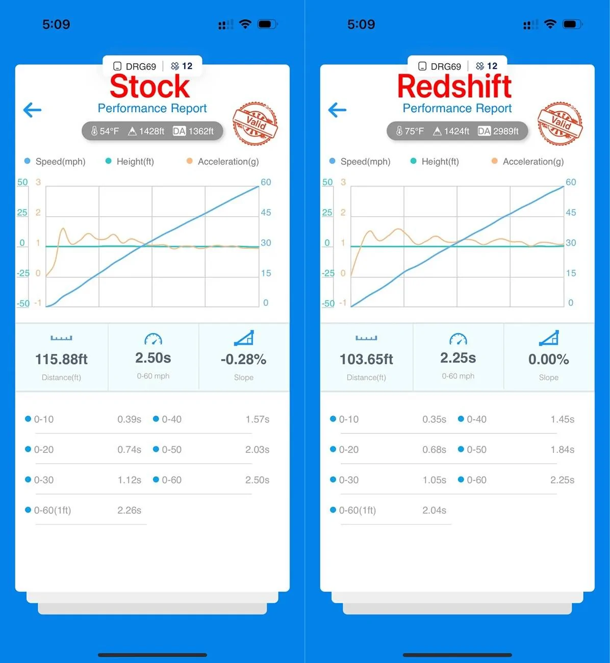

The customer also compared 0-60mph times which resulted in some very impressive gains after our performance upgrade!
The manufacturer quotes the power from the motors, not the power drawn from the battery. These two things are not the same. The power from the motors is a lower number, because the powertrain can never be 100% efficient.
For example the J1.1 Turbo S draws over 600 kW from the battery, to produce 580kW power from the powertrain.
Writing it like this is misleading - you can not compare two numbers where one is powertrain output power (supplied by manufacturer), and the other number is power train output power plus powertrain loss.

@prj Thank you for your interest.
The referenced manufacturer numbers are provided as point of reference for people unfamiliar with the new RS e-tron GT performance models. We do not declare our numbers as anything other than peak power delivered to the electric propulsion system. The results speak for themselves as pointed out by other forum members.
