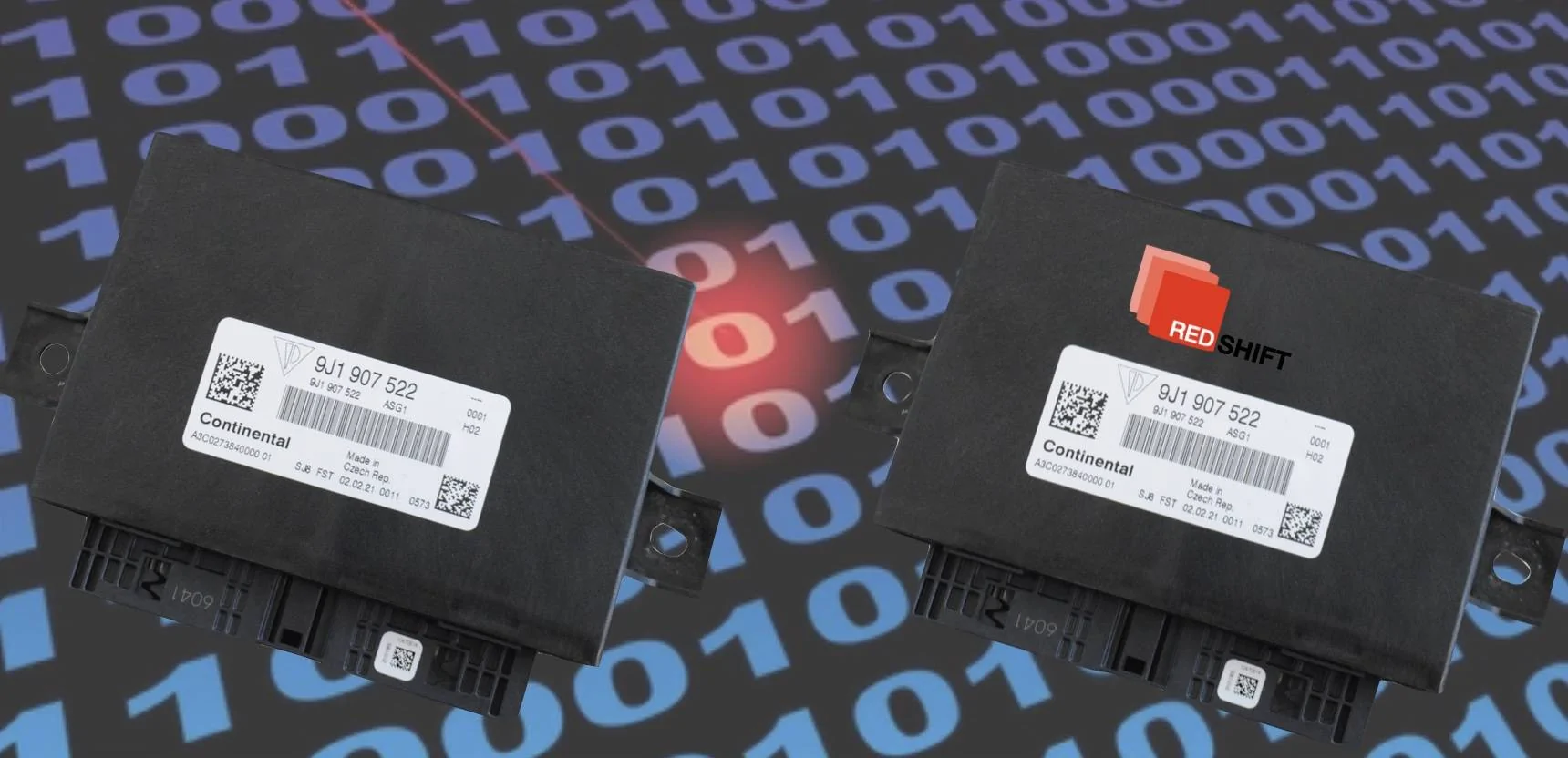

Hello Forum,
We are proud to offer secondary/clone ECUs as an optional package to all of our Taycan & e-tron GT performance upgrades!
This allows our customers to retain the original (untouched) electric drive control module (ASG) and have a secondary module with our programmed performance tune to swap in when needed. Both modules are plug & play and can be swapped in 30minutes or less.
We added a short manual about this on our website: https://www.redshift-performance.com/ecu-clone
Please contact us at [email protected] for more details and to place an order.

Is there a difference in part number of the ASG whether it is a base Taycan or a Turbo S? Or do all Taycans share the same base ASG produced by Continental?

@Rik_CT4s they are all the same part number, only difference is software and coding.

Is the ASG coded to my specific VIN?

@redshift-performance , is the cloned ASG a new part or a reused part (like the ones you can buy on ebay for $150-300)?
@whitex
The cloned ASG that you receive from us is a brand new part from Porsche which is where the main bulk of the additional cost comes from.

The cost for the secondary ASG is $800 which is mainly the cost of purchasing the new module directly from Porsche. If the customer wants to supply their own secondary module please contact us at [email protected] for more detail.s

The ASG has vehicle specific parameters coded into them that we need to apply to the cloned module to make it compatible.
Does this mean I can resell to another Taycan Turbo S owner?
No.
As per post #10, there is vehicle specific info coded to the unit.
You could leave both with the car, or eave just one with the car etc. But it's only of use to another car as a "blank" to be programmed.
