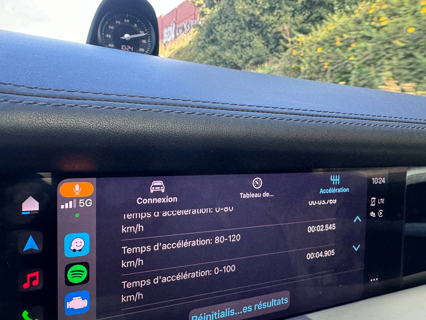

You can use CarsScanner app if you have an OBD dongle to measure the 0-100kmh (or 0-60mph). It is a cheaper alternative vs the draggy but fairly accurate.I thought the Draggy app required Draggy hardware.

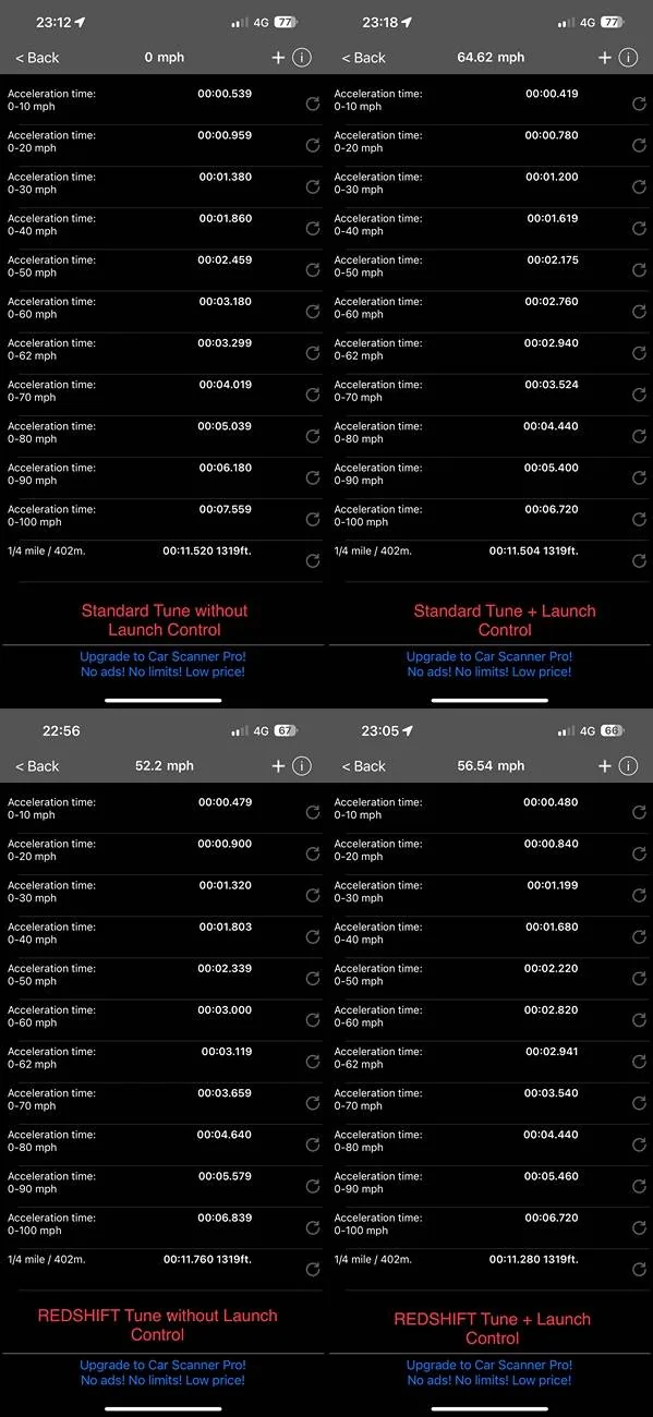

Did the car get slower with the Redshift tune, or am I missing something?Just posting my performance results after installing a secondary ECU with the REDSHIFT Stage 3 tune.
Car: 2020 Taycan Turbo S
Mileage: 11,764
Battery SOC: 70%
Ambient Temperature: 14 degree C
REDSHIFT Stage 3 options: 800+ bhp, no speed limiter, unfiltered throttle, increased regen power
Driving impressions: Car pulls hard and instantaneously with launch mode ferocity from all speeds - thank God for the head restraints! Increased regen is very noticeable. Previously I could coast to a stop at junctions and lights but now I stop short unless foot remains on throttle. Definite increase in ‘engine braking’. Snappy throttle response at all speeds and drive modes but easy to drive smoothly. Nose lifts under extreme acceleration. Don’t recall this previously.
Here are my before and after numbers …
I hadn't noticed the annotations before...it looks like it at least in some areas ?Did the car get slower with the Redshift tune, or am I missing something?
Without launch control the car was quicker WITH the ECU tune from 0-60 by 0.18 seconds.Did the car get slower with the Redshift tune, or am I missing something?
You have to keep in mind Launch Control also controls tire slip for maximum acceleration. Even on my lowly RS e-tron GT, I spin more without launch controlDid the car get slower with the Redshift tune, or am I missing something?
Did you manage to try it again with higher battery %Without launch control the car was quicker WITH the ECU tune from 0-60 by 0.18 seconds.
I concede that with launch control it appears slower but the battery level was lower at that point along with other conditions being less favourable.
I had intended to do another speed run with the RedShift ECU but never got round to it. Will try again when the weather warms up!
Not yet. Hopefully this week as the weather in the UK Is about to hit 18 degrees C ?Did you manage to try it again with higher battery %
