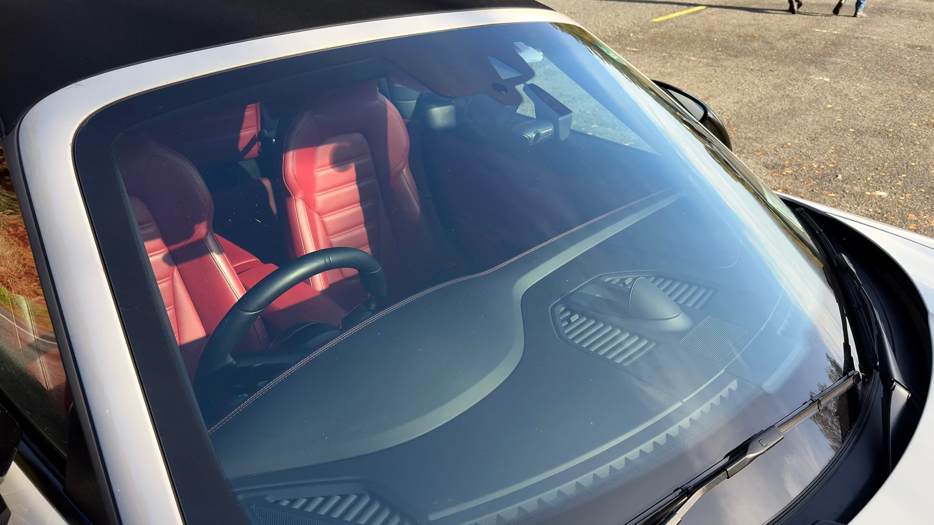

Porsche Taycan A short Porsche Dashcam review IMG_9320
The camera is much more prominent compared to the FitcamX. However, it is not terrible. I am finding myself able to live with it. I think having a right-hand drive vehicle actually does help. The camera naturally "wraps" around the rear-view mirror more so than if the wheel was on the other side.
I could imagine tucking it up a little more towards the roof line – but the installation instructions from Porsche insist on placing it where mine is. I think the main reasons for that are:
  1. The black part against the glass houses a GPS receiver and they want it a clear view of the sky.
  2. The front facing part houses a radar to enable remote parking cover.
  3. They want the lens to be in the centre of the car as much as possible.

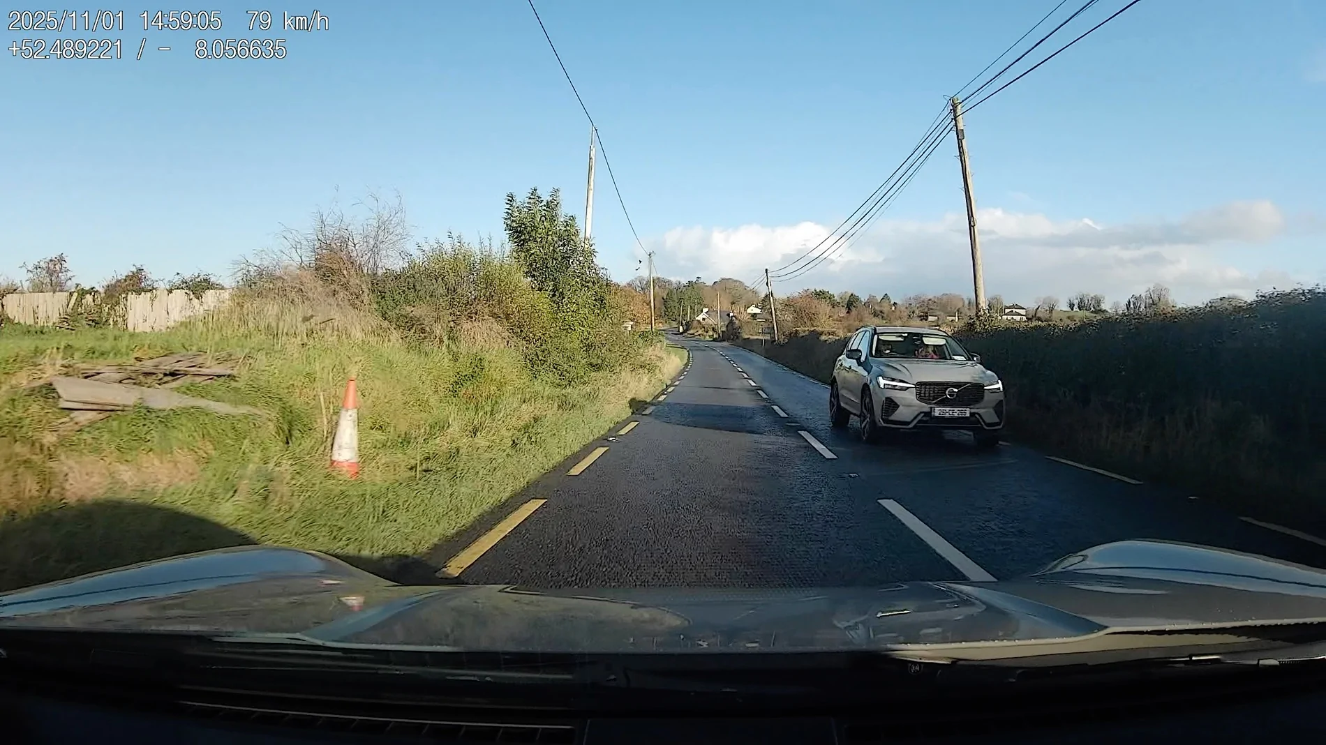

Thanks for the review. There are some good aspects on functionality I didn´t know.
Dissapointing is the framerate and the resolution, as I could not get any license plate readable from oncoming traffic. Even roadsigns are hard to read. That´s a true bummer.

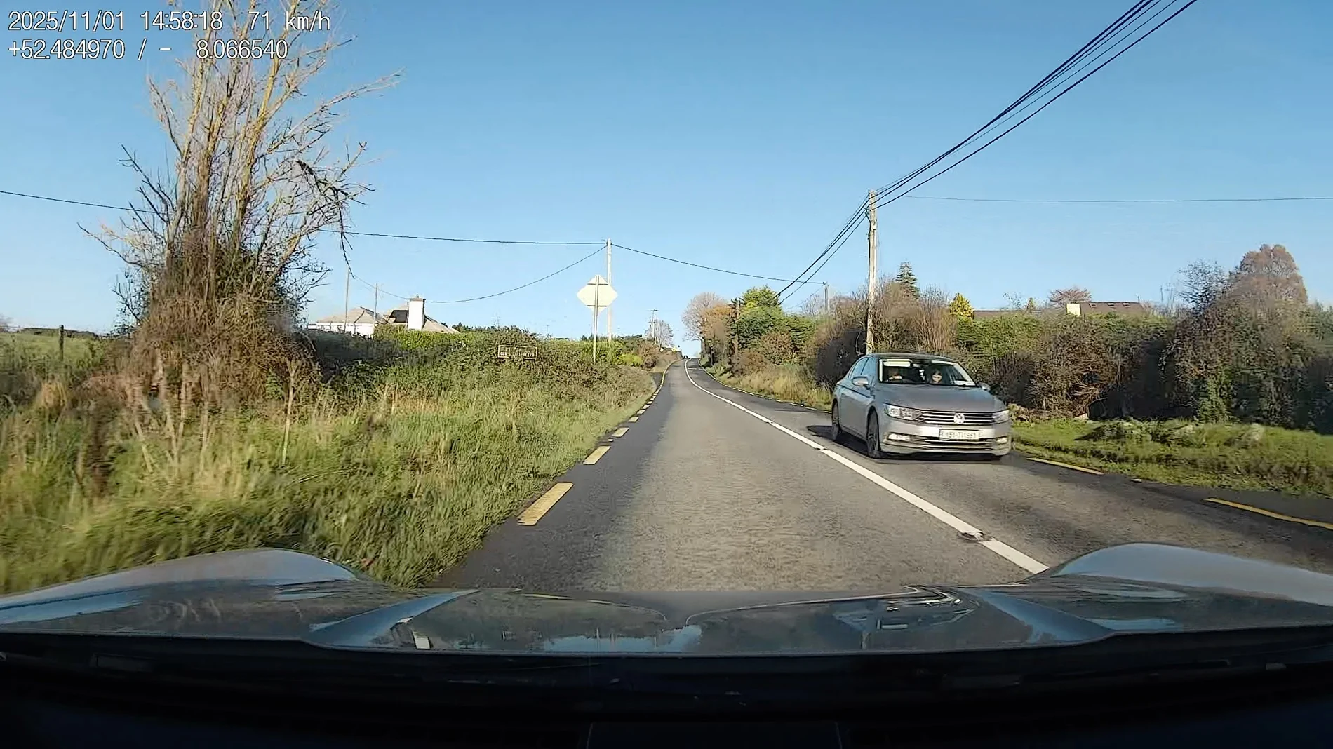

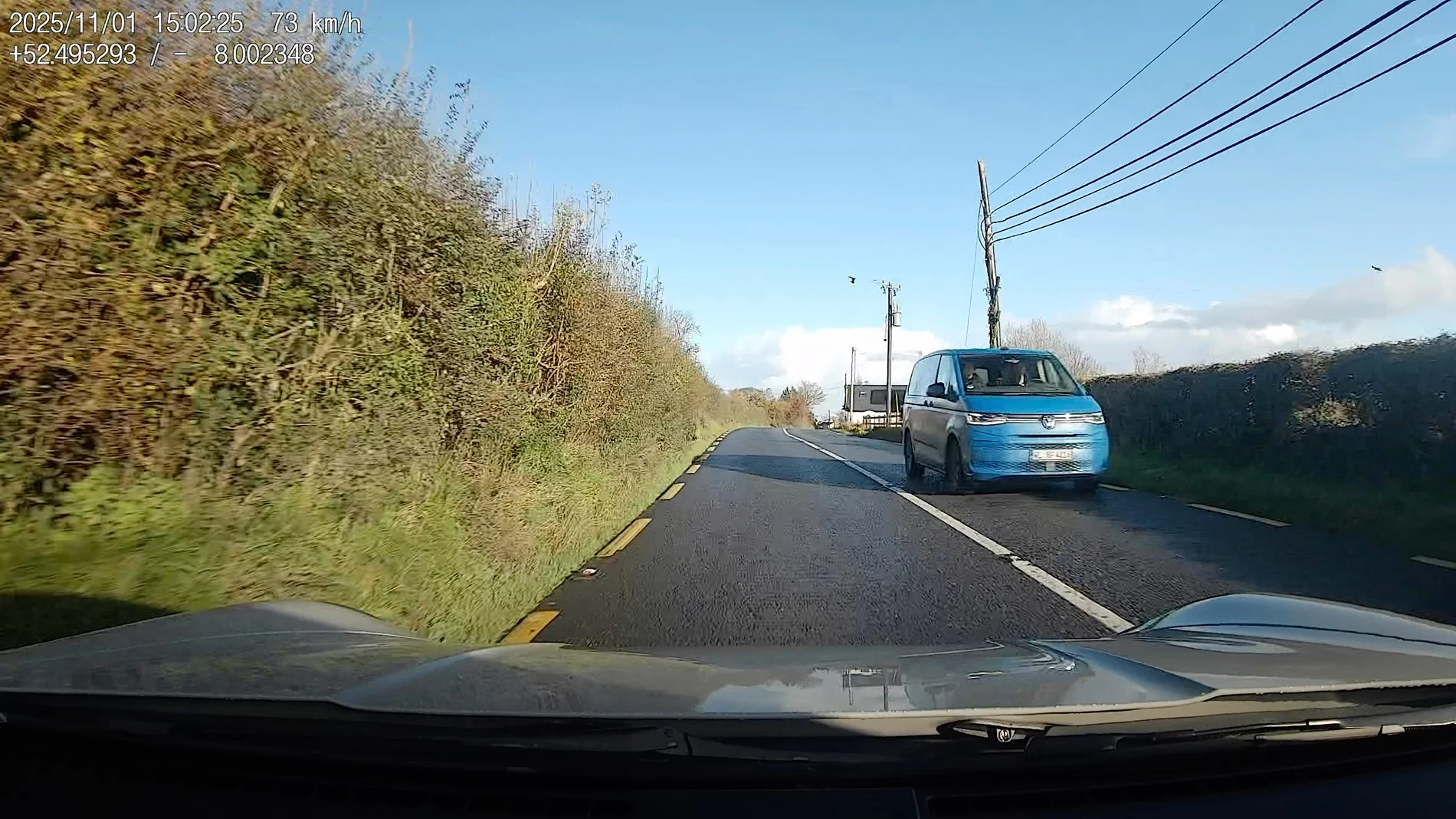

Took a look and I do think the original video is slightly higher quality than the YouTube encoded version.
Sometimes the registration plates are readable with a bit of zooming in.
Porsche Taycan A short Porsche Dashcam review Number plate at speed
But more often than not they are too blurry due to frame-rate (30 fps) and video definition.
Porsche Taycan A short Porsche Dashcam review Blurry imag

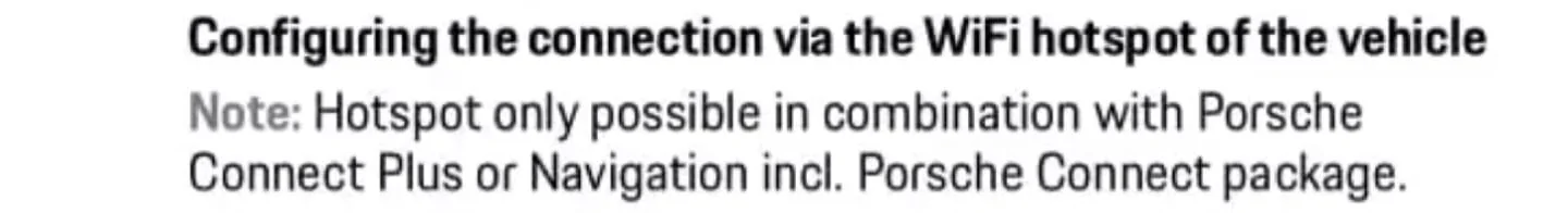

The camera is happy to connect to the in-car wifi network. Meaning that instead of acting as a standalone wifi hub, it is just a device on the network. You can even see its internal IP address if you go to the PCM –> Connectivity -> Wifi Hotspot Devices.
Got myself excited and then disappointed again: it doesn't work unless you pay Porsche their monthly ransom money.
Given it doesn't use any external service and just the in-car wifi hub hardware, that is really surprising. I'm planning on keeping Porsche Connect – so it won't be an issue for me – I actually get some use out of it – but still very surprising. I wonder how it even knows!

You can use the camera just fine without integrating it to the pcm. It’s just a bit more to remember then that you have to disable carplay when downloading footage and so on.
Maybe it's an Android thing, but staying connected to a non-internet wifi when there is a more preferred wifi network nearby is already tricky. But then having a paired Android Auto device around makes it just insane.
Disable Bluetooth to try to avoid Android Auto to connect and after some seconds it will just auto-enable it again and connect to it with both wifi and Bluetooth.
I think i now found a combination of putting it into flight mode and then re-enabling wifi that made it kind of work.
But still way too cumbersome to make good use of the dashcam. And all because Porsche decided to be lame for no technical reason.

I had mine mounted like you did; with the lens centered (which is not where the install TSB recommends.). It's better there and mostly hidden behind the rearview mirror for the driver.
I have discovered a couple of important things about this dashcam:
1. You must either disable carplay or get the wifi package if you want to access the camera over wifi.
2. If you use a 256GB SD card, the cam will get confused and start recording nonsensical dates and ruin your ability to retrieve footage. I went down to 64GB for this reason.
