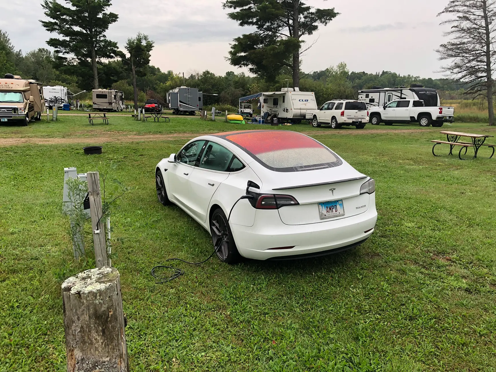

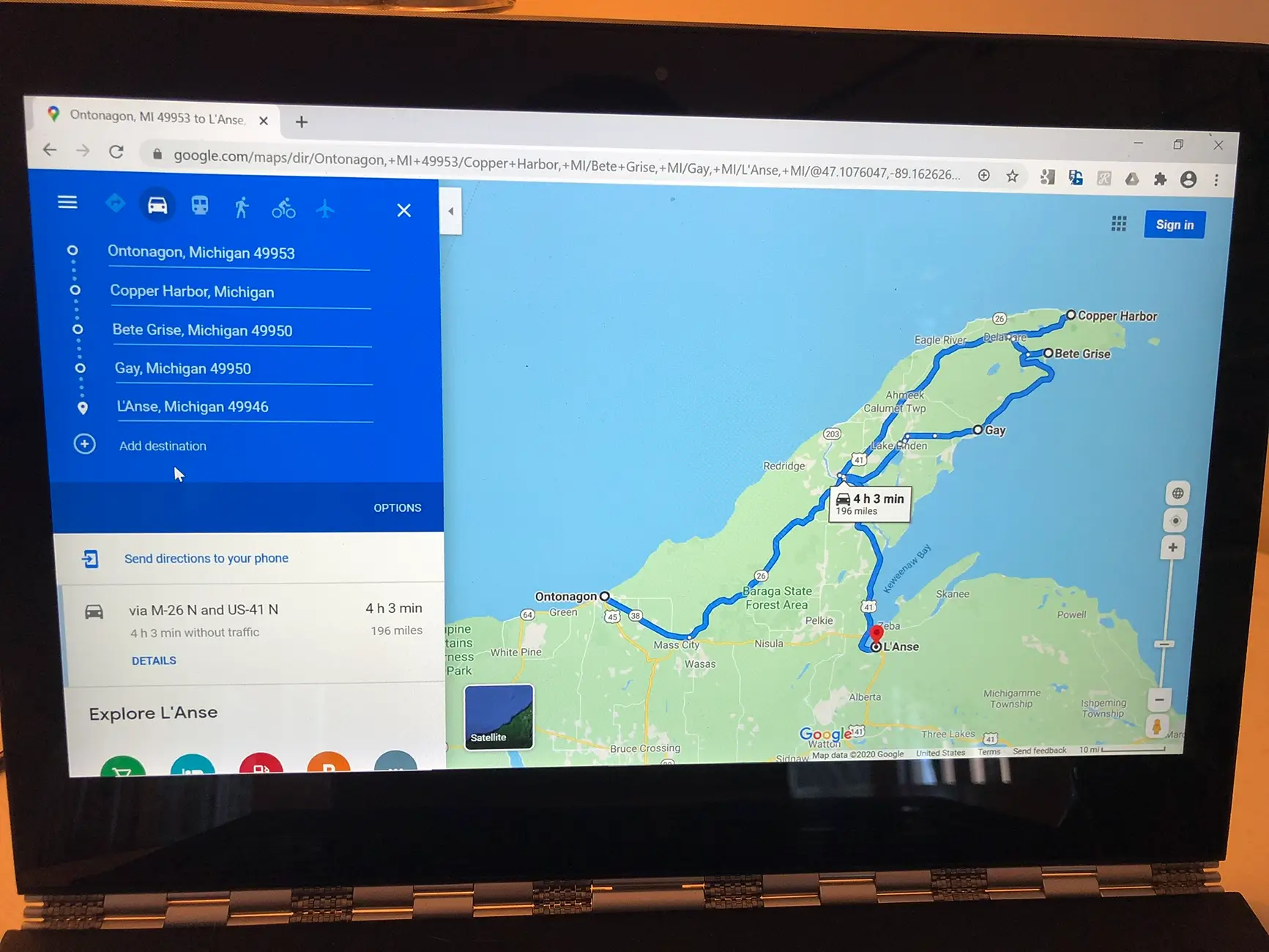

in 2021 I did a road trip with friends along the southern shore of Lake Superior - similar route to yours, I'd bet. Basically Ontonagon to Sault Ste. Marie (and then to near Petoskey MI).
At that time there were NO DCFC stations along our route, so I charged overnight at campgrounds - yes really.

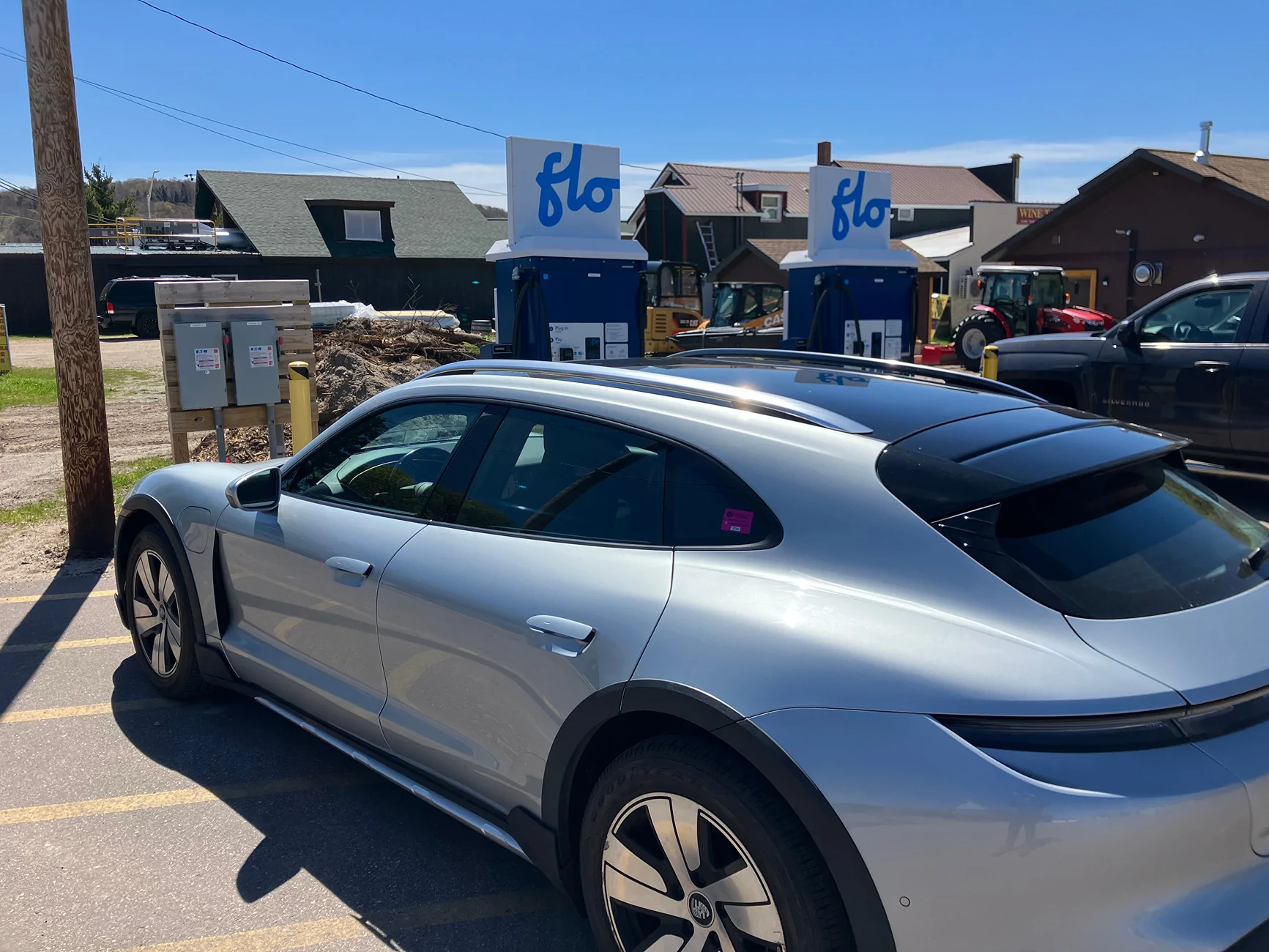

Porsche Taycan May 2026 Trip, Massachusetts to Minnesota Roundtrip (3100 miles) IMG_0241
above: Flo DCFC station in Munising, MI.

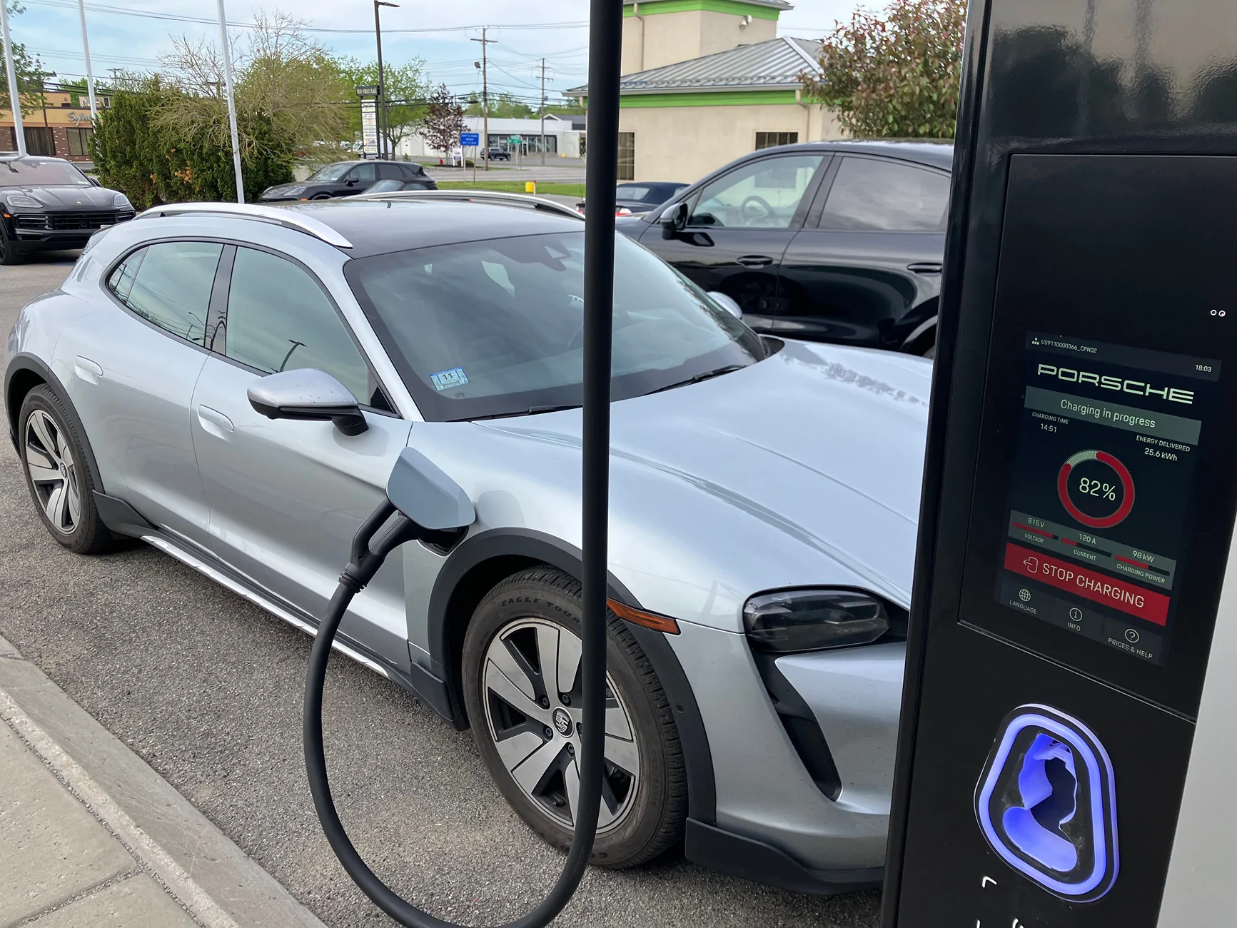

Porsche Taycan May 2026 Trip, Massachusetts to Minnesota Roundtrip (3100 miles) IMG_0458
above: charging at Porsche Buffalo.

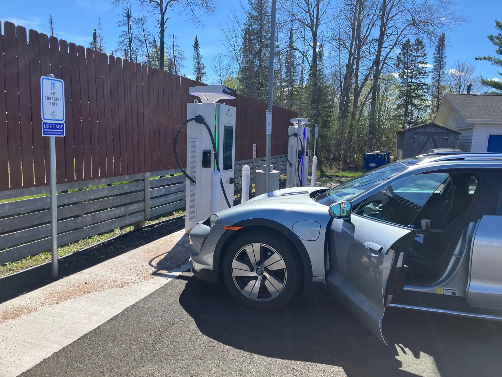

Porsche Taycan May 2026 Trip, Massachusetts to Minnesota Roundtrip (3100 miles) IMG_0137
above: charging at Francis Energy station in Brule, WI.

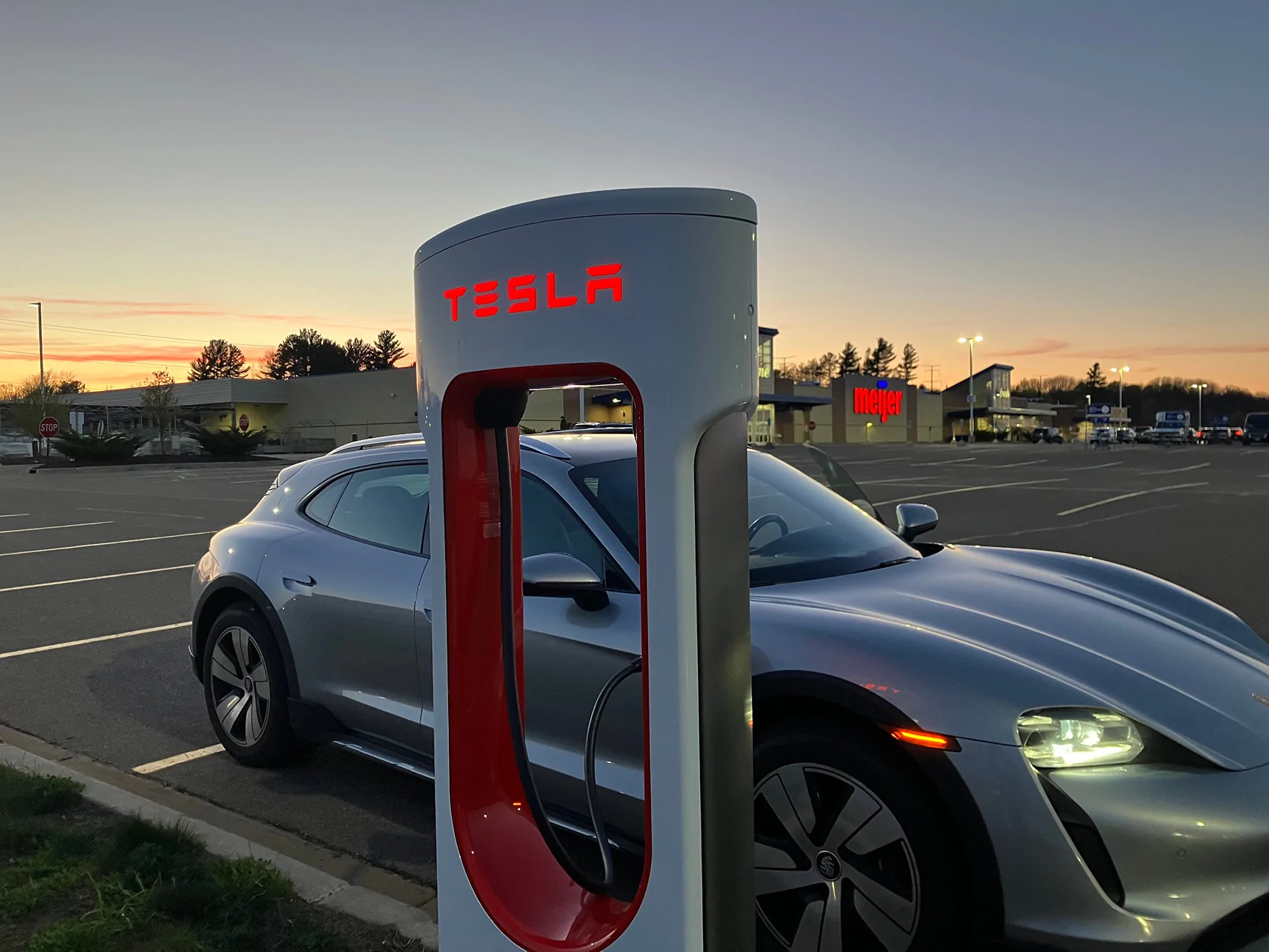

Porsche Taycan May 2026 Trip, Massachusetts to Minnesota Roundtrip (3100 miles) IMG_0170
above: Tesla Supercharger, Marquette, MI

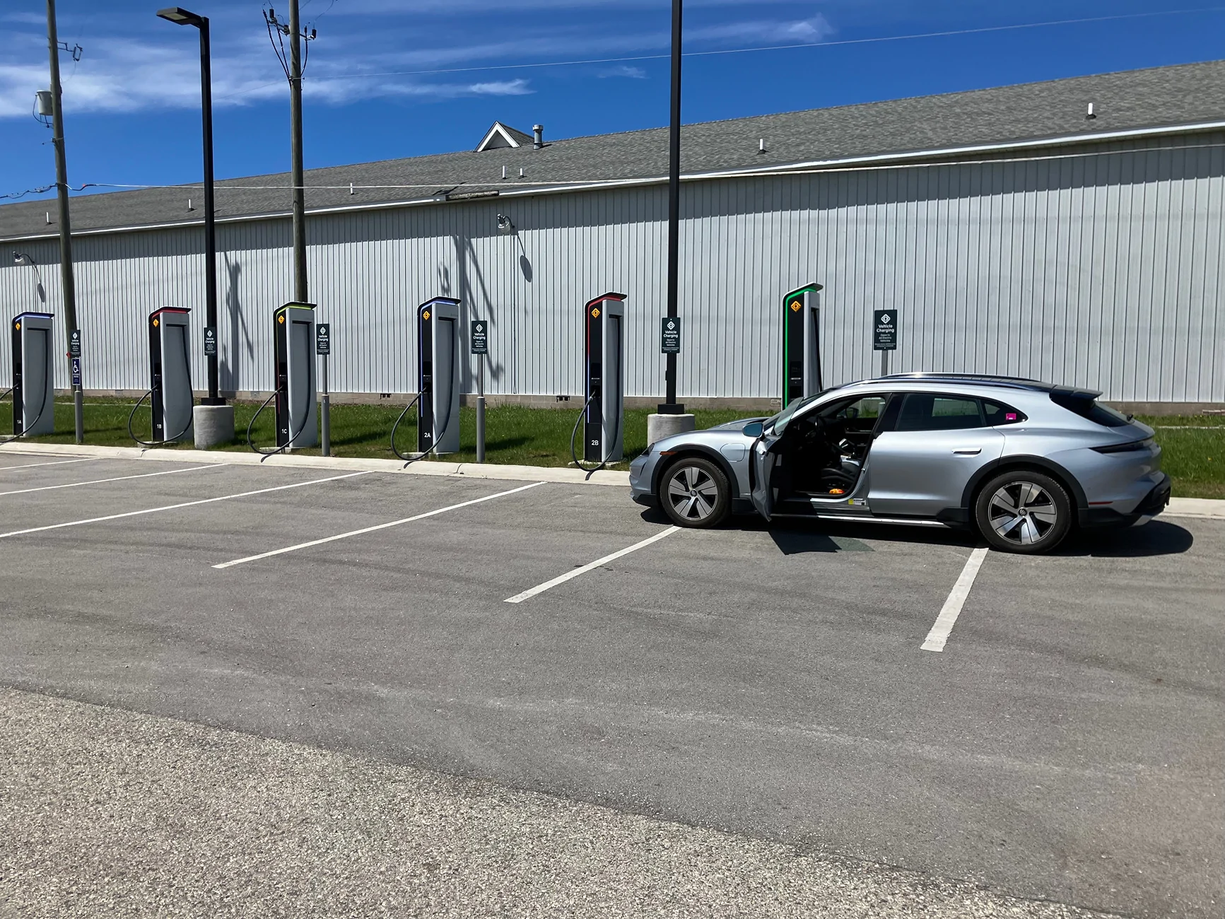

Porsche Taycan May 2026 Trip, Massachusetts to Minnesota Roundtrip (3100 miles) IMG_0092

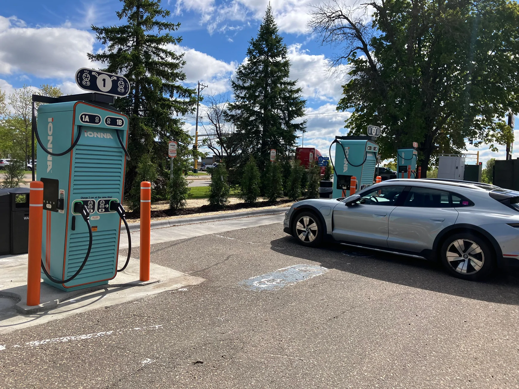

charging at Ionna station in Lino Lakes, MN.
