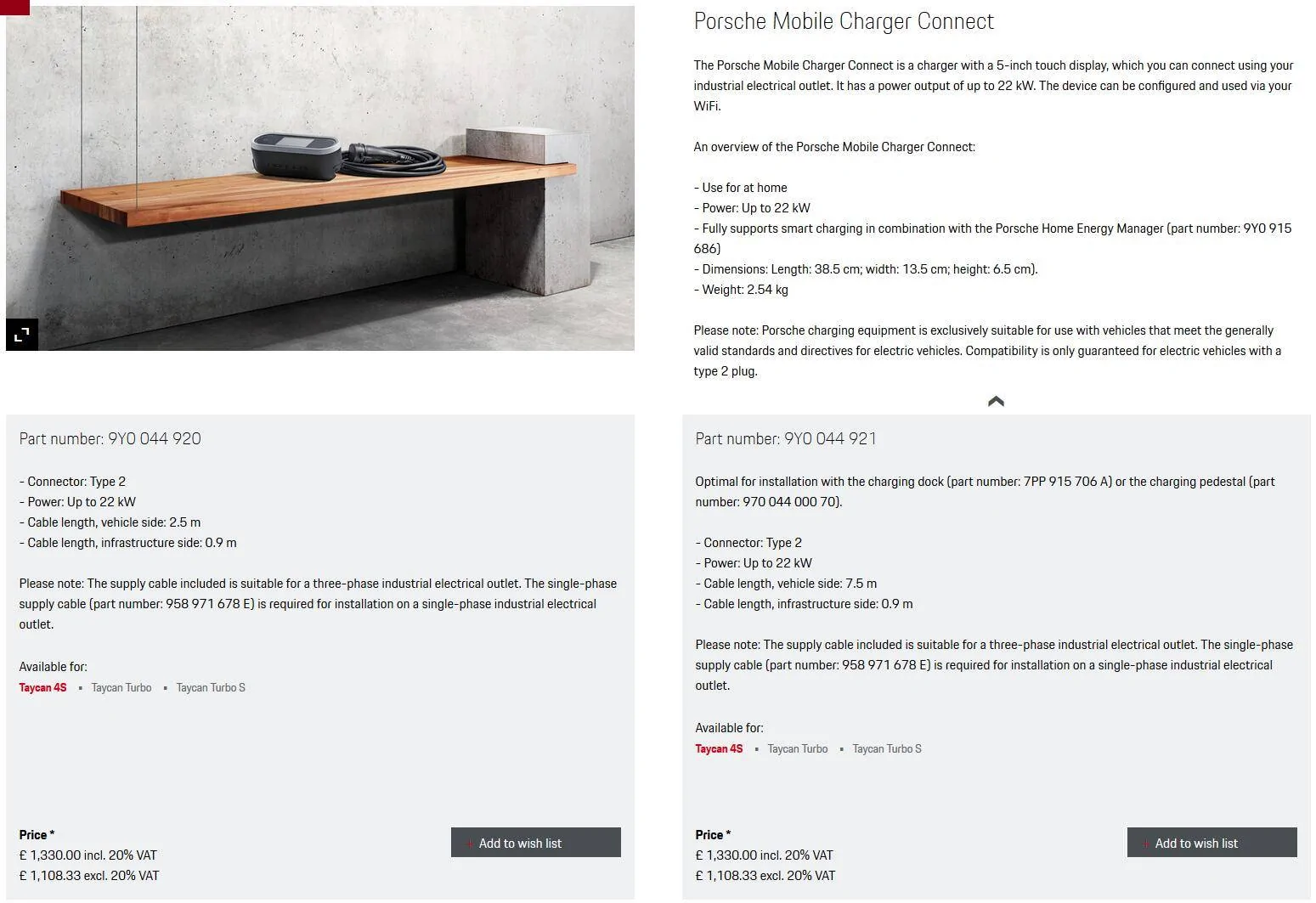

You're right. If this is the true pricing, it is ridiculous. I found the option pricing "ok" but 3225$ is mad.
I found the charger connect on Porsche UK site in the Tequipment section for a more reasonable price. I did not find that offer on the US site at all. The offer includes charger AND cables.
