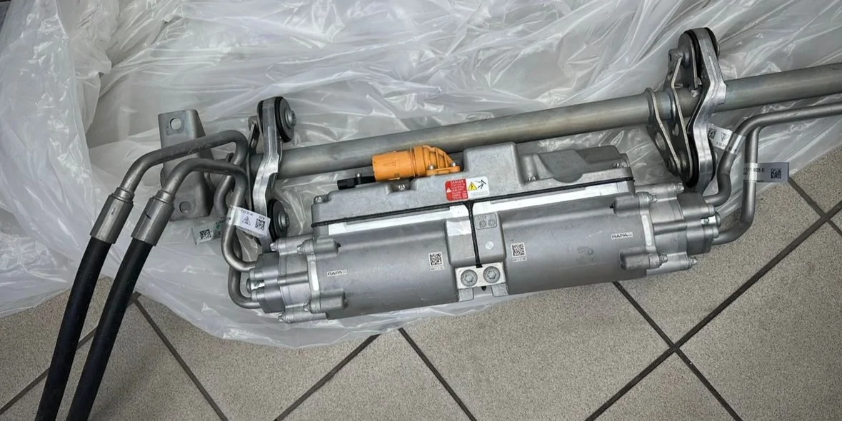

Service advisor just informed me that Porsche AG will only release the part (rear servo PAD 511881) in w49. Six weeks from now. Seven since ordering. It's bad.
So to everyone's surprise, the parts have arrived today (w46.2), much earlier than originally advised. Assembly Wednesday, delivery Thursday. And hopefully i can return my Oak Green Macan 4, because it has made me miss my Taycan a lot.

Apologies for the belated follow-up. I got my car back as scheduled, but I had limited opportunities to drive it before i had to embark on whirlwind business trip in China. So this is an intermediate update.
Here is the servo replacement part:
Porsche Taycan Active Ride failure WhatsApp Image 2025-11-13 at 11.26.34

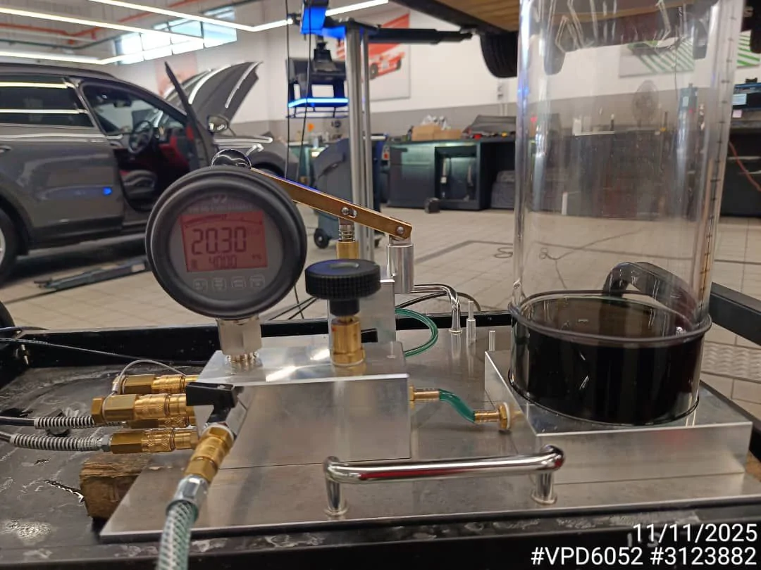

The warranty allowance for this operation is 5 hours according to the service mgr.
The swap involves refilling the hydraulic circuit with hydraulic fluid which is unique to Active Ride and happens to be black.
Porsche Taycan Active Ride failure WhatsApp Image 2025-11-13 at 11.26.35
So how is it ?
First of all, immensely better than the Macan. The difference is so striking. Driving position, damping, acceleration and throttle response. It really isn't a 10% thing. The Macan treated me to 6 weeks of what felt like riding a rubber rodeo horse, mushy and bouncy. Also speed bumps. The small nasty ones to stop cars to a crawl at gates or in alley ways, which rock the whole body when taken at an angle. Wiped out. The uncanny wonder of a sway-bar-on-demand.
And is it better than before in terms of my rear axle wiggles ? Yep, quite so. I would have wanted to put more mileage on before rendering that verdict, but it is quite clear that it is far better. The roads that used to induce pendular lateral oscillations are now a lot more quiet.
I am still a little reserved, because i do not find Normal mode perfect, for instance when passing crests in curves, but overall, i can do my entire commute without being reminded to switch to Sport mode, and this is massive progress.
So my verdict thus far is that the replacement of that rear servo makes PAR on a Cross Turismo a whole lot more convincing than it was. Which in turn raises the question of the US press cars that were written about in C&D and Motor1, and a condition that would then be ... epidemic ?
