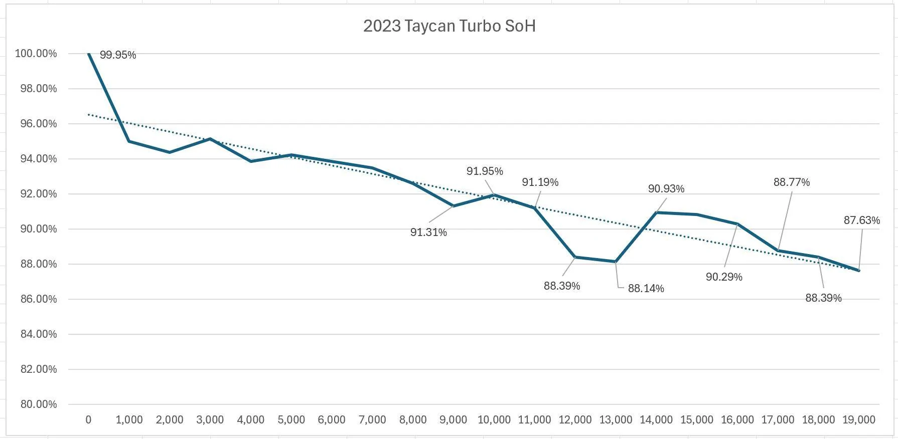

Doing some research on CPO Taycans before pulling the trigger on one and came across a comment from about 6 months ago that surprised me. Is the statement above saying "10% reduction in battery SOH is to be expected in the first 10,000 miles" accurate? I drive a 2023 Ioniq 6 and after 24K miles my battery's SOH is still 100% and have seen no decernible reduction in range. Battery SOH is something that I will be checking as I look at cars, but a 10% drop in only 10K miles seems drastic for any car, especially one that costs more than twice what I drive now.
We have overwhelming evidence on this forum from real world data that the 10% drop in 10k miles is true for Taycan, but then it levels off around 85%-88% and stays there assuming all cells are healthy. Please see my degradation vs. miles graph that would be consistent with most, so I expect it will stay at 85% or above for the rest of the HV battery warranty.
