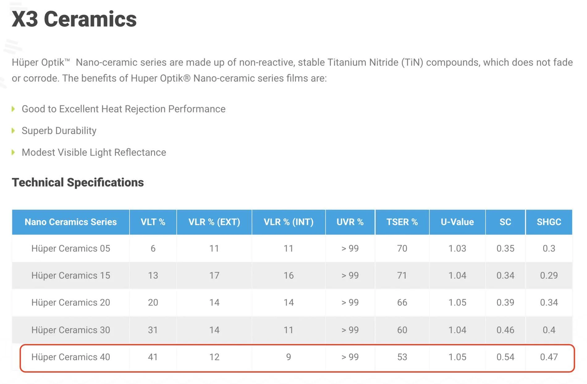

You will have to compare roughly same % Visible Light Transmittance with TSER % :like:
Thank you. I will check this out. I can remove my film on the outside and put something better in... :)

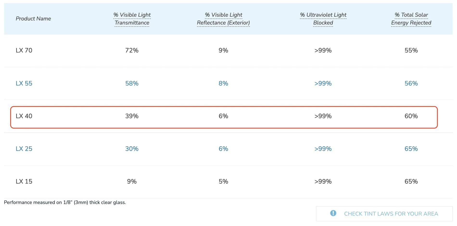

Not yet, my ct4s will only arrive in November :crying: and yes I have the pano and thermally & noise insulated glass on order.
My cayenne had full solar guard LX film and very happy with it. I am sure you can get it in Shenzhen
https://solargard.saint-gobain.com.cn/node/72

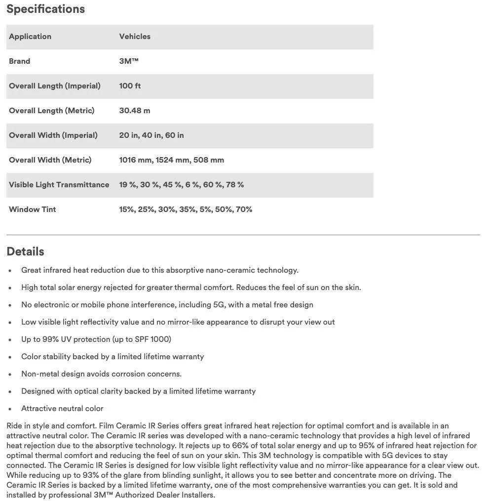

Hey Andy - good info - yes indeed I was actually comparing this but did not specify - I can still find examples in the link I sent and for example another here that put modern nano ceramics right up there in respect total performance with the significant benefit imo of no radio interference - this 3M example has multiple VLT options and still with 66% TSER. Huper-Optik are by no means the best in this field.
Porsche Taycan Air conditioning and panorama roof! 3M

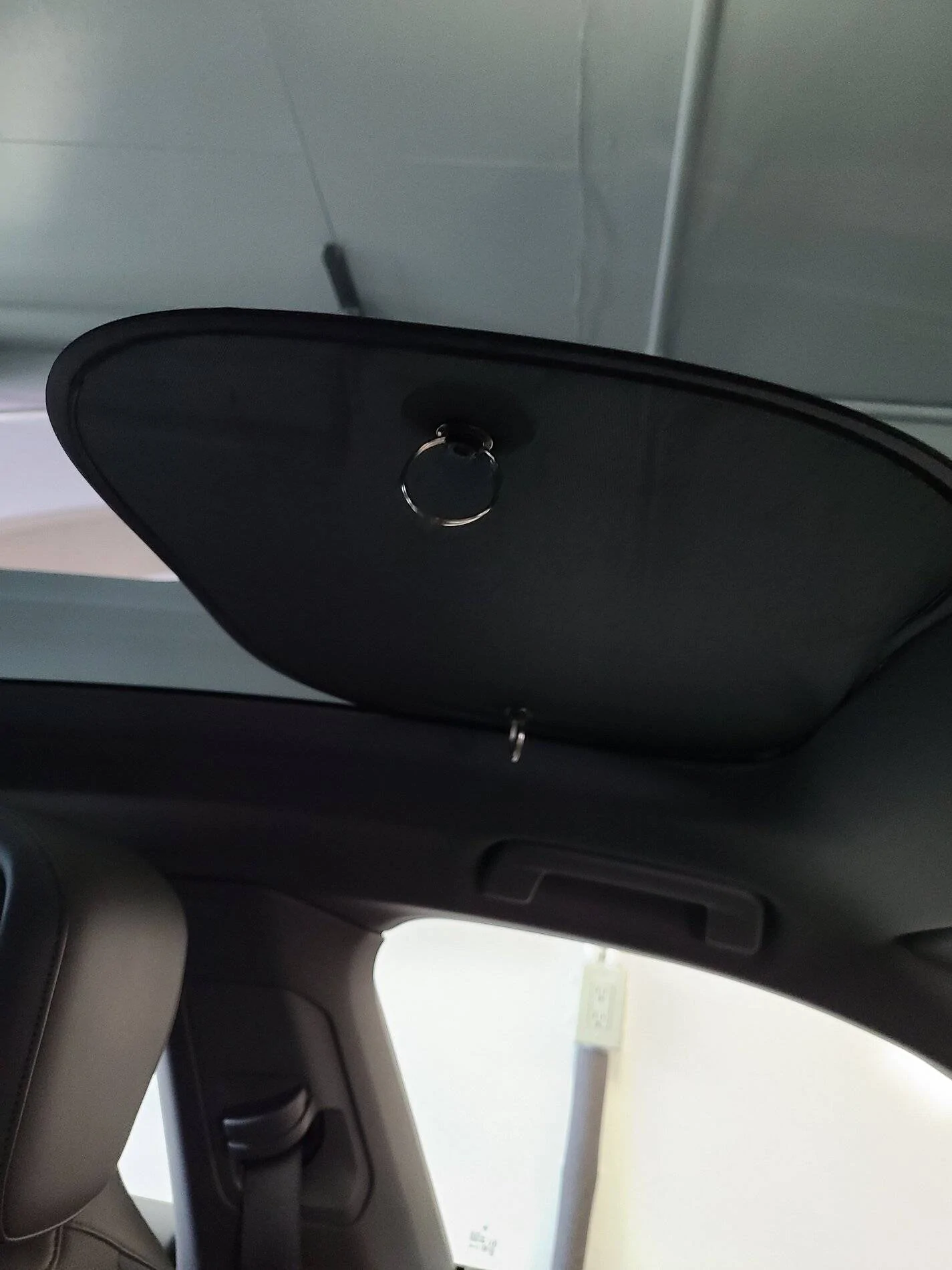

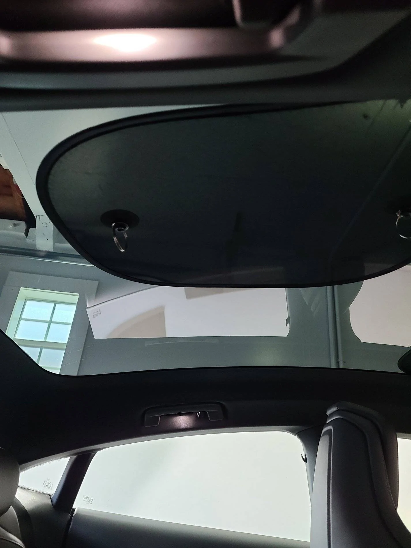

I live in Northern California. If the car stays under the afternoon summer sun for more than an hour (exterior temperature below 90 F) the roof gets hot. From the inside it is too hot to touch. The roof cloth liner around the glass is warm but not hot.
The A/C keeps the cabin cool without problem but there is noticeable heat near my head and the sunlight on my head is annoying. I have added sunshades that help a little.
