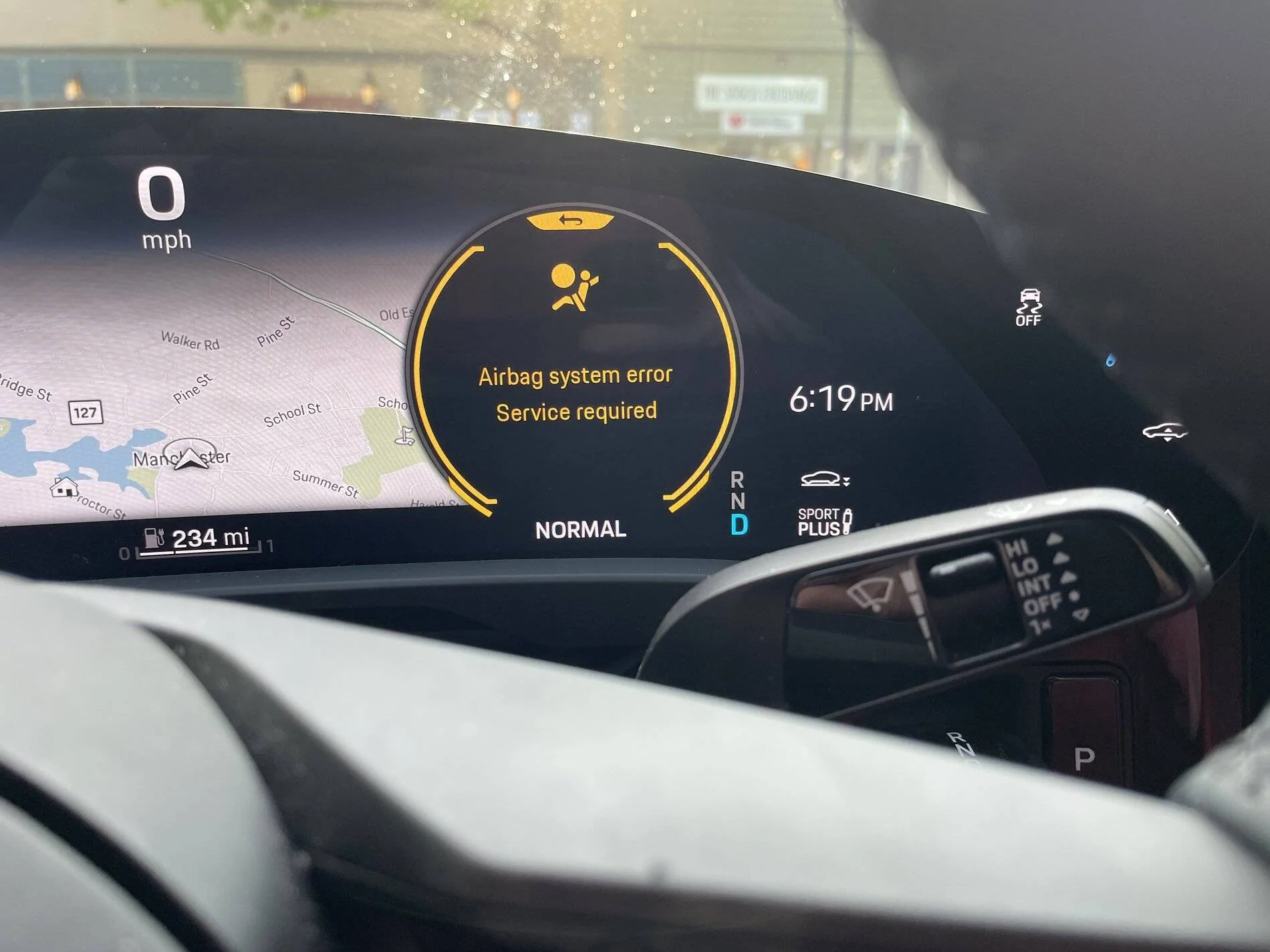

This just came up. Anyone seen this or know how easy it will be for my dealer to fix?
Porsche Taycan Airbag system error - Service required C9246649-E522-4B76-BD20-07C495389896

I’ve had the warning for a few days. Has anyone else seen this?
Before I start, If you are having similar issues with your Taycan/Porsche, please reach out to me. We need more leverage on Porsche to get our issue resolved. If there are ten of us we have more leverage.
Our brand new Taycan has been in the shop for 56 days (and counting) for this same airbag issue. The dealer knew within one or two minutes of driving off the lot as we sent him a similar photo 1/4 mile down the road. Even though a safety issue, they told us keep driving and it'll likely go away. It didn't. When we got home the car refused to charge. They told us to bring it back. I gave them written instructions to check the charger AND check the airbag situation. They resolved the charging issue (bad charger) and sent us on our way again. They apparently did nothing about the airbag light.
The light came back of course so the car was back into service at the end of the day on the second day of ownership. They supposedly ran a software patch and the sensor wouldn't take it. It didn't solve the issue so they ordered a new sensor. Apparently, their manufacturing backlog must be more important to them rather than us (the already paid customer) so we ended up waiting for the part to be manufactured in Germany (vs divert a part from the production line). The sensor finally arrived after 55 days of sitting behind the dealer (unprotected from CA sun or dirt/elements), and now they're saying the mechanic is out so it will be another week. I personally believe they tried the new sensor & it too didn't work and they really need greater tech support from Porsche. We will see....

What was the fix for your airbag issue? I just got the same notice on my car MY 22. I have a service appt next week.

Had my car repaired last week. One of the sensors in the front bumper area was bad and was replaced. Had to remove the wheels and bumper to get to it. Fortunately the part was in stock.
