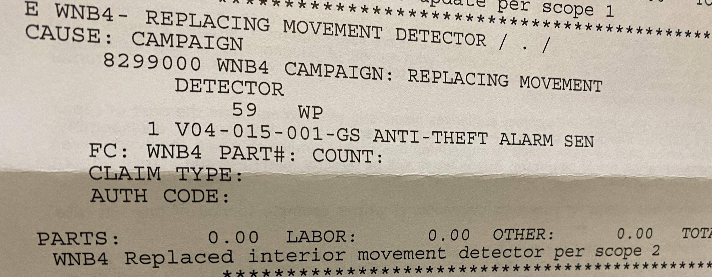

Just had the WNB4 campaign performed. Actually had the sensor ordered a couple weeks ago prior to the email from Porsche. Dropped off without an appointment and had the car back same day.
Looking forward to single clicks!!
The service notes described it as either a recode of the rear-end electronics OR recode and replacement of interior sensor. So perhaps not all cars need a replacement sensor.

I just had this completed today. So far no problems. Previously I was very easily able to reproduce the problem.
Porsche Taycan Alarm keeps going off 1650477967205
