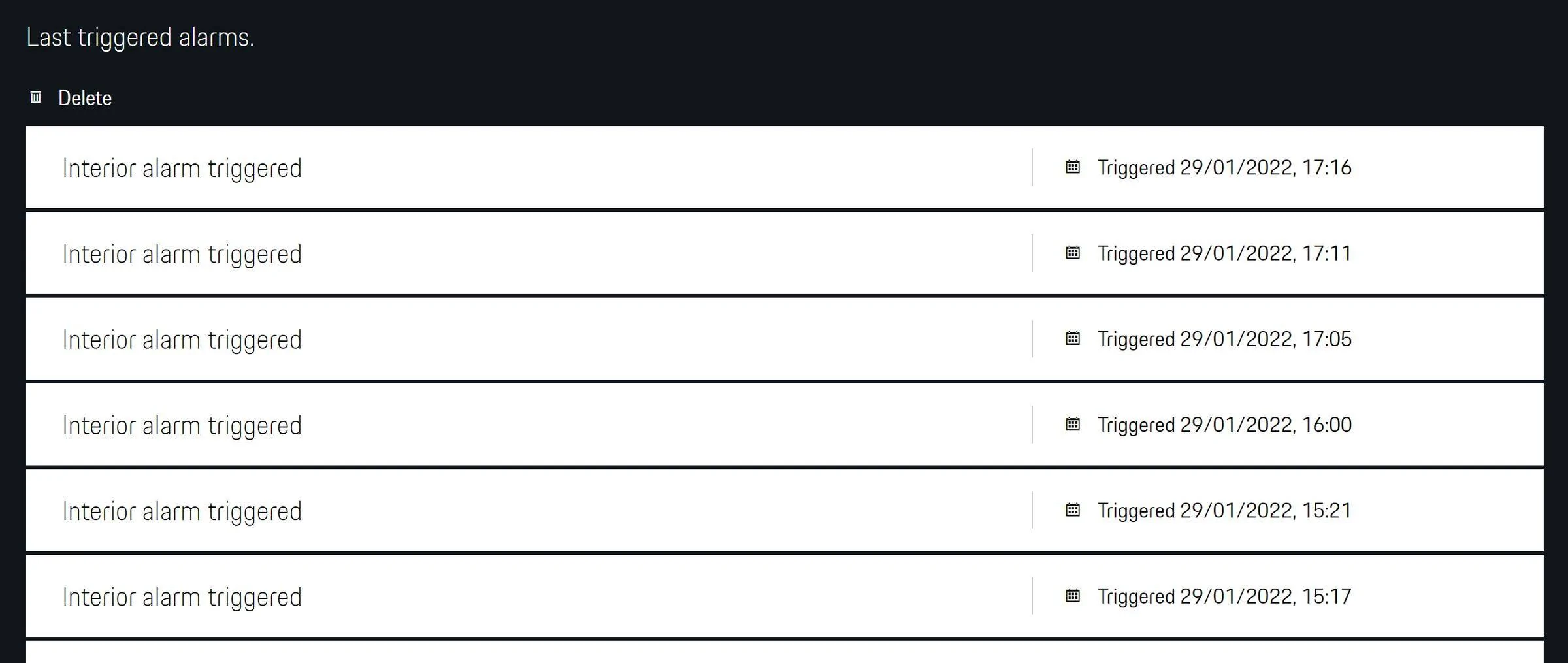

I ran the calibration against all four windows (even though they showed no drop like the back left window) and since then I have had no false alarm. Maybe it’s a coincidence.
3 false alarms today so thought I'd give this a shot. Just recalibrated all 4 windows and as soon as I open My Porsche (either via app or web browser) the alarm still goes off.
chylld
Jonathan
Oct 30, 2021
126
107
Sydney, Australia
CT4S
Managed to reliably trigger 6 false alarms today, before stopping as I really need to catch up with work. Last I checked I am not on the payroll for Porsche's software maintenance department.
Porsche Taycan Alarm keeps going off ss (2022-01-29 at 05.18.58)
So far I've concluded that the 2 preconditions for my car to false alarm are:
  • Be accessing My Porsche in some way (app in use or open in background, or interacting with the web app at my.porsche.com)
  • Car locked with interior surveillance activated
If I log out of My Porsche, the car stays happily locked with interior surveillance on, no false alarms.
If I disable interior surveillance, I can poke around My Porsche all I want, no false alarms.
That said, I need My Porsche to precool the car - it's one of the big reasons I run an EV as the family car. And remembering to wait for the interior surveillance prompt, double pressing the lock button, or double tapping the door handle sensor is getting really, really tiring.
But if the car doesn’t have a false alarm when you’re not using the app, that means the sensor is not the issue.
chylld
Jonathan
Oct 30, 2021
126
107
Sydney, Australia
CT4S
It is a logical AND in my case. If the interior sensor is armed, the false alarm appears to correlate with app usage. Conversely, if the app is being used, the false alarm appears to correlate with the interior sensor.
In any case (other cars may have different issues) I was just informed by my dealer today that Porsche Germany have formally advised Porsche Australia of the issue, and that the formal fix is a replacement sensor. Booked in for the fix in 3 weeks.
