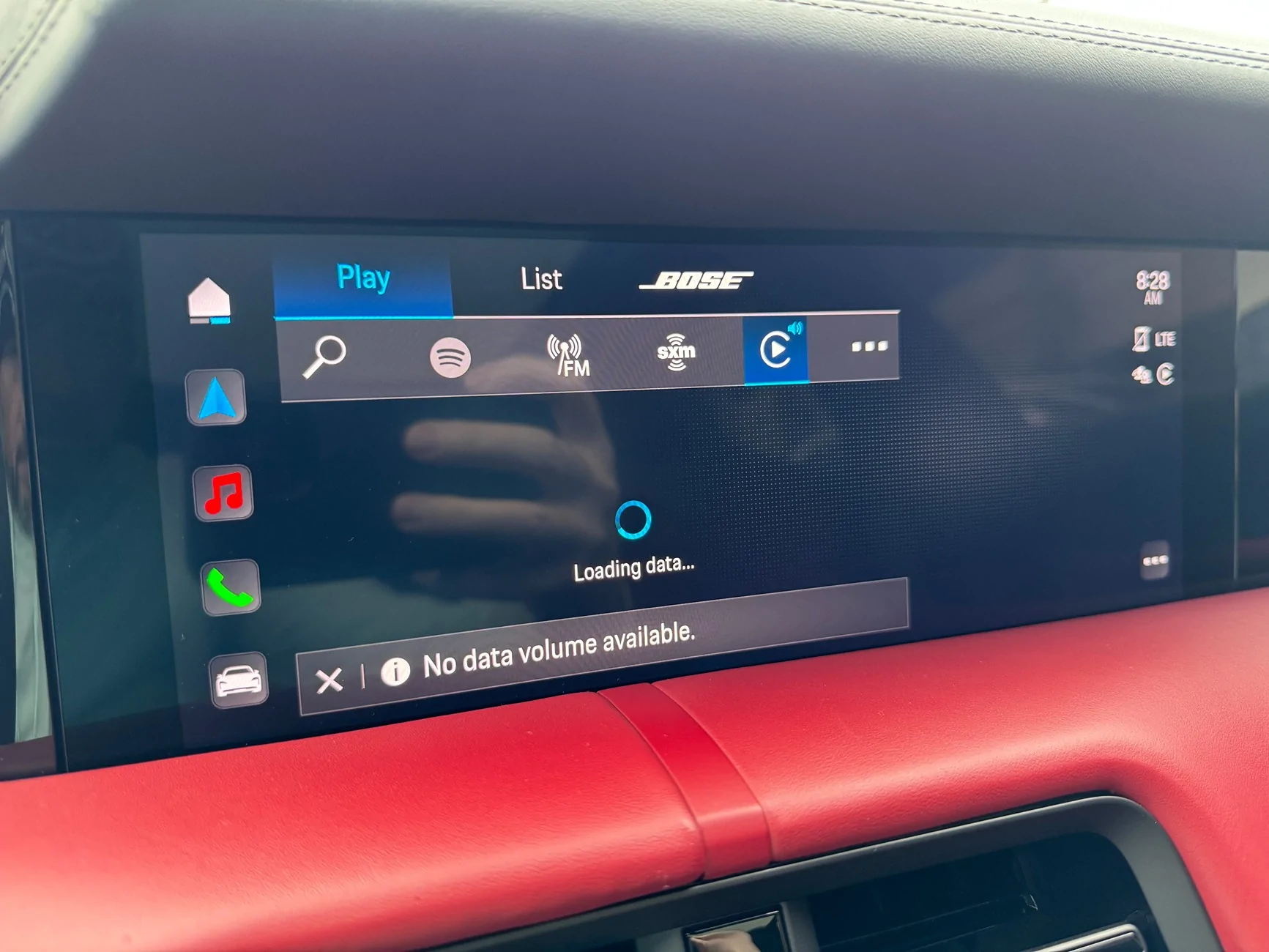

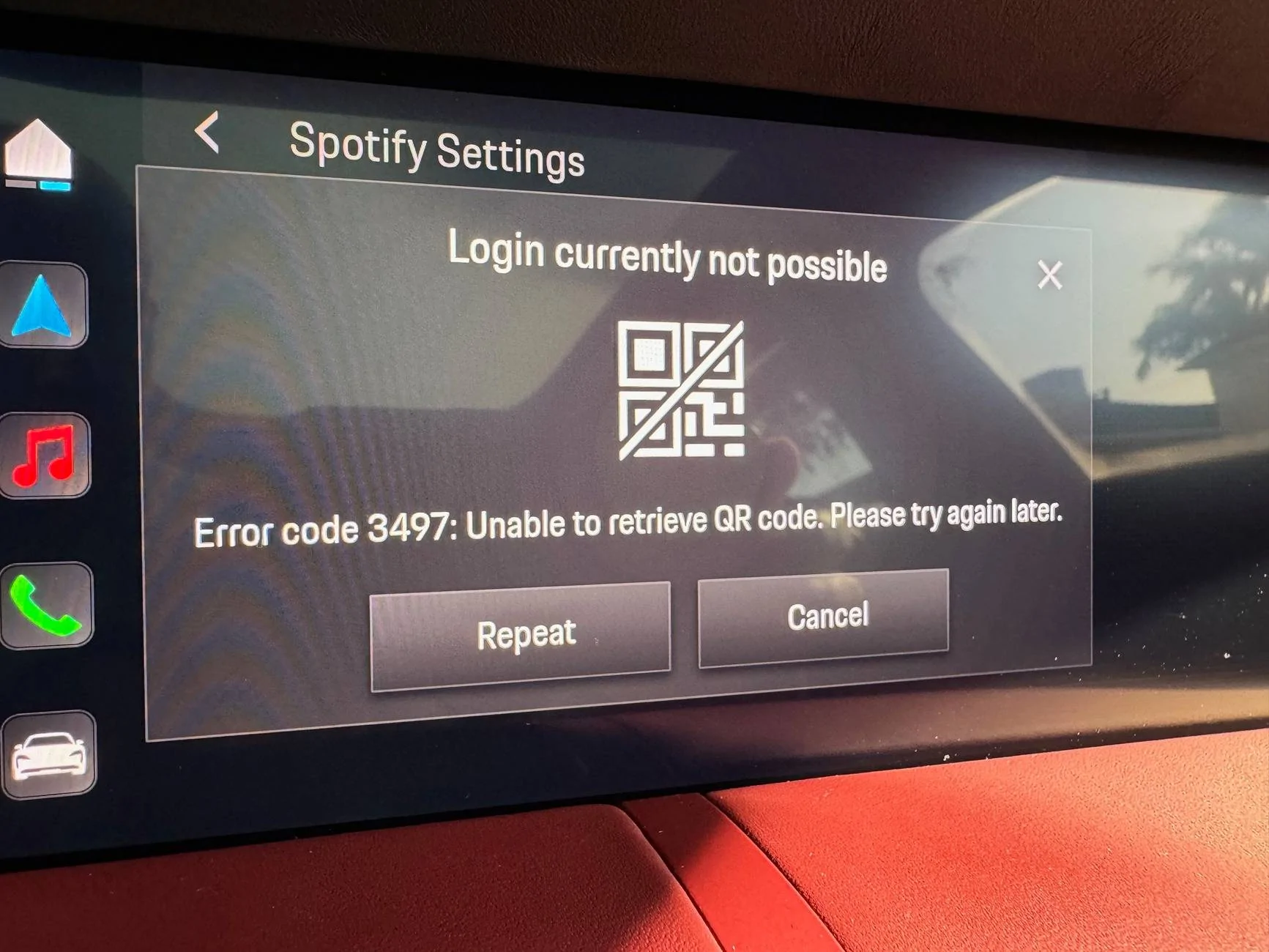

New Spotify error today, hooray!
"No data volume available." Fantastic!
CarPlay then, I guess?

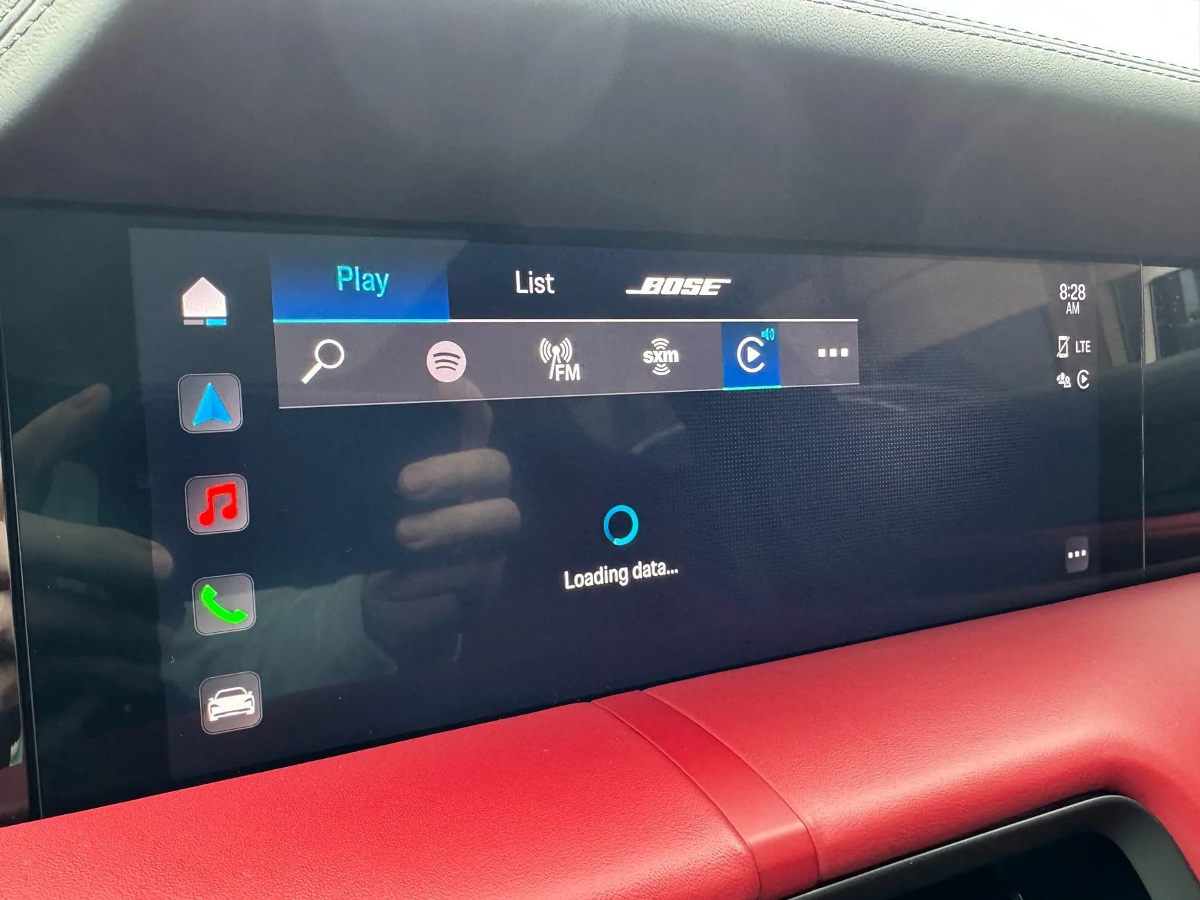

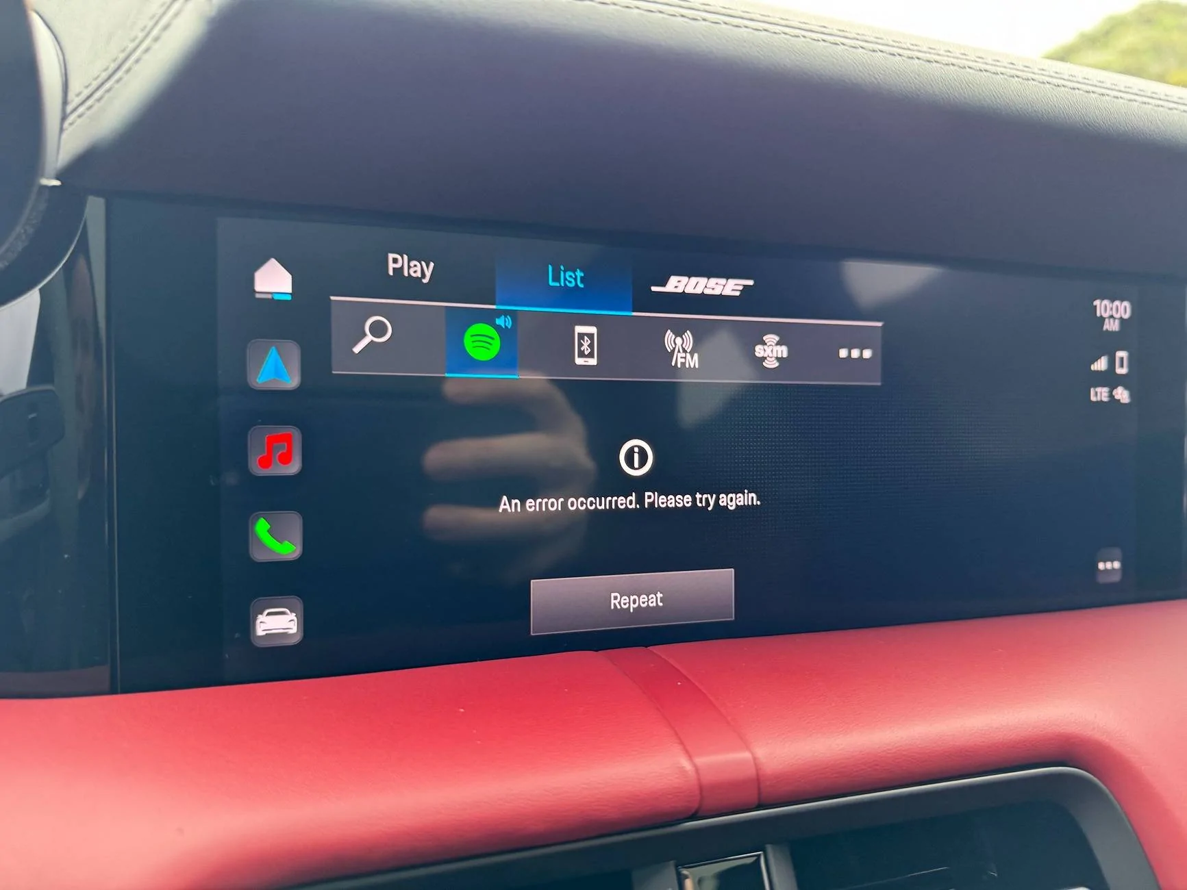

Endless "Loading data..." screen!

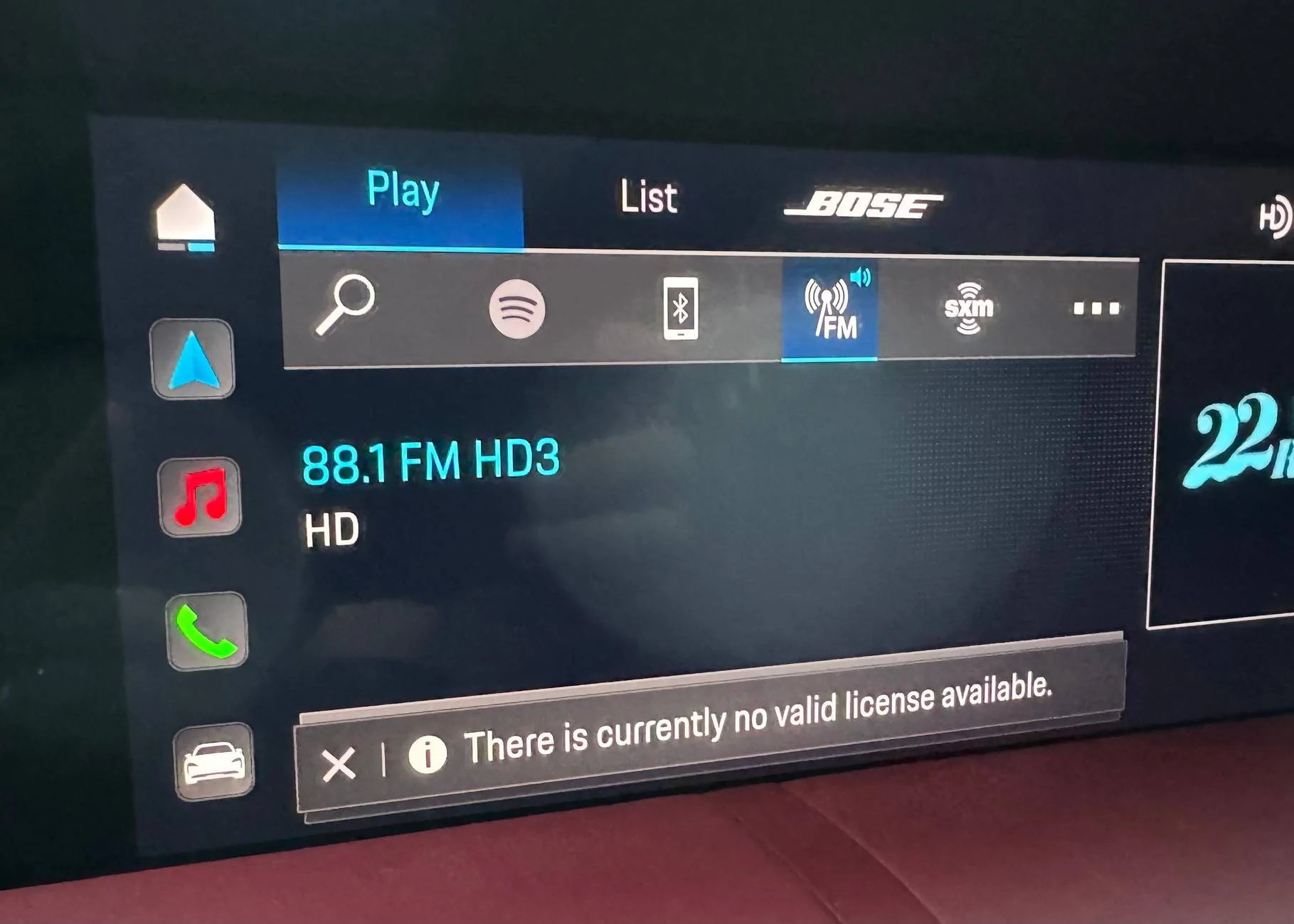

This is a couple days after my Porsche Connect expired and I reluctantly signed up for the $26.49/mo subscription ugh. Probably some cache somewhere that needs to get cleared so I'll sit in my driveway pressing buttons to sign out, sign back in, blah blah blah later in hopes of getting this f&*king thing to work.
A workaround that works for me is to switch to FM radio, then back to Spotify. Works most of the time as long as the car has cellular connection (without it it gets confused, sometimes asks me to login to spotify, but once it has a connection, it will work, might require switch to FM and back again though). Then there is streaming through CarPlay too.

@whitex that works for me sometimes too. Tried it this morning, no dice. On Monday when Spotify also didn't work (also after I paid the $26.49 to start the Porsche Connect subscription) I switched to CarPlay and navigated to the podcast I wanted to listen to - and it showed only like 7 episodes of that podcast FROM 2022. Four years ago. Just... astounding.
Can you not just use Spotify on the phone to select the podcast you want to listen to, and it would still stream over CarPlay? The Porsche audio screen would probably update then too, to show the podcast you are listening to.

Yeah, that's what I had to do. Thankful that terrible workaround still works...
Drove home from work in silence. Trying to switch to Spotify still gives the "No data volume available" and I also tried logging out of my Porsche account and logging back in. Ugh ugh ugh. Time to do more research on how to get this POS Porsche software to do the basics...

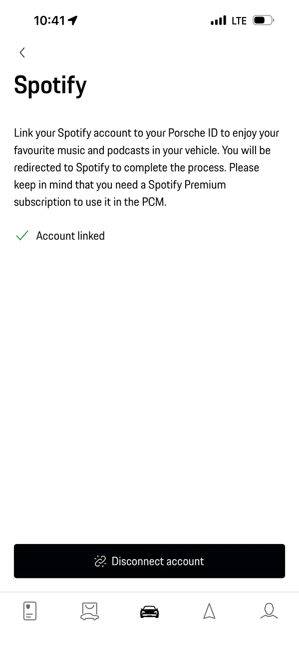

I was able to log in to Spotify, BTW (got past the "No data volume available" error). I went in to the "PCM Services" bit in the My Porsche app (Vehicle Details -> Functions -> PCM Services) and in the "Spotify" area I tapped "Disconnect account". Then I selected Spotify in the car and did the QR code scan etc. and it worked. Spotify back in action! Let's see how long before I have a problem - and what problem it is. Place your wagers.... 😉

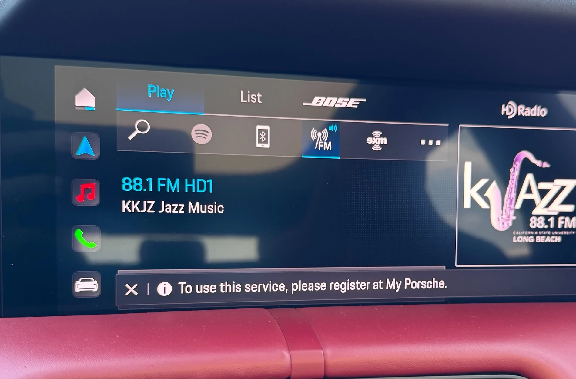

That ended this morning. Spotify disconnected and when I tried to switch Spotify back on, I got a new error: "To use this service, please register at My Porsche."
Porsche Taycan All the Spotify errors... 01_register_at_my_porsch
Guess who already had Spotify connected/activated/linked? This guy.
Porsche Taycan All the Spotify errors... 02_already_registered
I disconnected and reconnected my Spotify account and will cross my fingers when driving home later... (at work now) :rolleyes:

Update: did disconnecting and reconnecting Spotify from the My Porsche app fix the problem? It did not.

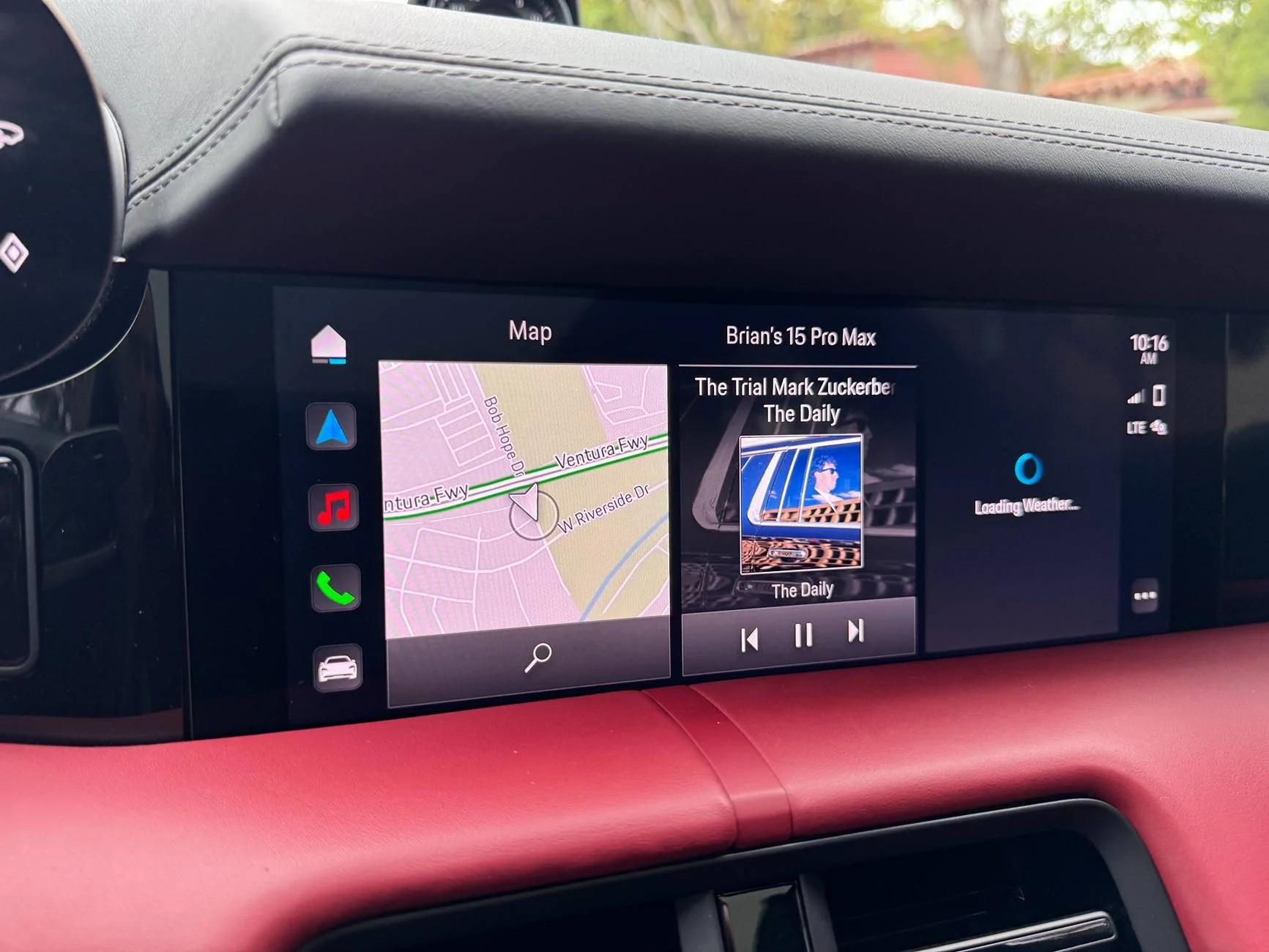

Oh, BTW - the "Weather" app (which I put on the right side of the main display) was also blank this morning.
