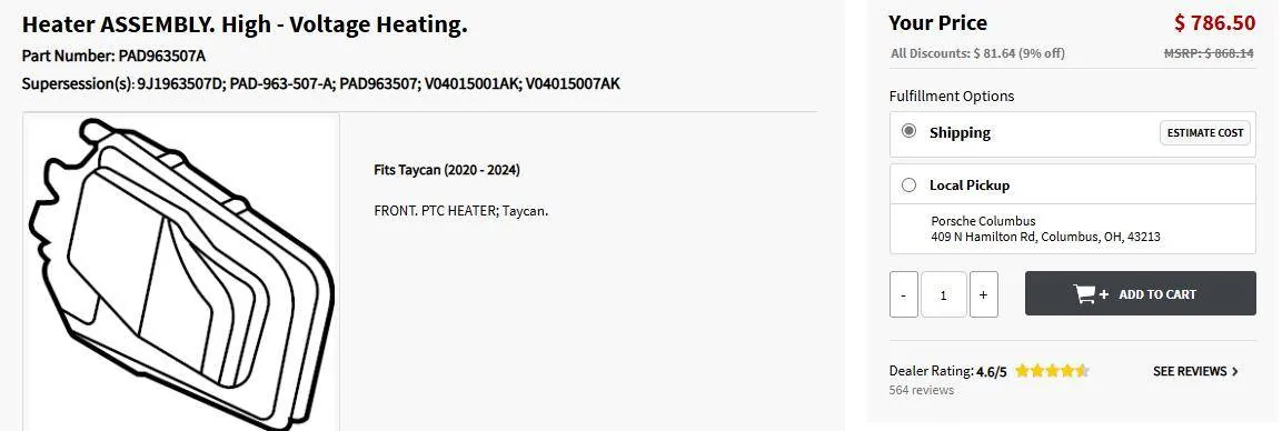

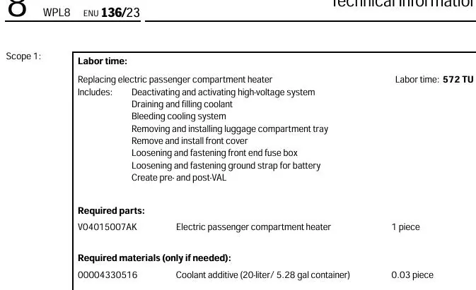

About 6 hours of labor, the heater, and coolant:

Very valuable info! Repair around 2k pounds mark.
And suddenly all the Taycan have dropped additional 2k in value….at this speed we will see 2020 Taycan on the market for 8-10 grand…
