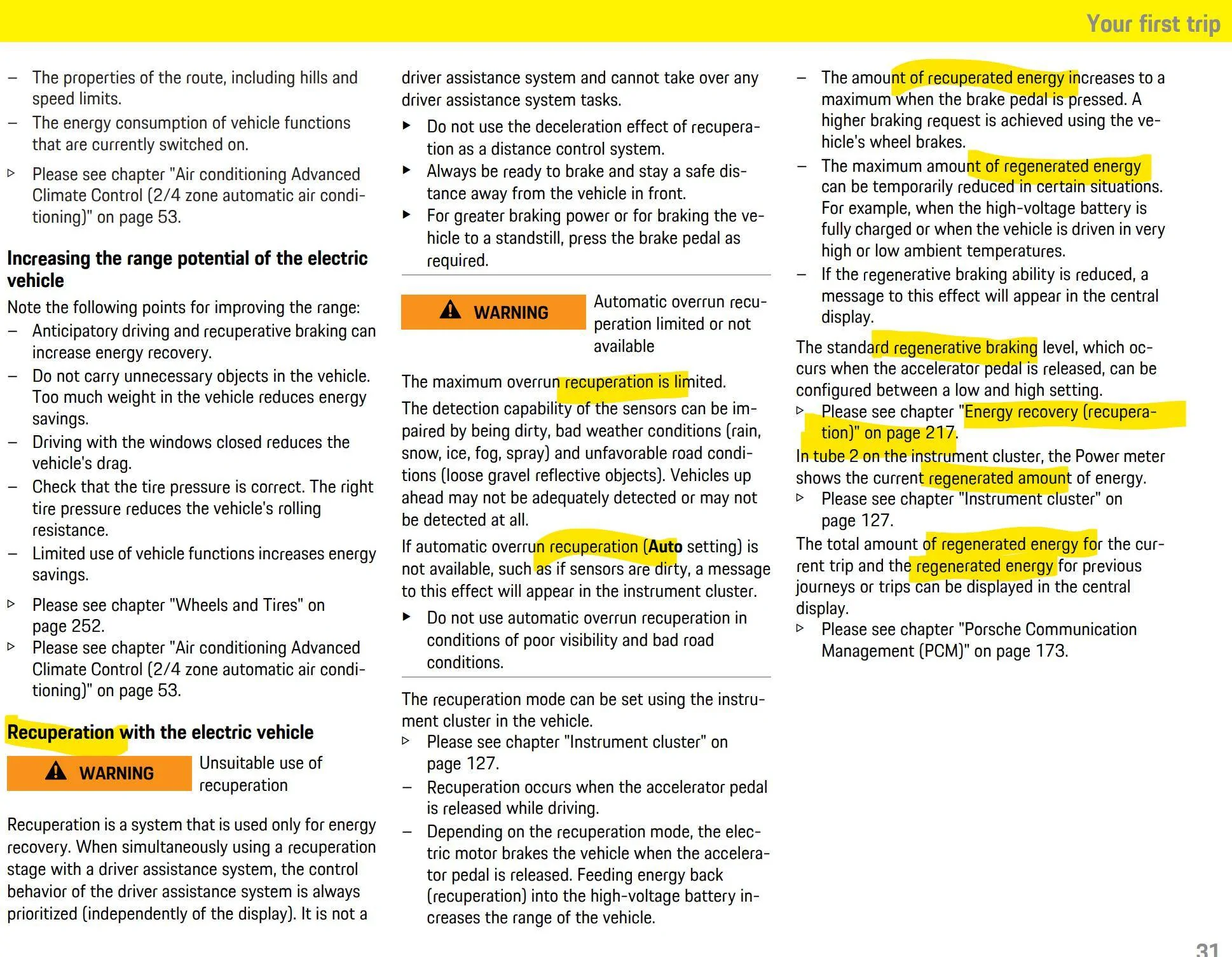

This is one of the reasons why pre-conditioning is important prior to both departure for range, performance, and regenerative braking as well as prior to DC Fast Charging for a high charge rate.

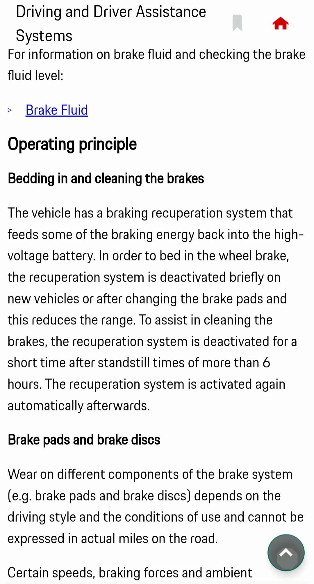

Fish Fingers
Feb 20, 2021
50
2,561
3,335
Sold
Thanks! I hadn’t looked for it in there simply because I never noticed this occurring before about a month ago and this is my 3rd Taycan. So I assumed it was a recent OTA.
Its also in the Good to know app.
I think its been in there at least since I got my car (Aug 2021).
I also mentioned it in another thread and was told I was wrong, but here it is....
