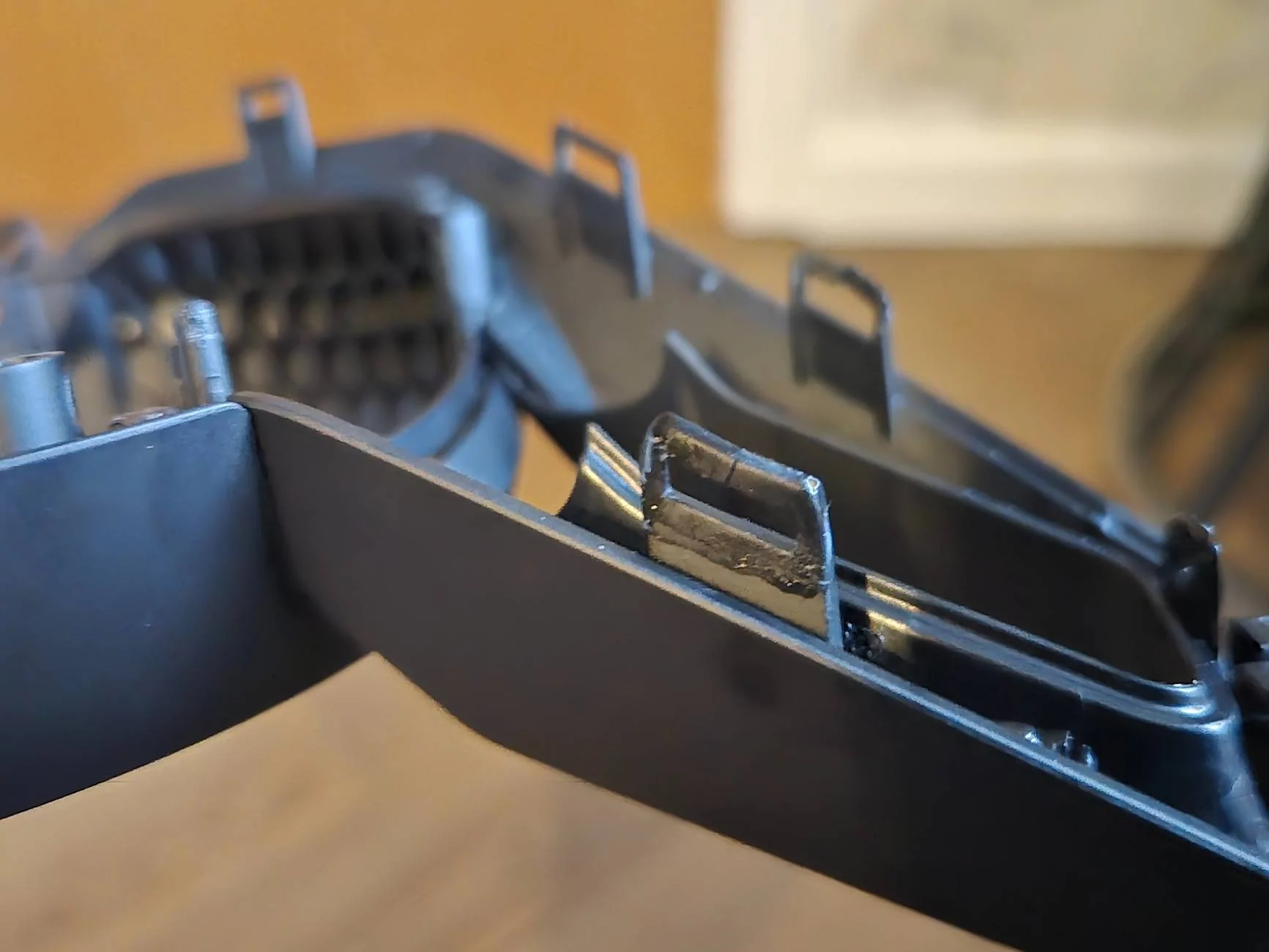

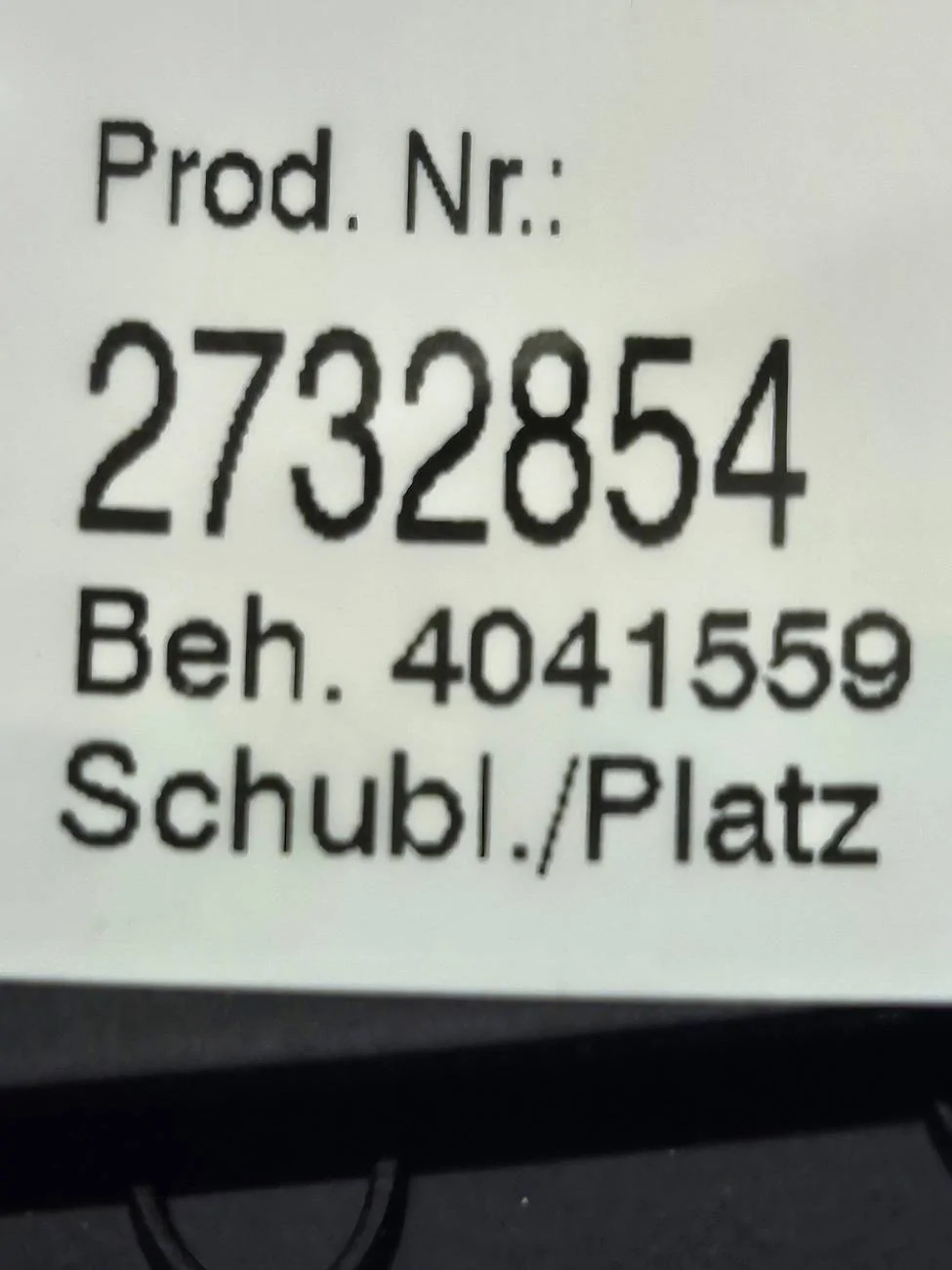

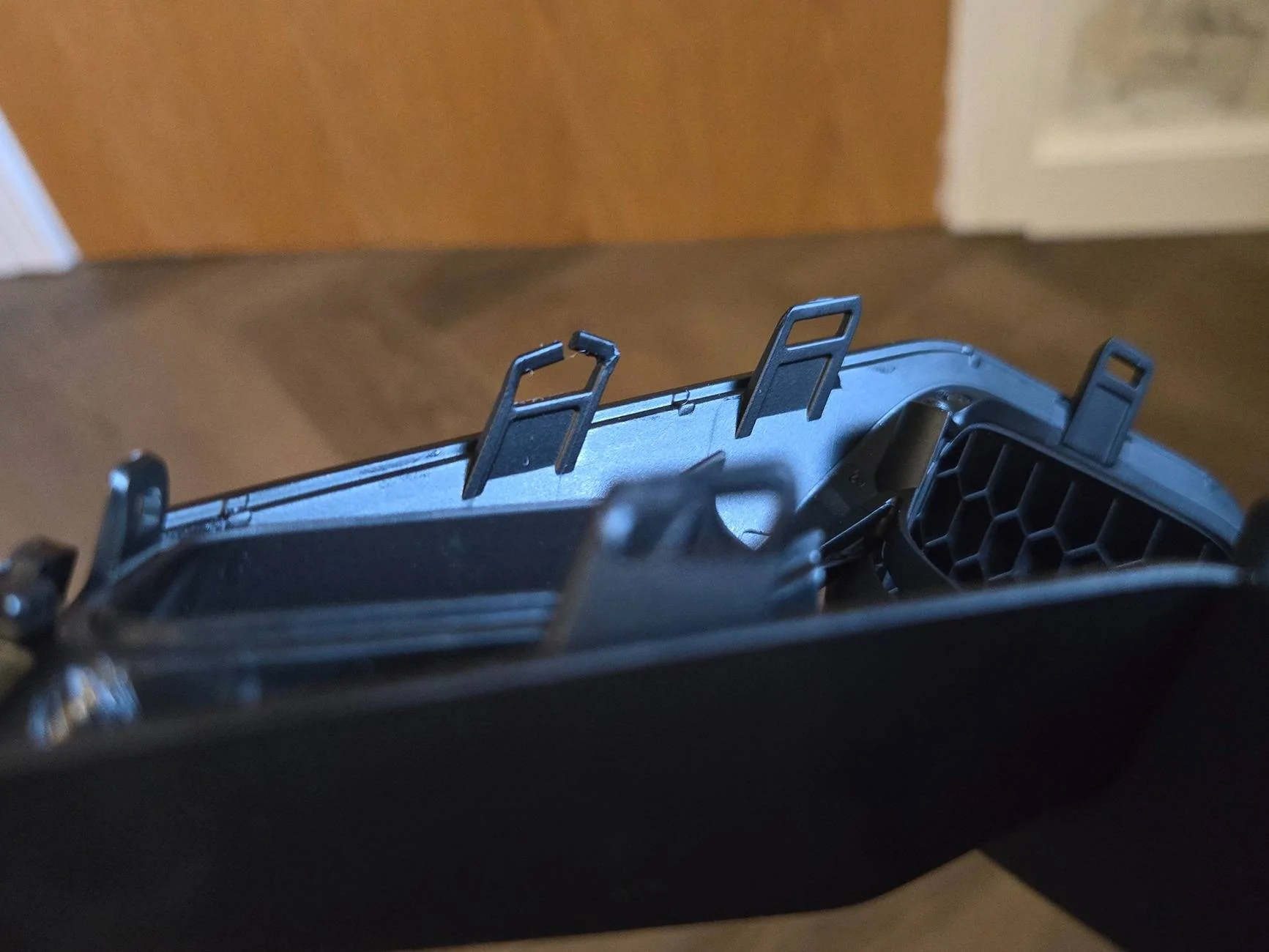

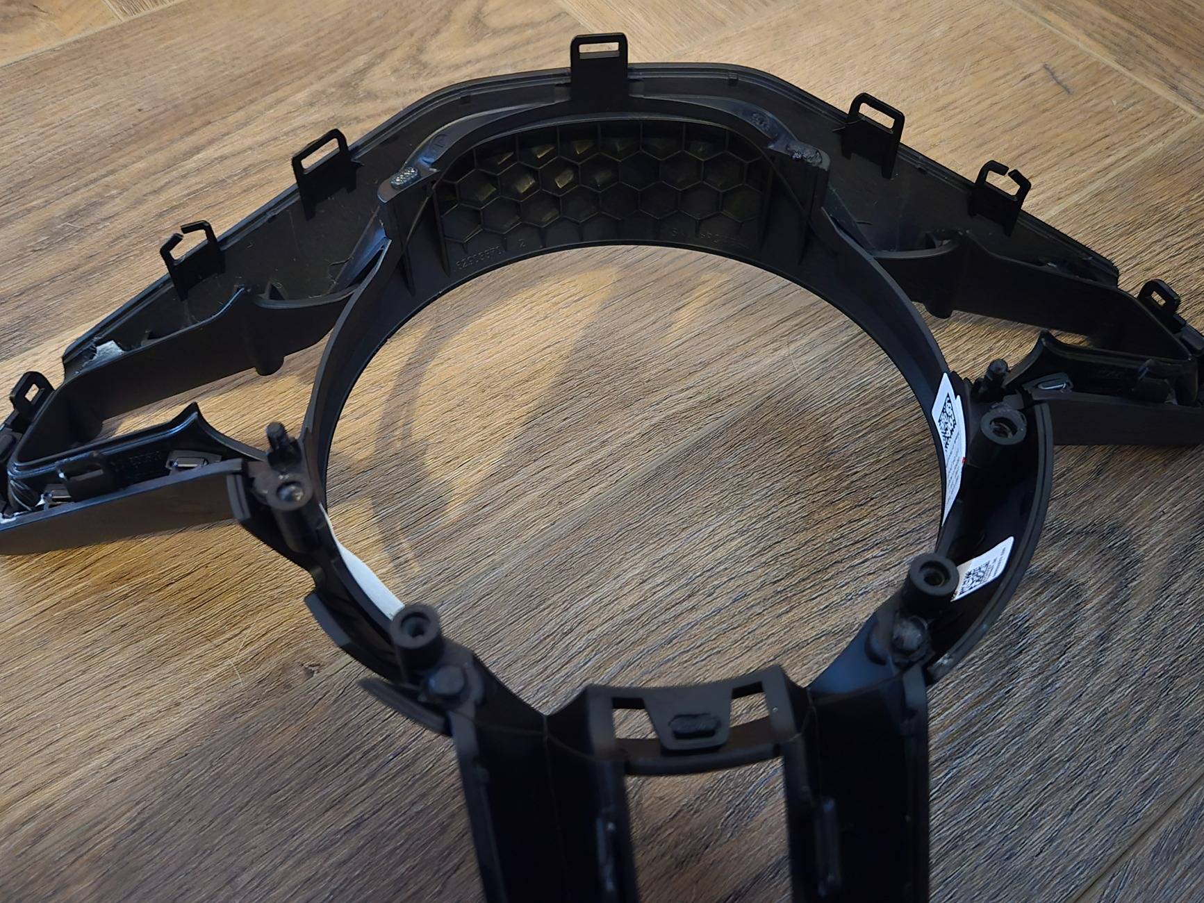

Pictures attached, a few broken but not alot.
That's great, @JonnieB. Many thanks.

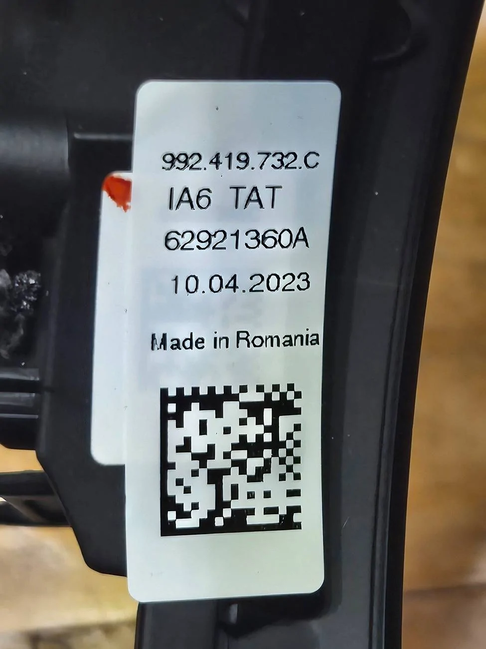

This is the plastic trim from the front of the wheel, right? - is there a Porsche part number on it? I'd be interested to see if they're available and for how much before I break mine :CWL: .

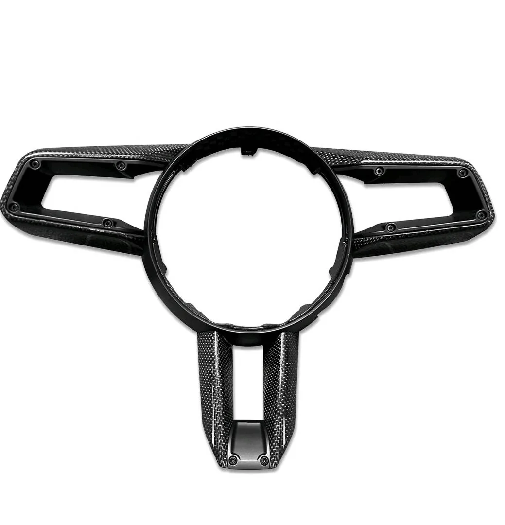

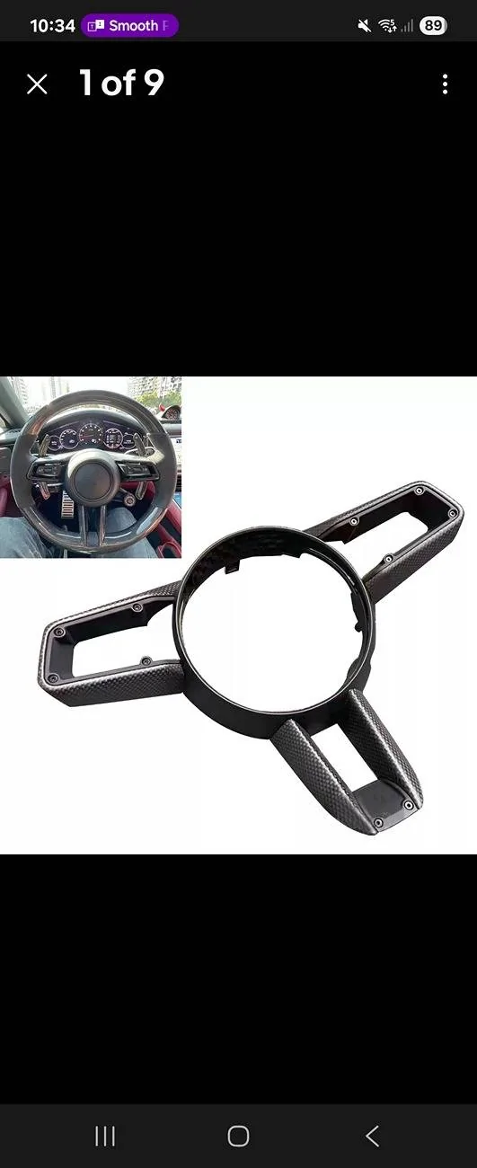

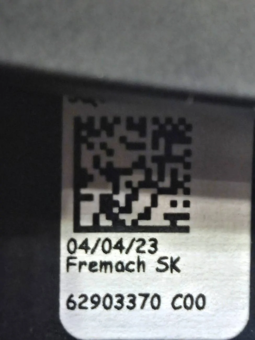

I have ordered a CF one, will check for part no
All numbers from that top trim piece attached ??

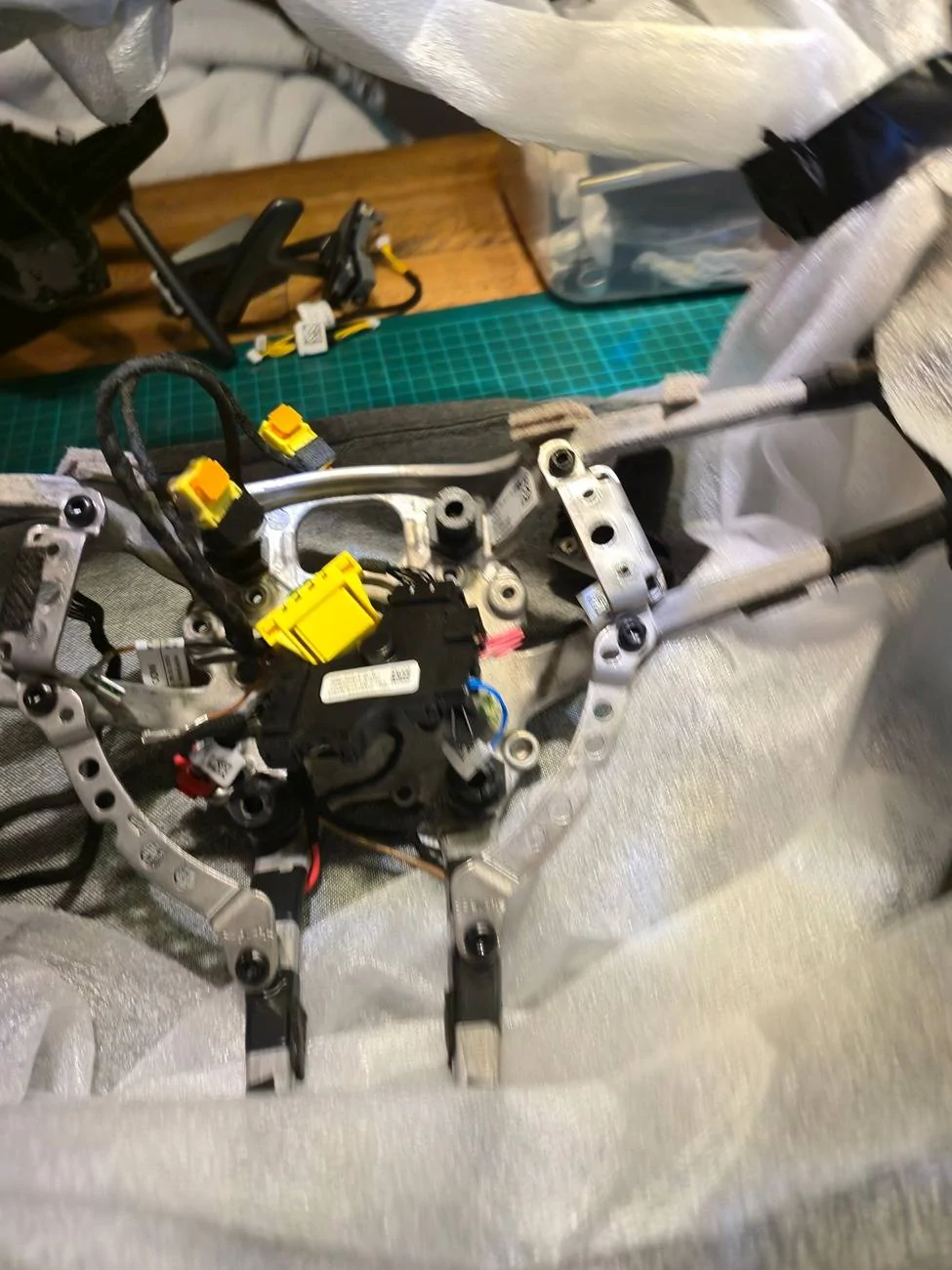

6) Remove the 4 screws shown here in blue using a T25 torx bit:
Note that there are springs under each screw below the plate - be careful not to lose them. Remove the plate, taking care to remove the spade connector circled in red.
This is what you'll see now:
Note the springs as previously mentioned. Carefully remove the springs and metal plate below - noting the second brown wire and spade connector (these relate to the horn press).
Now you'll see this:

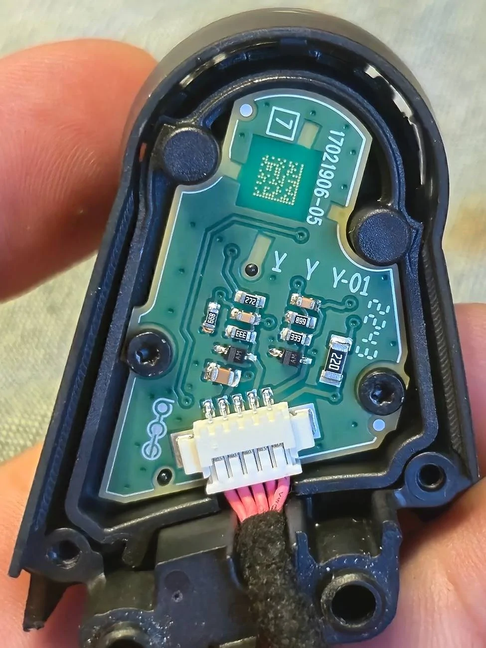

What's of interest here are the two little boxes - circled in red and yellow in the photo above, though my wheel didn't have the one circled in yellow at all. These take the connections from the wheel buttons, mode dial and heater switch and then connect back to the car through the big yellow connector and the clock spring behind the wheel.

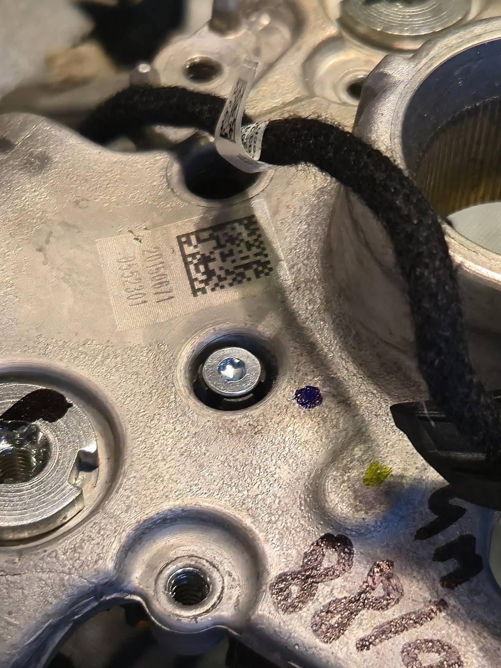

7) To prevent the need for any coding what I did was transplant the little box(es) and main wiring harness (with yellow connector and airbag connectors) from my existing wheel into the new wheel, carefully removing the tiny connectors for the buttons, etc. and pluging them back into the replacement box.
The box circled in red is secured from behind by a single silver screw:
Remove the screw first and free the box from the wheel, then work round the various connectors. I'd recommend taking photos of both the connector and cable positions so you can replace them in the same place - I don't think any connectors are identical so it shouldn't be possible to get them mixed up.
This photo also clearly shows the two connectors connecting the wheel to the clock spring. If you don't have wheel heating you won't have the red/black plug.

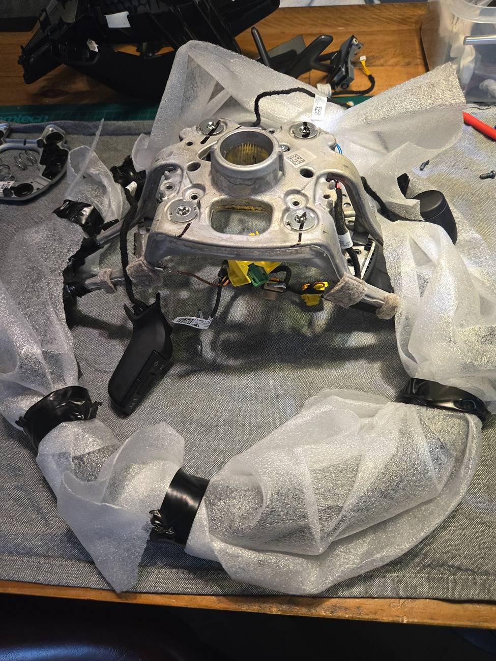

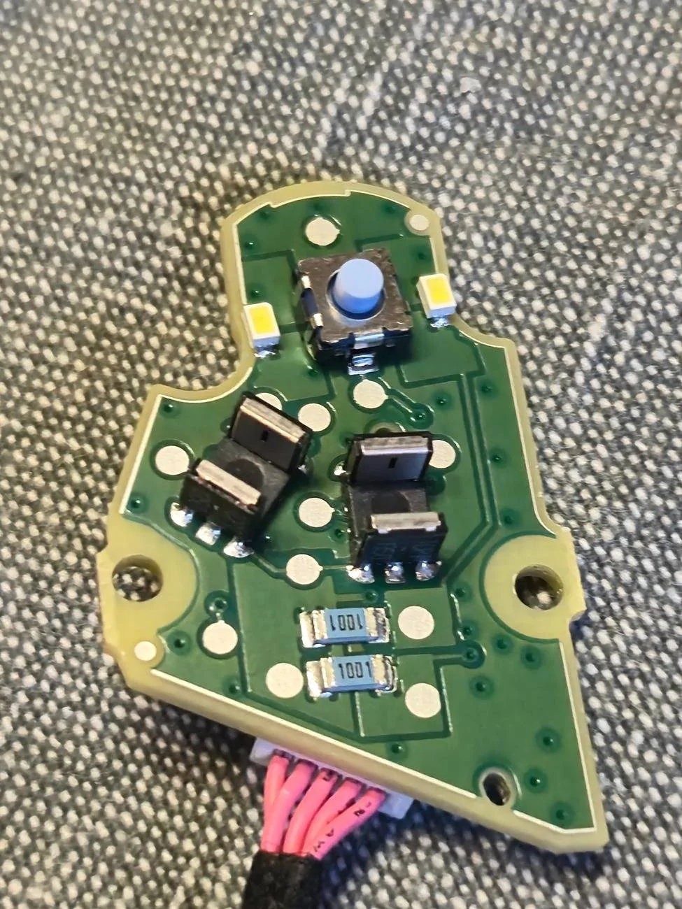

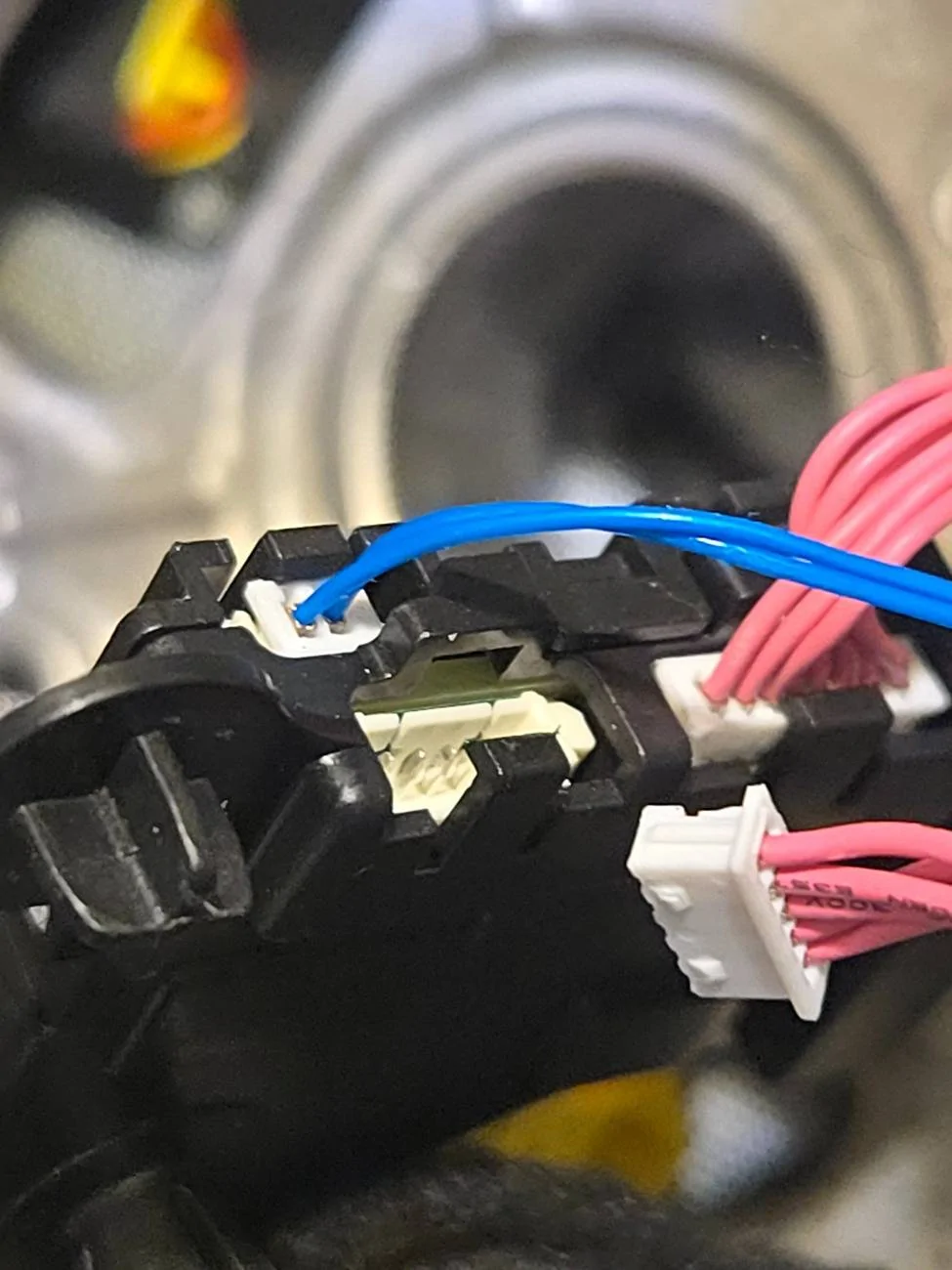

Wish I had found this thread earlier. Carismo made a custom steering wheel and they had me remove my old one to send in and have them retrofit the buttons. Seemed easy enough from the YouTube video they shared with me, however there was no mention of the heating element clip or any disclaimer about the importance of disconnecting the upper pins prior to removing the steering wheel. I toasted my clock spring. Now I need to find a reputable one that doesn't cost an arm and a leg. Anyone got a source for one that works with a heated steering wheel?

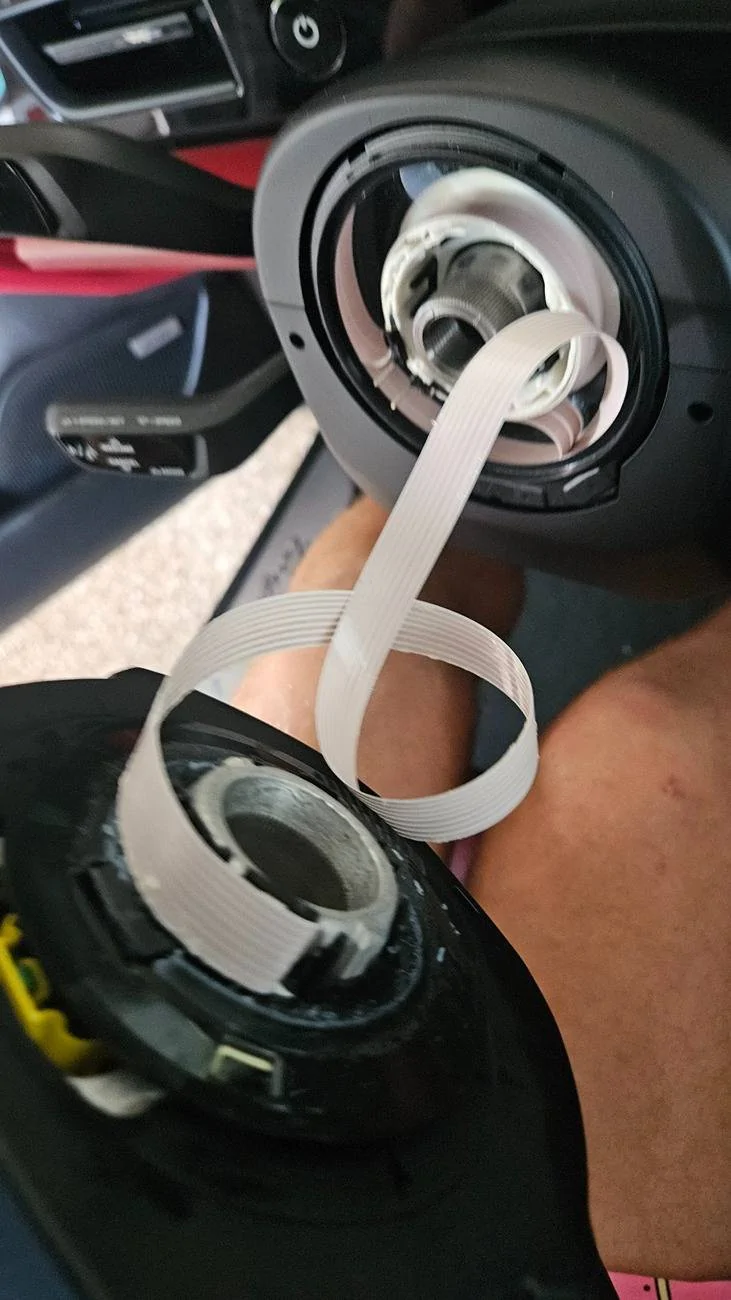

Eep! :eek: - not nice.
If you're very careful you can remove the front of the clock spring from the back of the wheel and carefully put it back together, winding the ribbon cable round as you go. You need to ensure you don't twist the front relative to the back so you have the same number of turns as when it came apart. You also need to pray that the car doesn't realise it's been off because then you need to recalibrate the steering wheel position sensor which requires a PIWIS!
What's the Porsche part number for the clock spring you have? - I think they're common across many models so you might find one by searching the part number - they come up on eBay. Note that if you do change the clock spring you'll definitely need to recalibrate the steering position sensor - the car will complain about lots of things not working until you do.

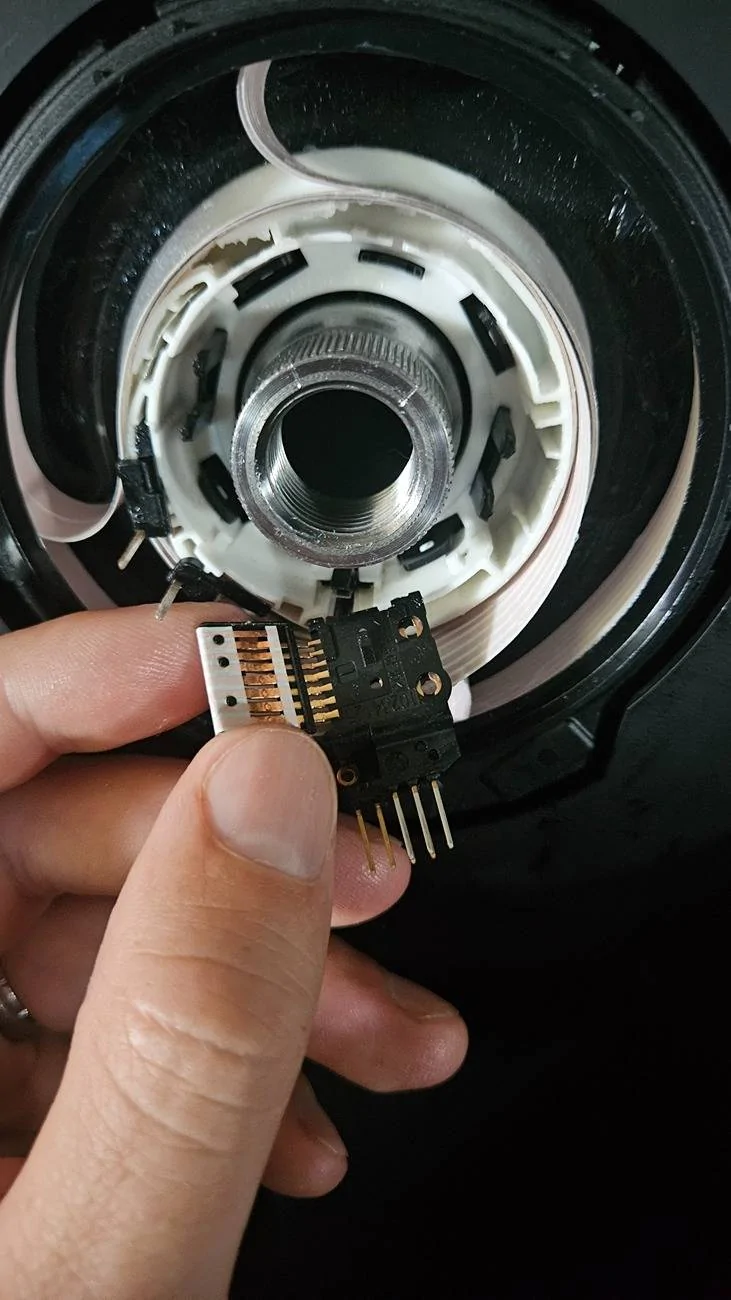

A quick phone call to my local Porsche dealership answered all of the questions. This is a rare issue indeed, as the clock spring unit itself is not available for purchase, unlike most vehicles. It is sold as a complete assembled steering assembly, including the wipers, turn signals, and cruise control lever. They quoted $1450 for that part alone however, I have found a used one for $280 on eBay. They quoted $1k to install it, including calibration (required if installing a new clock spring) or if I am able to install the new one myself, the calibration is roughly $250. So best case scenario I buy the used assembly and install it myself, then have them calibrate to remove any error codes.
The annoying thing is that the clock spring unit can clearly be detached and installed separately from one assembly to another, but it isn't listed as a separate Porsche part. This is impractical and price gouging at its finest.
In the meantime, I'm going to see if I can't rewind this sucker and reinstall, which would potentially mean I spend $0 and just learn a valuable lesson on steering wheel removal and the fragility of the Taycan clock spring.

I wonder whether I should swap both the left switch, but also the module so the car thinks its the same steering wheel?

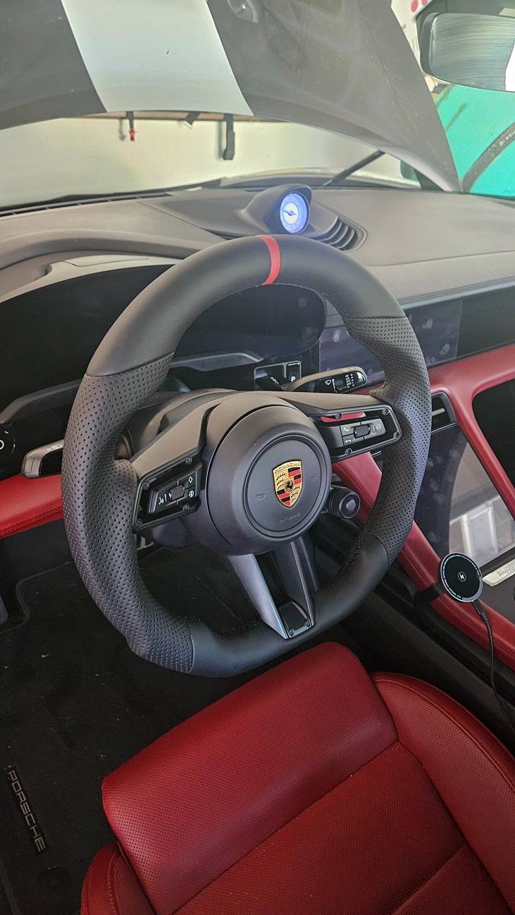

Dude!!! I was able to do exactly what you said. Was a little tricky to figure out at first how it winded back in, but I successfully replaced the clock spring cover (one small plastic clip had broken off but hasn't been an issue at all since I installed the new steering wheel) and drives like a dream! No calibration required, except I had to clear the airbag code using a touchscreen diagnostic/scanner. The one I used was a friend's that was a bit older, 2017, so it didn't have the Taycan listed. So we used the Panamera settings and was able to successfully clear the airbag code! I will say, my first attempt at installing the steering wheel was slightly off axis, so it's a good idea to drive the car a little to ensure it's put exactly at the correct location, before clearing the airbag code, otherwise you'll keep getting the code everytime you remove the airbag to adjust the steering wheel.
Looks fantastic!. I have got my wheel, just not had time or the b@lls to install it yet. Alcantara with CF trim and titanium mode button ?? I've removed the flappy paddles.
