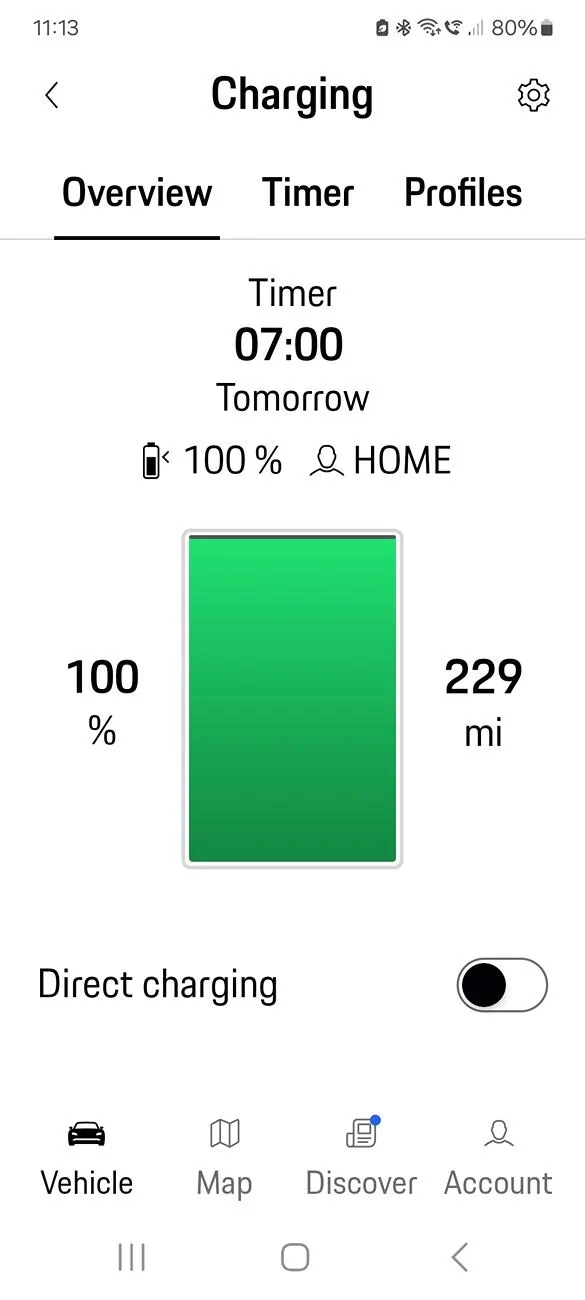

I tried over night last night and the charge - set to 85% in Ovo anytime - only went to 80%.
Looking at the Porsche app direct charging was off - I think this is perhaps how the ovo app sets when it charges.
I will try switching off direct charging before the timer gets to its target and see if it continues to 85%.
I am sure I have woken and checked early how it is getting on with a 100% charge - I only do tis infrequently - noticed direct charging was off, switched it back on and it did continue but too late to get to 100% I seem to remember.
I'll pay more attention next time

So I tried again last night.
I started off with direct charging set in the car 85% set in OVO anytime to be complete by 9:00 when I looked at 7:00 the car had had direct charging switched off, was reporting "charge process completed" but a line on the display at 80% and it had only charged to 80% during the off peak period and direct charging had been switched off.
I switched direct charging back on from the app but it was switched off again at 81% when I looked later so I switched direct charging off again with the app, we will see if it gets to 85% by 9:00
4,777
8,364
It didn't.
Probably as soon as the link between the Porsche app and the OVO app happened the hard line on the battery display re-appeared in the Porsche app and direct charging was switched off - presumably this is entirely coming from Porsche.

Very interesting. Are you able to check what profile/timer settings arrive in your car when you make changes in the OVO app? - I'm wondering if Porsche is modifying the settings before they're delivered to the car.
I sat in the car and went through a few menu items this afternoon.
The car had a location dependant profile set at 80% for my address. I don't remember setting this myself (but that is no guarantee that I didn't) so I switched it off and we will see tomorrow morning if anything happens.

So this morning it stopped at 80% again despite me making sure there were no limits set in the car before I plugged it in.
There is a black line at 80% on the charge bar and direct charging has been switched off, presumably by Porsche.
So whatever I have tried OVO anytime does not charge above 80% and the means by which it happens seems to be by the software switching off direct charging when the charge level gets to 80% - I can confirm no profiles or timers are set in the car. If I switch direct charging off again in the Porsche app before the OVO target time is reached it does start charging but after 1 or 2% have been delivered it stops again with direct charging switched off again.
It is unlikely to be the energy company creating the limit.
I had thought the 80% was advisory and had used more a couple of times for long journeys but now can't find a way to charge at home for a long trip.
I am annoyed.
Weird isn’t it. I did manage to get mine going by changing things around. I think it was via changing the general profile to 85% and leaving it unchecked.

I don’t recall how the OVO App works. But in the similar Octopus one, if you turn off ‘Smart Charging’, your Porsche App/PCM settings ‘take back control’.
To the same end, you may be able to just delete your charging parameters from the OvO app.
When I switched from OVO to Octopus a while back, OVO didn’t immediately stop trying to control the car’s charging. For a period of about a week both fought with each other to control the car’s charging.
I found smart charging has too many unreliable external dependencies so switched if off a while ago and just rely on the Porsche App/PCM.
