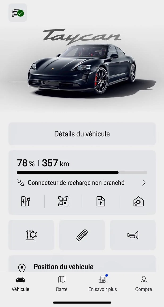

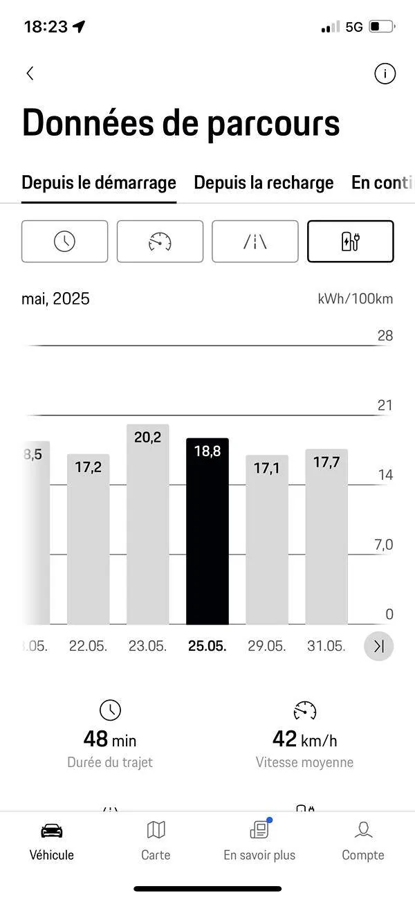

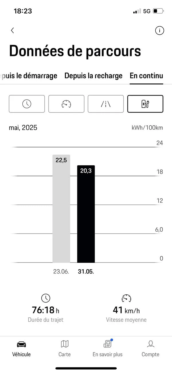

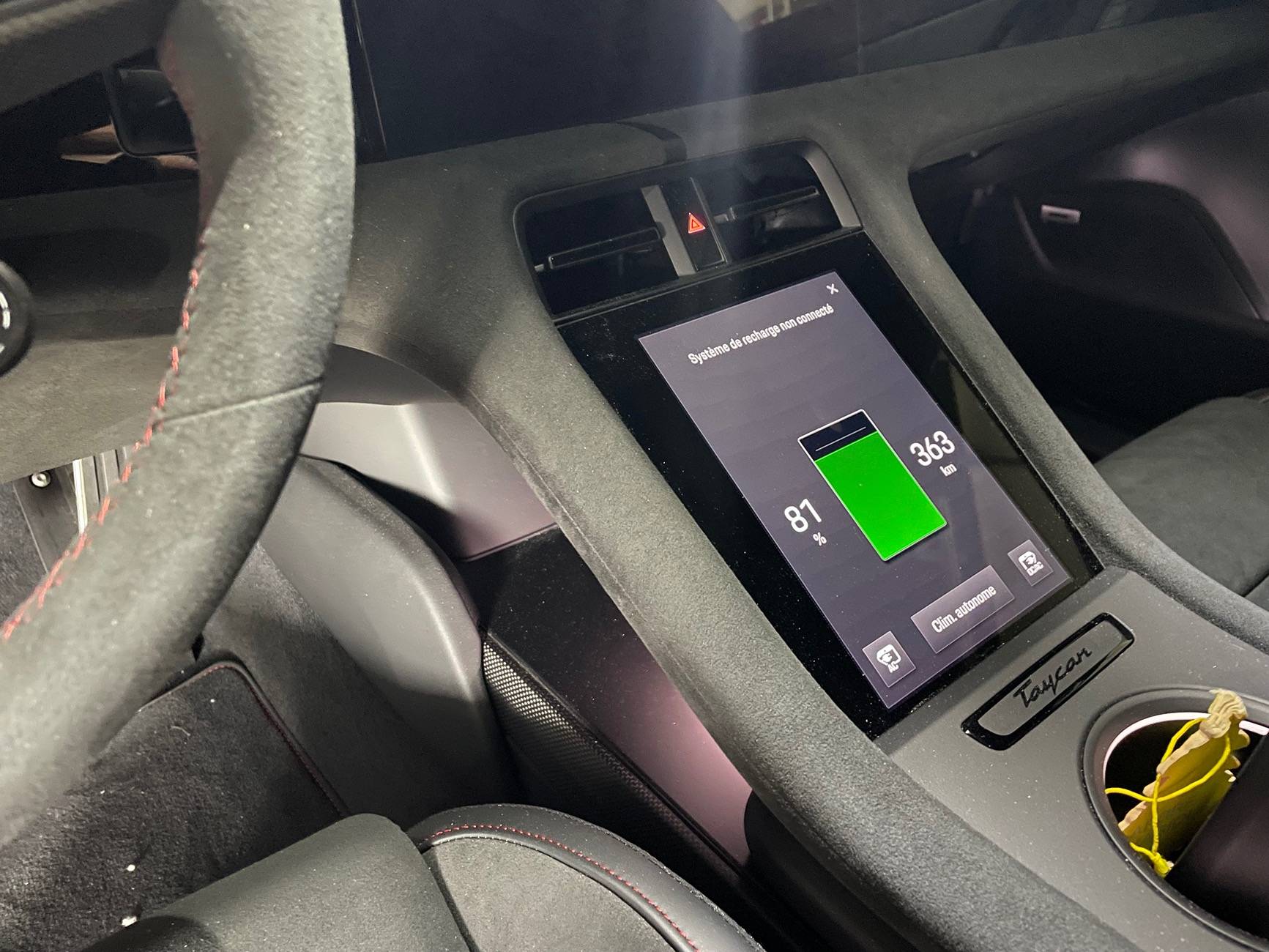

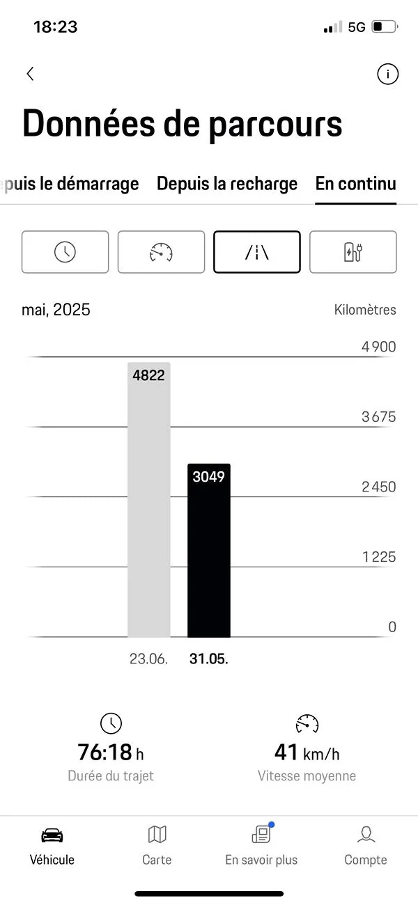

Off-the-record.. 363 with 81% battery on a GTS! That's like 448km on a full 100%. Can I ask you how you even achieve this? What's your average consumption?
I typically only achieve 350km on a full charge (Taycan GTS 2023)
Today 357 Kms with 78% : my best is 495 Kms with 100% but as i’ve done a big journey one month ago so it goes down to 410 Kms
I also have a 2018 BMW c evolution wich started with a 100 Kms range. Now after 8 years I manage to increase it to 127 kms
Cool driving and friendly charging
First year :22,5 kwh
This year : 20,3 kwh
Local driving : 18 kwh/100 kms for 20 to 30 kms each time
