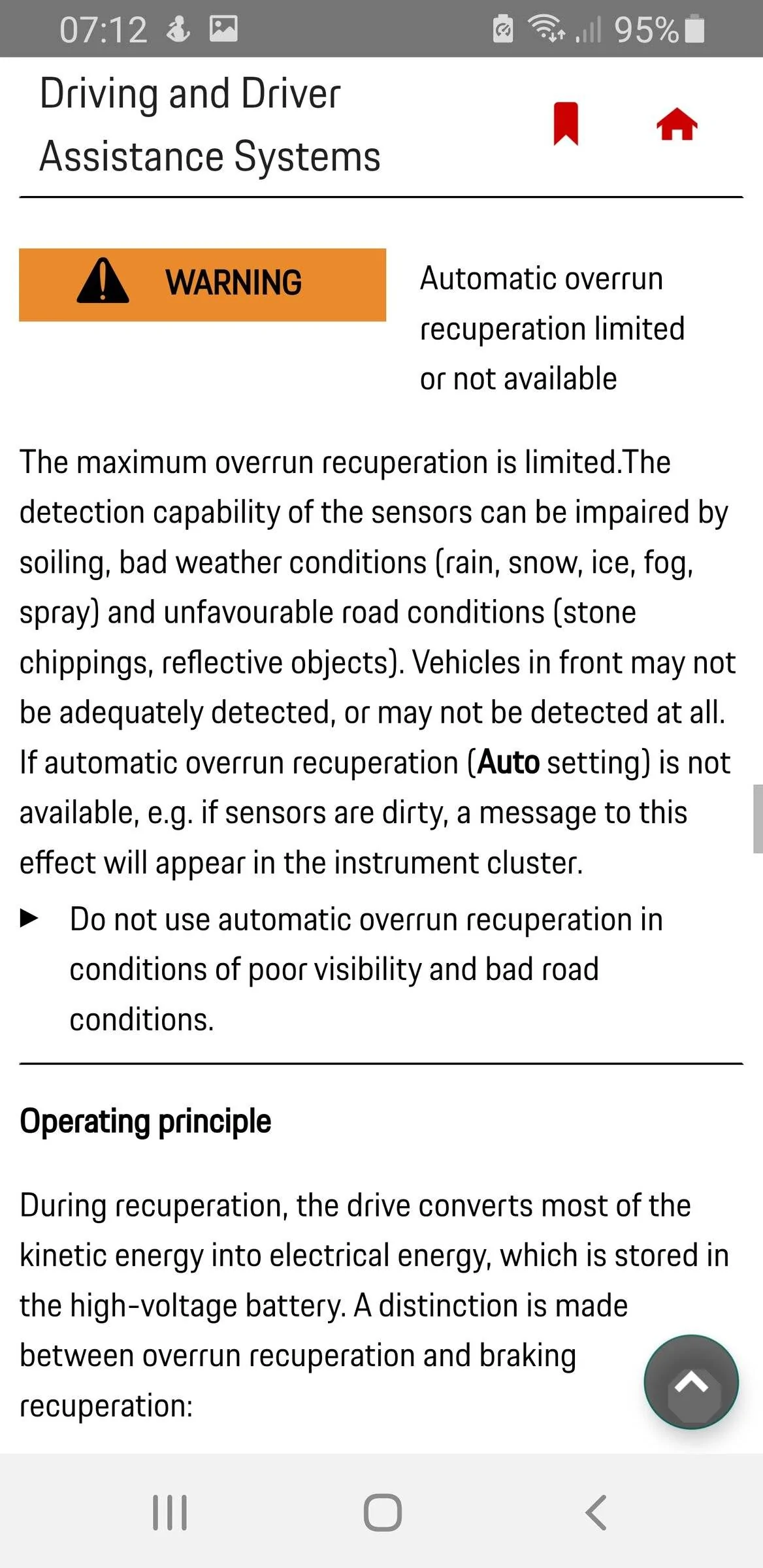

This is fairly normal in my experience but cause is not always clear.
Note that if PSM Sport (not Drive Mode) is enabled then auto regen is never available.
General availability issues are typically dependent on reflection's, dirty sensors, weather etc
Porsche Taycan Auto-Regen Not Available Screenshot_20220416-071230_Porsche Good to kno

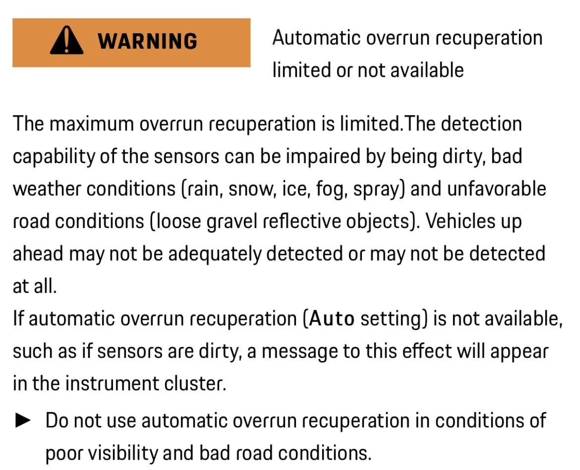

A lot
It hasn't to do with the sensors cuz otherwise you would get the warning "WBA limited/not available" (Warning and Brake Assist).
It uses the same sensors for ACC, emergency braking and auto high/low beam.
So it must be software related.
There's no reason why auto regen would disengage after a certain period.
I would suggest you'll try to reproduce the error and see if there's consistency in the error.
Only then your dealer has a better chance to find the issue.
Porsche Taycan Auto-Regen Not Available Screenshot_20220416-083412
