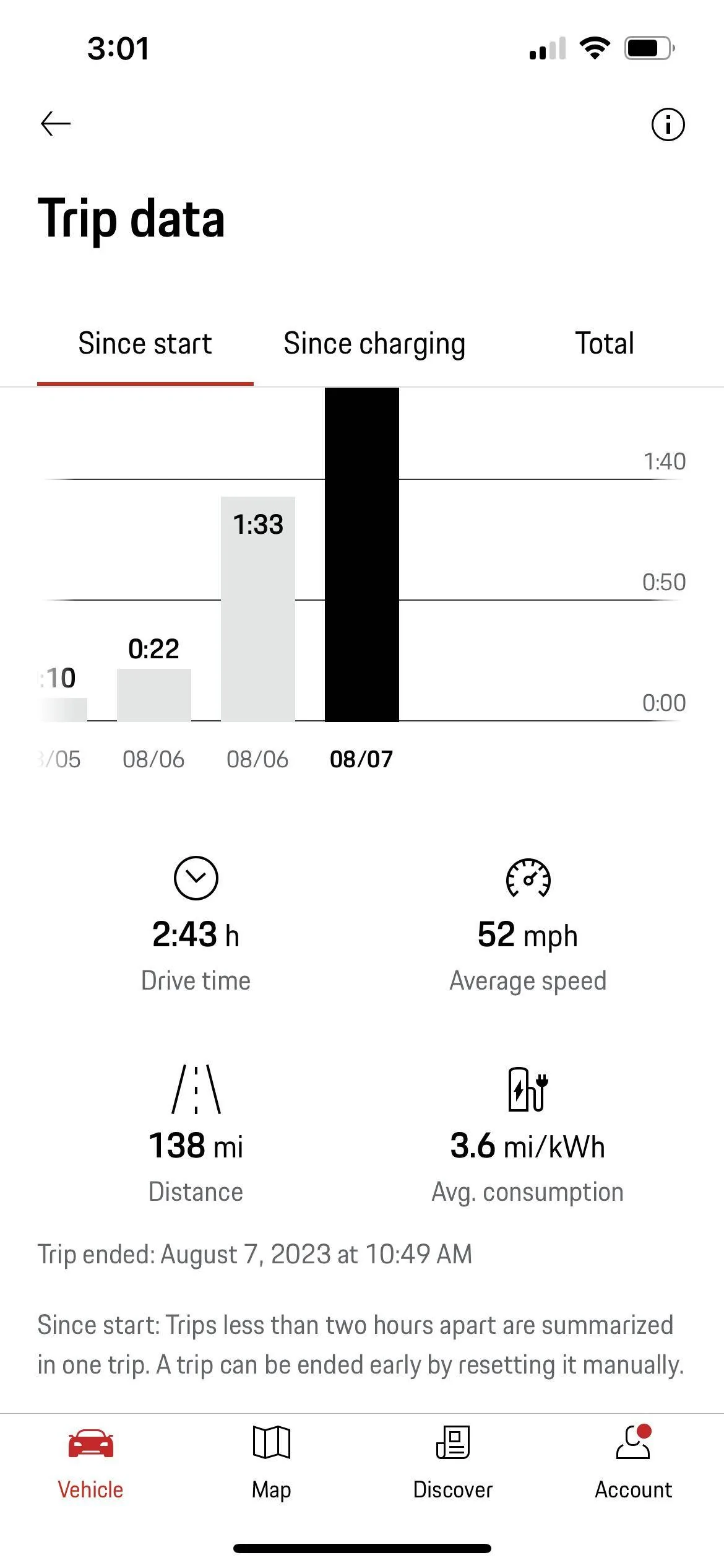

22 RWD with PB+, 20 inch tires, and 13K miles on it. Drove back and forth from home to San Fran airport today and this is my trip data.
Porsche Taycan Base Taycan range: less? more? or average? IMG_6330

As @Archimedes already said, it depends on driving style and speed.
During city driving I get 408km at 100%
Put me on a family trip with lots of highways and it's 370km at 100% in best case scenario. Start moving lots above 130km/h and range is going to suffer.
I heard people managing 550km in city driving. How? No idea. Certainly not with my driving style. I'm generally not a speeder but I refuse to drive a Porsche like a Toyota on its last breath. Car is meant to be fun. Who cares for more or less 50km range.
