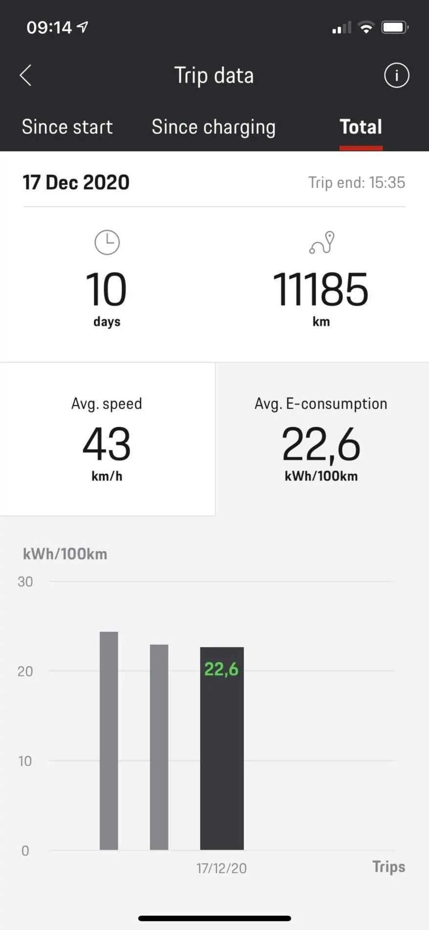

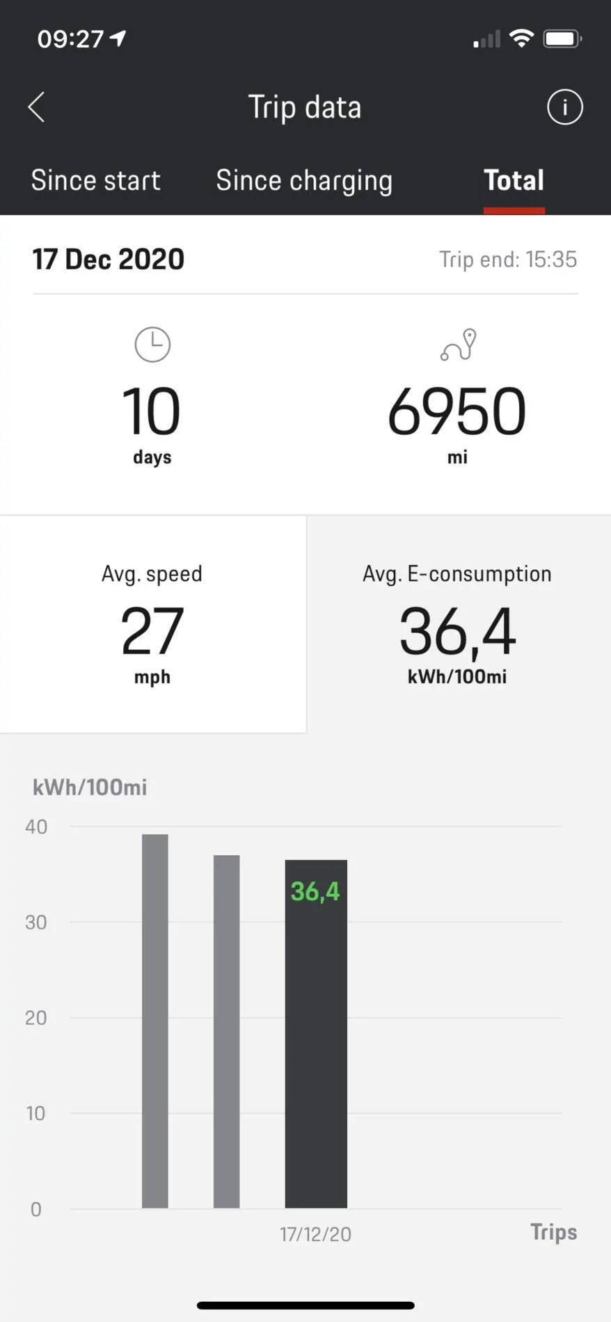

Mine has 11185 km. or 6950 miles since it was delivered on July 1. The shown consumption is 22,6 kwh/100 km or 36,4 kwh/100 miles (or 2.7 miles per kwh) which is probably quite low for a turbo S with Mission E wheels. Mild weather, light right-foot in normal mode most of the time may help explain it.

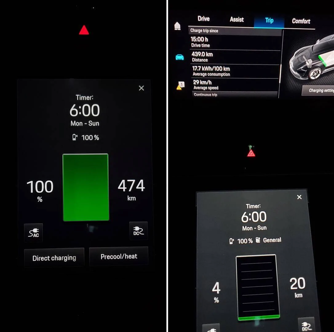

Temp around 19°C charged to 100% driven 439km mostly city and city highways.
To be fair, this is with really using coasting driving style.
