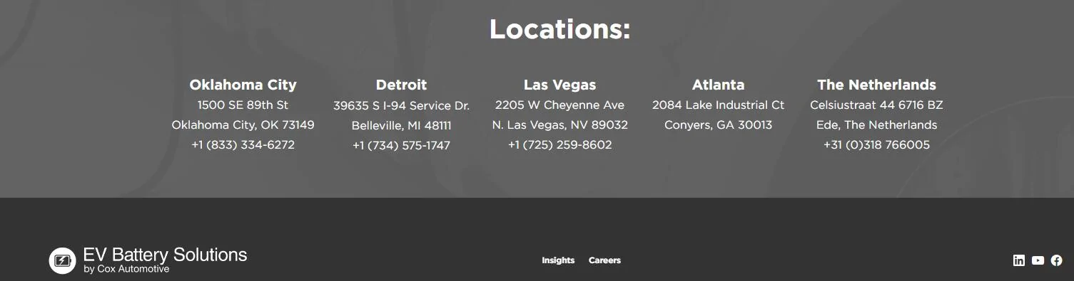

Update: I checked with my dealer today since it's been almost 3 weeks since I took the car in and the original estimate for work complete on the battery module replacement was one month. I was informed that the battery was shipped early last week to Oklahoma City and the turnaround there is expected to be 4-5 weeks. That means that if everything goes perfectly (when was the last time that happened?) my Taycan will have been gone at least 2 months by the time I get it back. :(
763
4,566
3,714
Re Oklahoma City:
Porsche Taycan Battery Module Replacement Begins 1718996772590-x
2 months out of service is longer than the 2-day repair described in the recall letter to owners.
