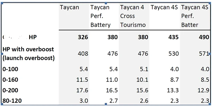

what is battery plus on a rear wheel drive taycan do i need it i am only going to be driving the car on the weekends as my toy. is there any point with the horsepower that comes with it because it will still hit 0 to 60 in 5.1 sec. as will the 79 battery?

PB+ extends the available range and potentially capable of charging slightly quicker on ultra fast DC EVSEs.

0-60 may be the same, but other performance stats vary (pic below).
Extra range with bigger battery, but also more weight.
Depends on individual circumstances.
Also have a look at this post from @Avantgarde on the subject.

For me, the inevitable battery degradation that comes with use/ageing, would be reason alone to go for the largest battery. This would be even more important in colder climates, as consumption takes a hit during winter time.
Probably also easier to sell the car later, if it has the larger battery.
