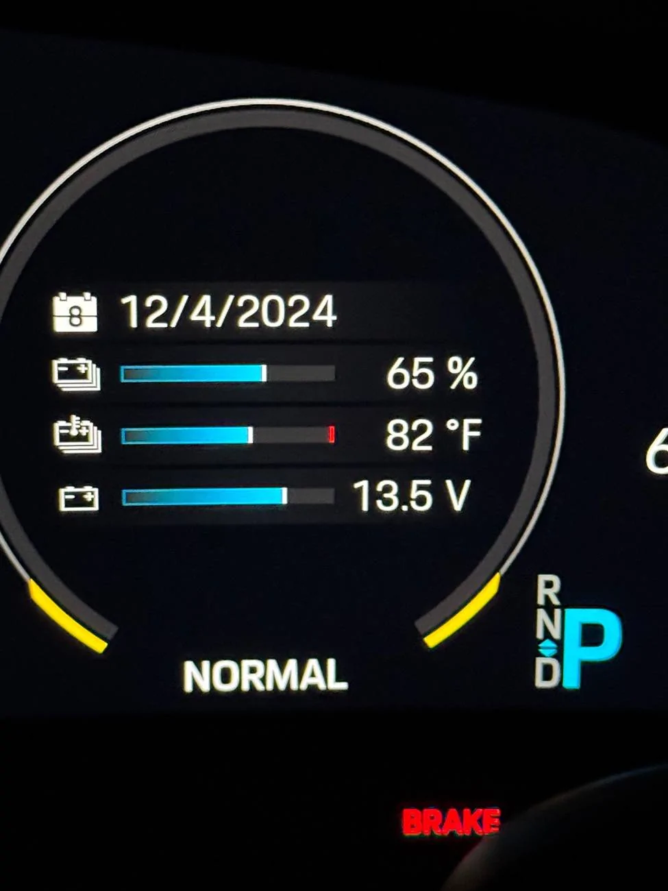

Battery temp indicator on my cluster went up to 82F with red line next to it.
Is it safe to drive? What is the ideal temp? Weather is moderate, I’m in CA.

The temperature is normal as indicated by the value and the blue bar that is in the middle or so. The red line is always there as a maximum temperature limit. You are good!
You can see temperature going as high as 110F for example when the car preheats the battery for optimal charging speed, which is again normal and expected.
+ I checked Porsche printed Taycan brochure and it says for optimal charging the battery temperature needs to be between 86F and 95F that the car manages, but I know I have seen it go higher than that when the preheat is activated by setting a charger as destination.

1. You're reading it wrong. Your temperature level is the blue line. It's in the middle.
2. that is not a warning. Warnings are very visible and obvious, and have sound feedback also.
3. Maximum temperature is 120F; so 40 more degrees in your case. At 120, your car will not catch fire, but the battery will be throttled and deliver less power, in an attempt to cool down.
4. Temperatures between 80 and 90 F, after 2-3 hours of driving, are the normal range of temperature. If you navigate to a charging destination, the battery will get much hotter.
Maximum temeprature I have seen my car reach was 64 celsius - so about 150F, while navigating to a charger in 43 degrees outside in italy.
