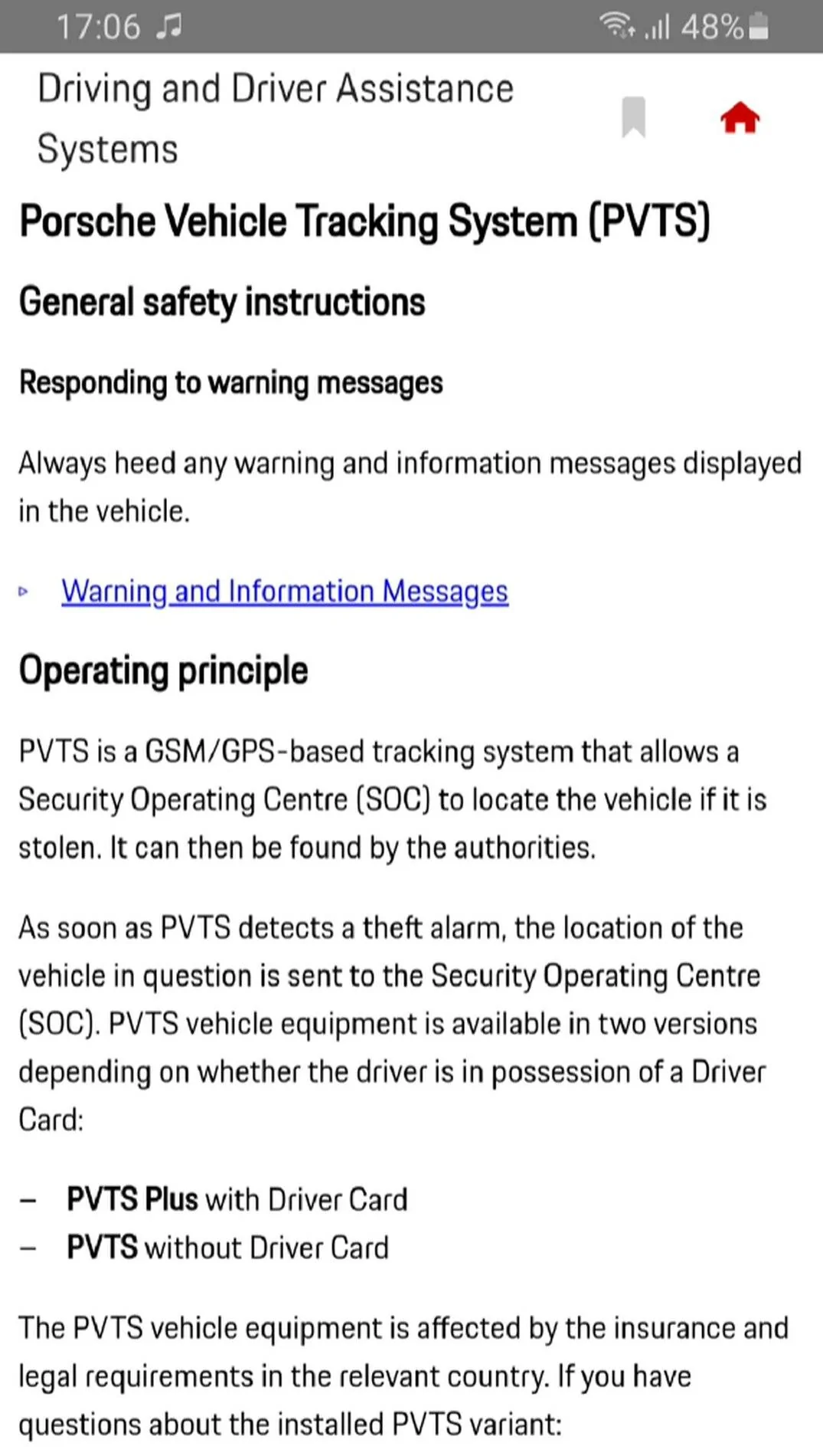

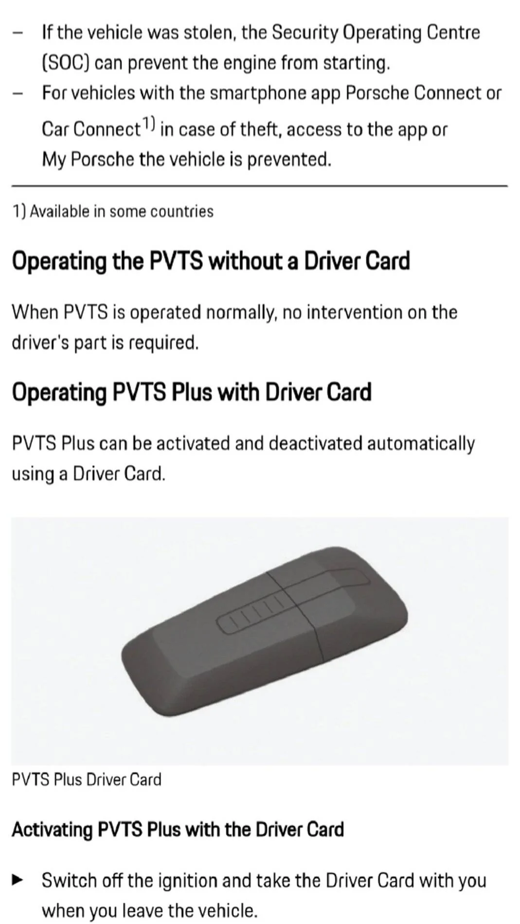

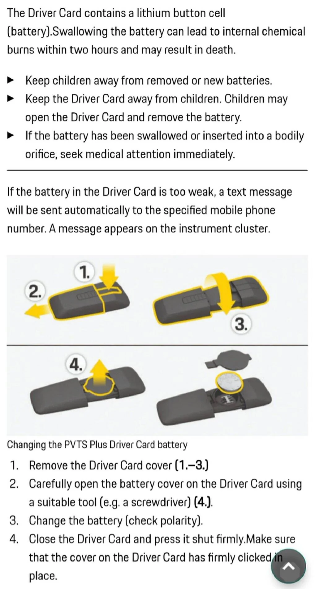

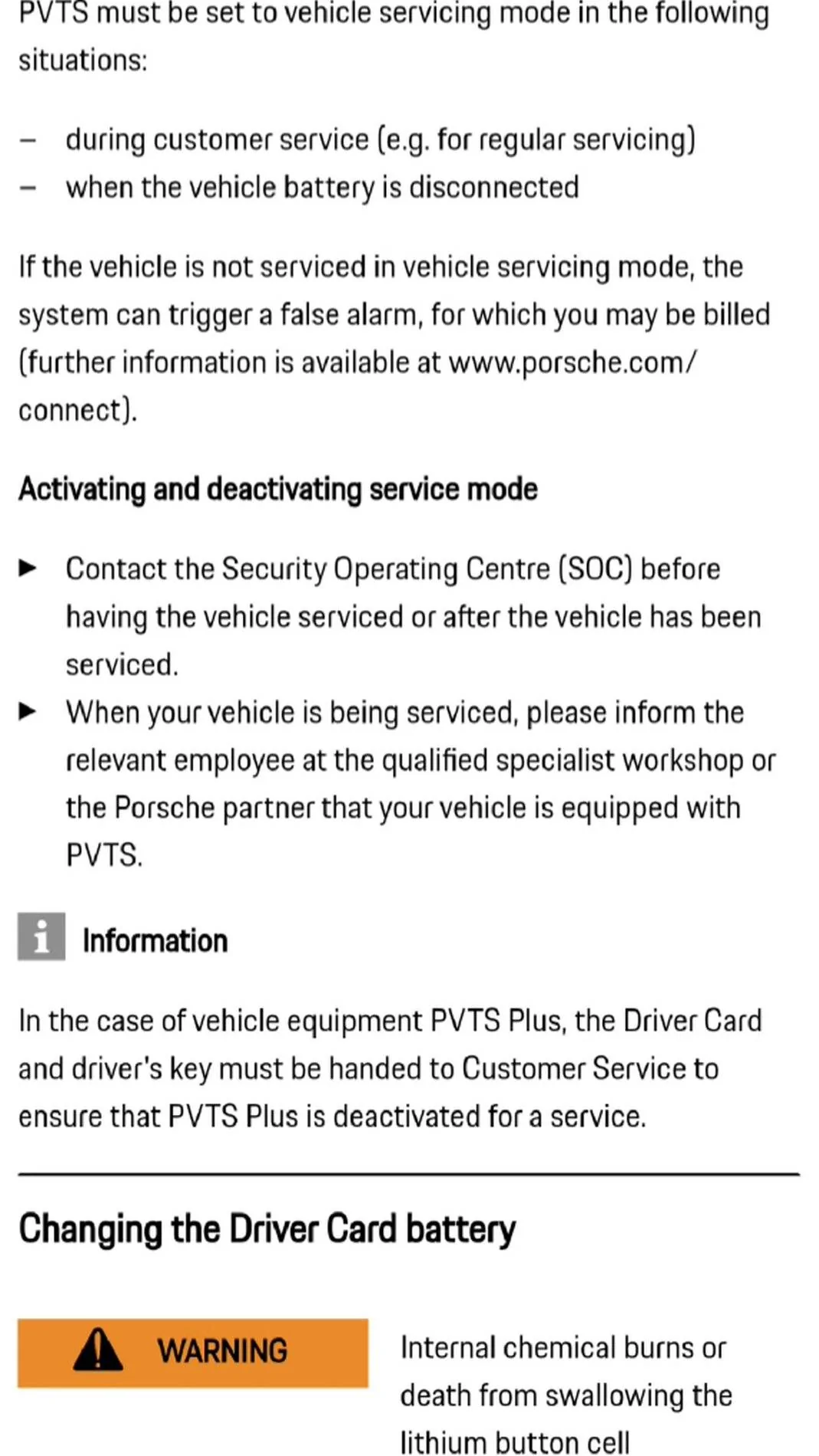

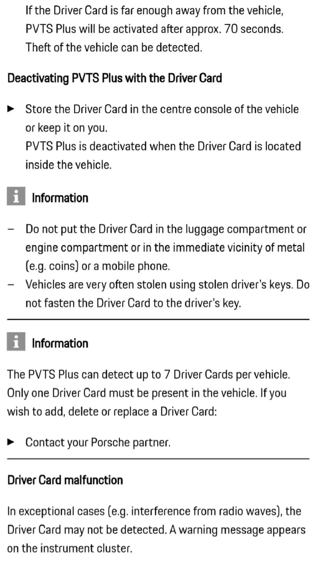

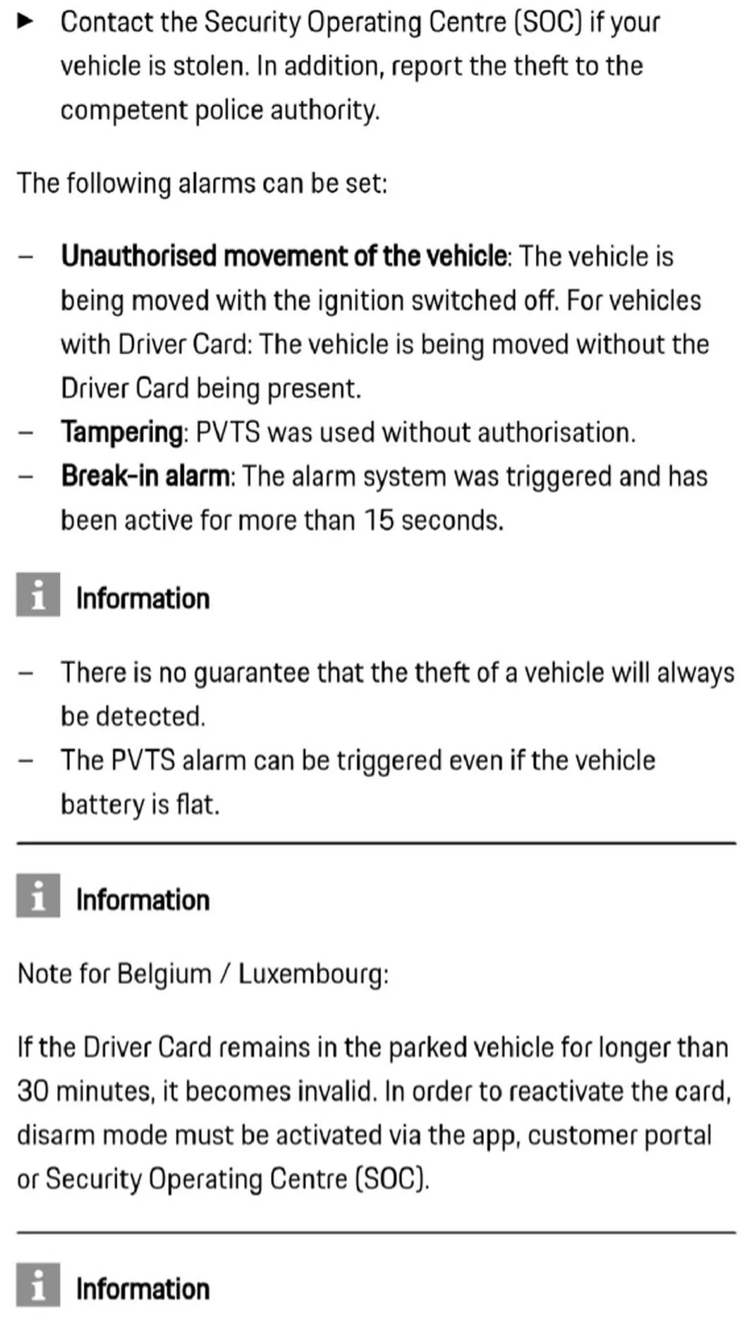

Do you mean these?
Porsche Taycan black "keys"? Screenshot_20200718-170751_Porsche Good to know

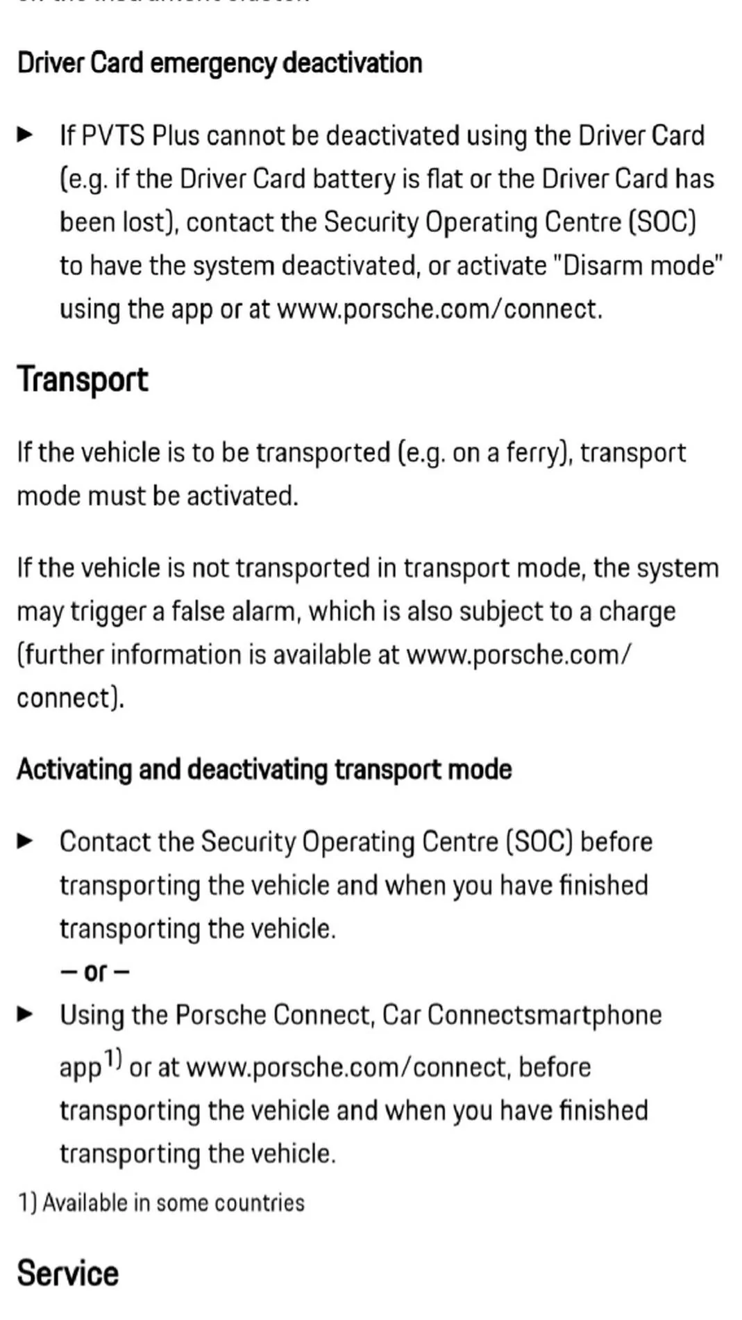

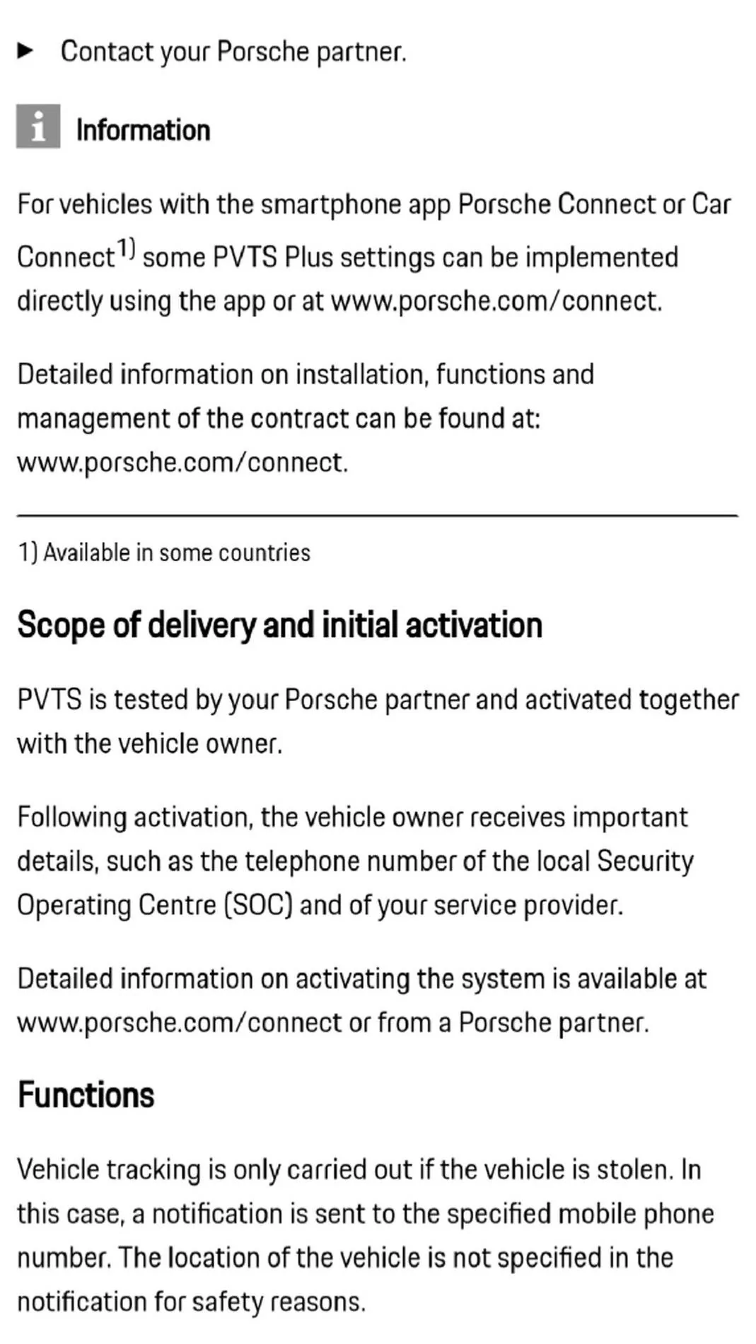

If you get these it means that you have ordered the PVTS plus. To figure out how these works I've attached a Printscreen from the good to know app.

If you have activated PVTS+ then they need to not be in the car and not to be kept on a keyring with your keys. You need one of them them with you on all journeys, but not in the car if you are not using it.

Once activated never leave one in the car when not using the car (it will disable remote monitoring of alarms) and always have one with you when using the car (the car will object otherwise and trigger a silent alarm).
