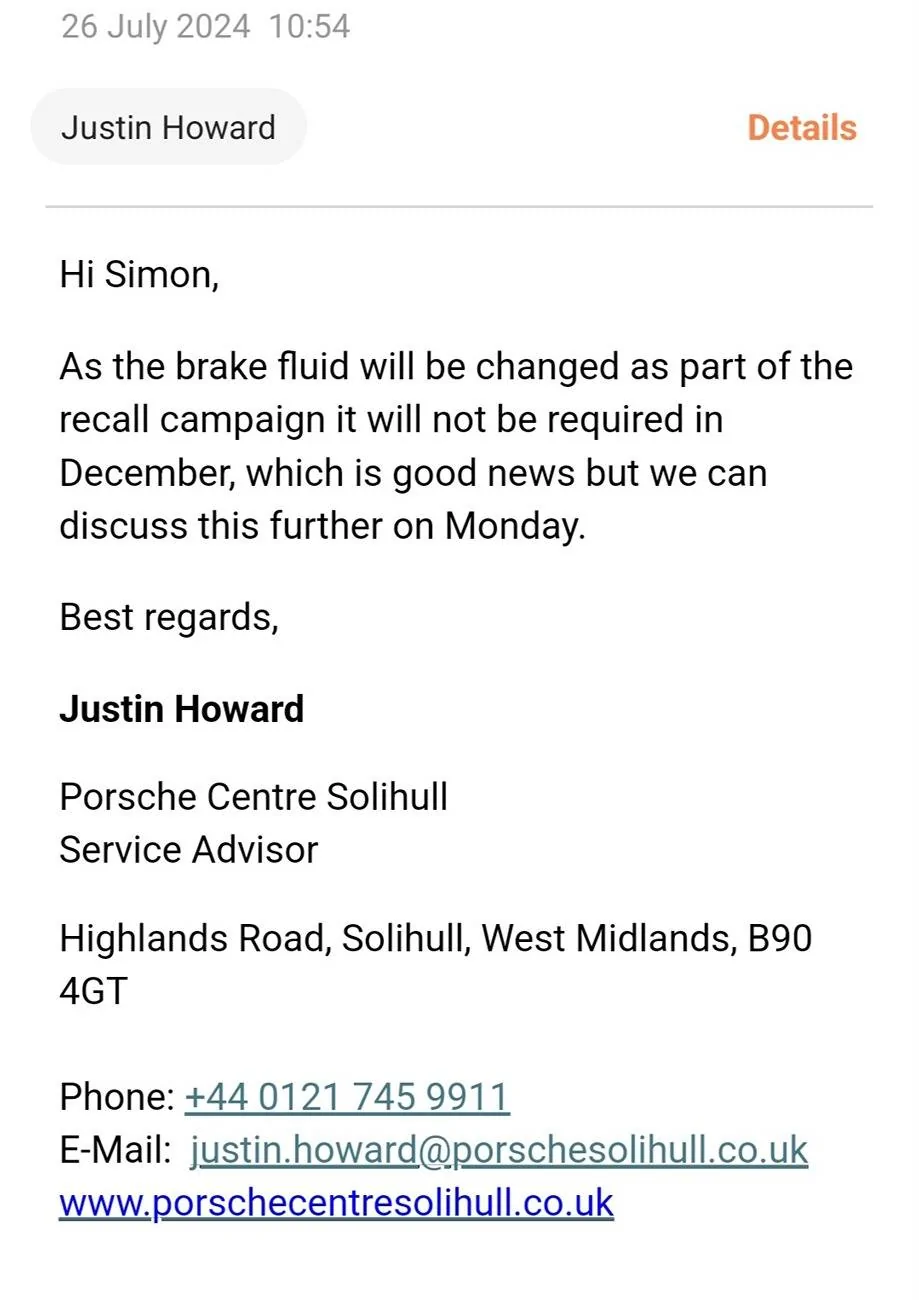

I recently turned down a brake fluid change at first service as the car is only 18 months old. Delighted to learn from my OPC yesterday that the ARB0 recall includes a full brake fluid change so I won't need to pay for one in December when the car is two years old ?

Emmm, my dealer said that despite the campaign, I’ll still need to pay for the brake fluid change (I have a service due) as only part of the fluid is lost. I think I’ll need to argue with them about that
See below
Porsche Taycan Brake Feel Improved After Flush Screenshot_20240727_164739_Email
By coincidence the campaign fix was done at the same time as my 2 year service. I was initially charged for the brake fluid change but the service agent called (without being prompted) a couple of days later to arrange a credit as the work was covered under the warranty fix. For once a thumbs up for Porsche customer service.
