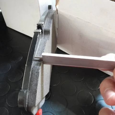

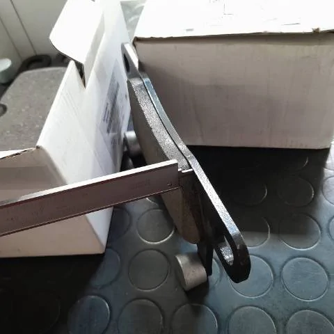

Just received these infos next to photos from my local Porsche Service Adviser:
- Front pads when new: 9mm. - So yours are like a new ones.
Porsche Taycan Brake pad wear 61308A04-5CC7-46F2-8CEB-041BFA4D97F4
- Rear pads when new: 8mm - So yours are almost like a new ones if taking 0,5-1mm measuring tolerance.
Porsche Taycan Brake pad wear 83E0EA9C-B6F0-4173-9846-E3A6CC5BC74B
Percentages on the list are absolutely wrong. Front ca. 0% worn, Rear ca. 12% worn.
