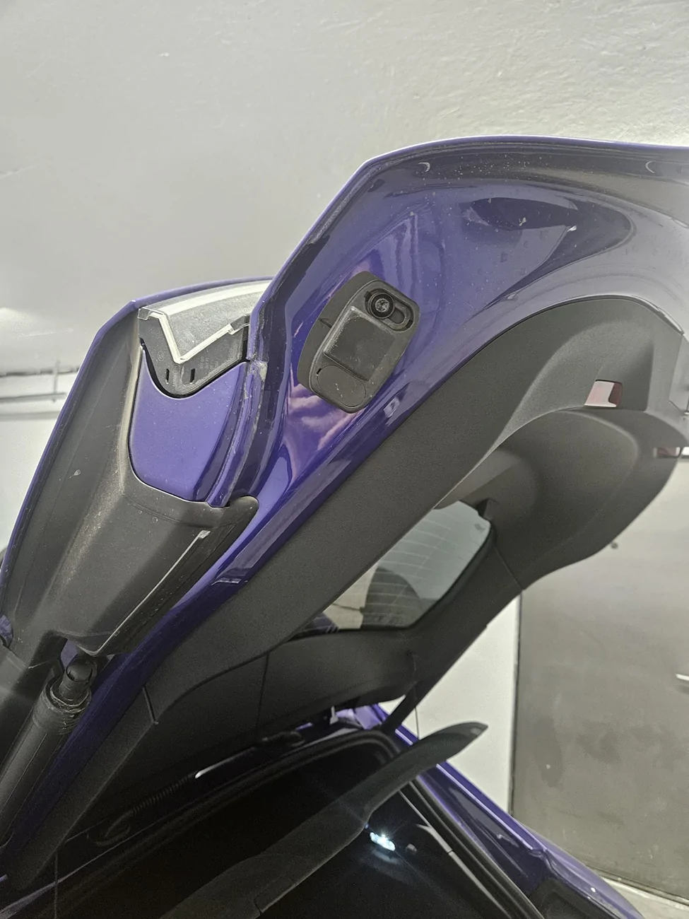

Sounds to me like rear hatch is loose, but ofc hard to tell from the video.
To adjust the rear hatch you have two catches - one on each side.
Each catch has two covers that come out very easily by pushing with a small screwdriver towards the center.
Here, I popped one out on my car real quick:
Porsche Taycan How can a car with 10k miles be creaking like this?! 1773247887691-da
If you move it in the direction of the arrow in the middle, it causes the tailgate to be held stronger against the car's body.
